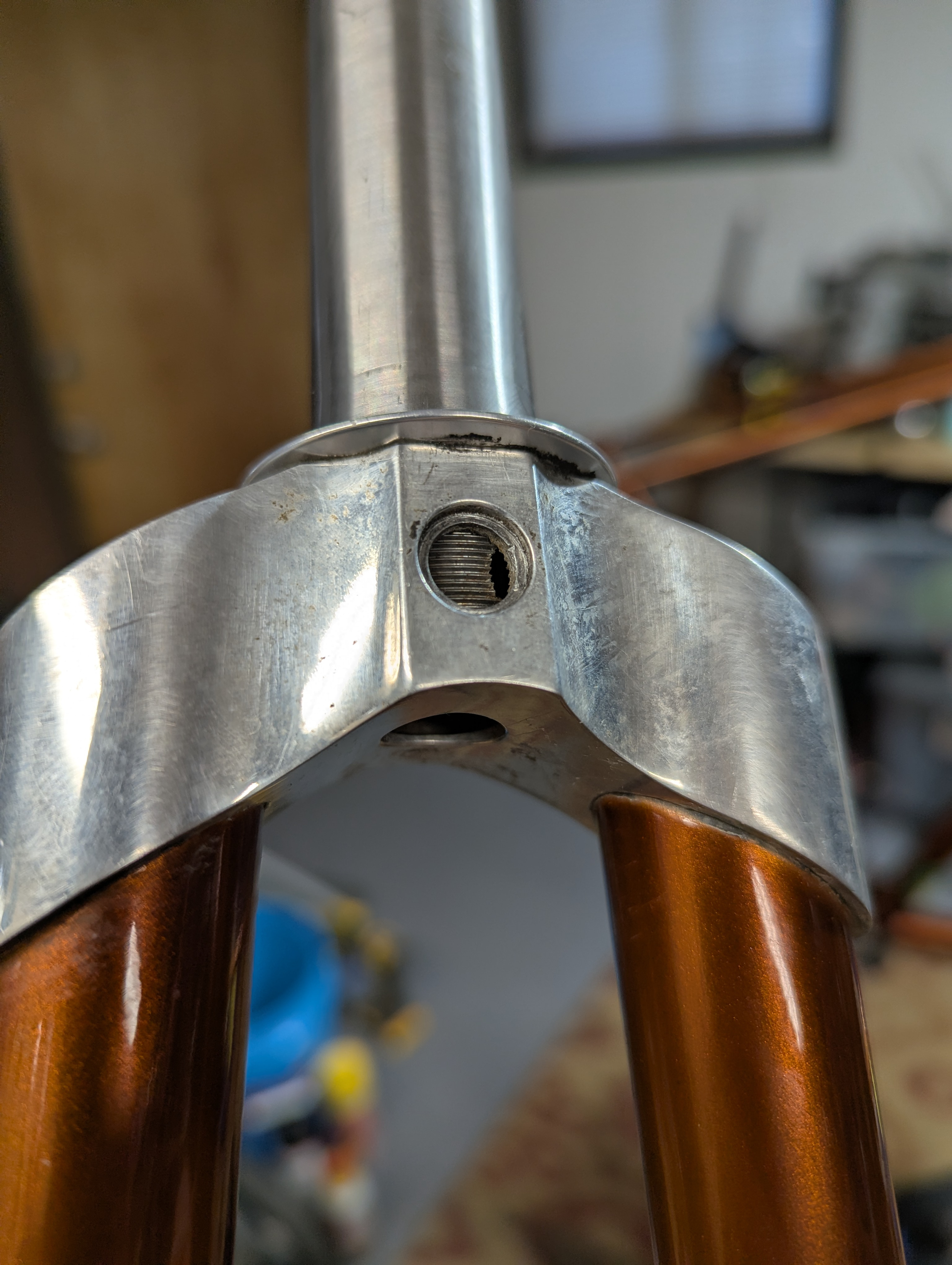

what is wrong with this wound up fork? can’t put a brake in there, it’s like the steer tube is askew?
steerer tube needs to rotate so hole aligns with hole
When the brake bolt becomes structural.
lol yeah. managed to do that
how the heck did it get like that though, like should I even be riding this fork? it’s secondhand
I mean I don’t love it either, but I kinda doubt it’s going anywhere if you build it up and put a brake on there

Did you post this fork earlier? Or someone else posted the same type with the steerer removed?
wasn’t me!
I’m pretty sure the steerer threads into th crown.
yeah I was having a tough time discerning if it was the steerer or another piece that I was seeing. but I think you’re right, it was the steerer. interesting way to design a fork
