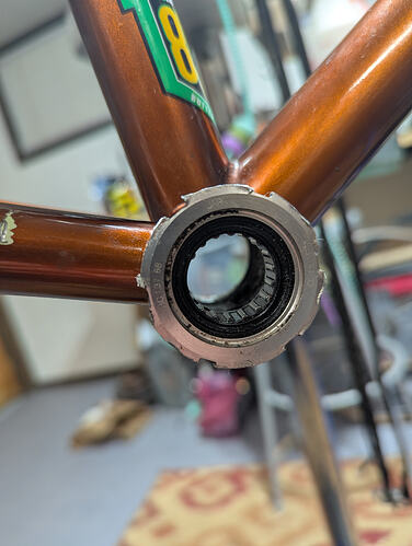

next issue with this Croll frame is the dang ol seized BB. I’ve tried PB blaster and a heat gun but it hasn’t budged. Any ideas before I carefully try to cut it out from the inside?
Dremel cutoff wheel through that lock ring
What is the removal tool? Have you tried hitting it steel on steel? Sometimes the shock will provide more peak breaking torque.

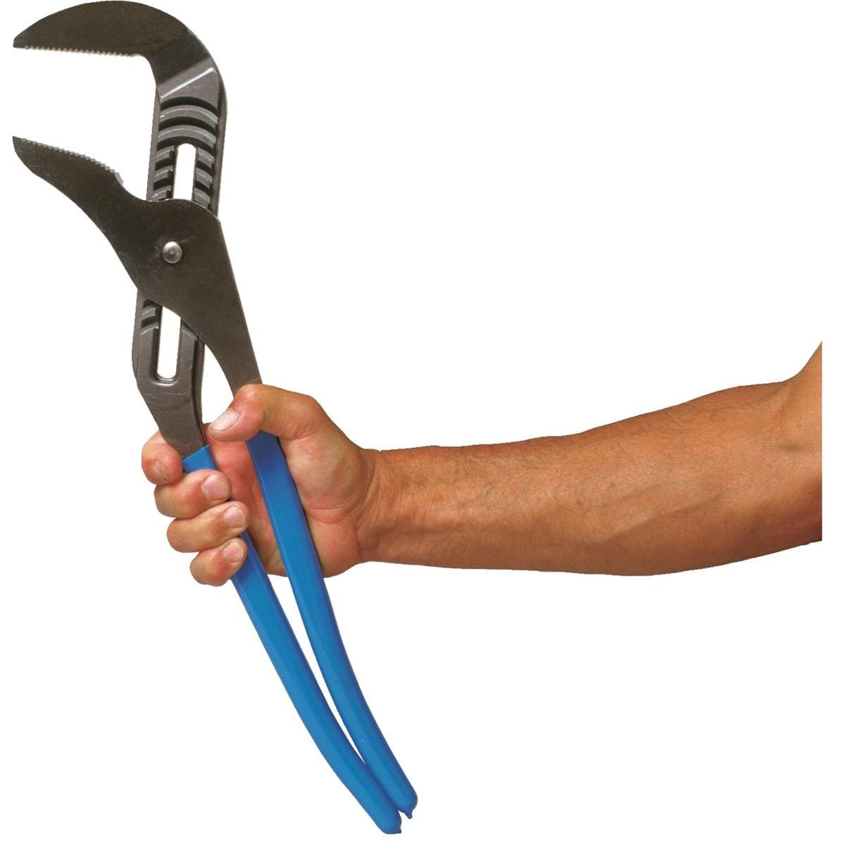

I hate cutting things like this and would go out of my way to try more leverage first. Potential pipe wrench rental anywhere close by? Locally I could get a 36" wrench for like $12 for the day, would whip this pretty quick.
I’ve mentioned these before, I’ve used them on all manner of stuck and seized things and they’ve never failed me yet. Not practical at ~$70/per, but along the same lines if you can find/borrow/etc.

Pipe wrench looks like it might help. I don’t really wanna skip to dremel. The bottom bracket is a shimano bb-7700, the tool I’ve been using is a track lockring removal tool. I tried with a breaker bar but essentially just started marring the interface on the bb (as you can probably make out in that photo). not near Atlanta unfortunately. What kind of place rents a pipe wrench? I guess I’ll check the tool library
I got the NDS off so I do have access to that side.
Tried a vise but no luck

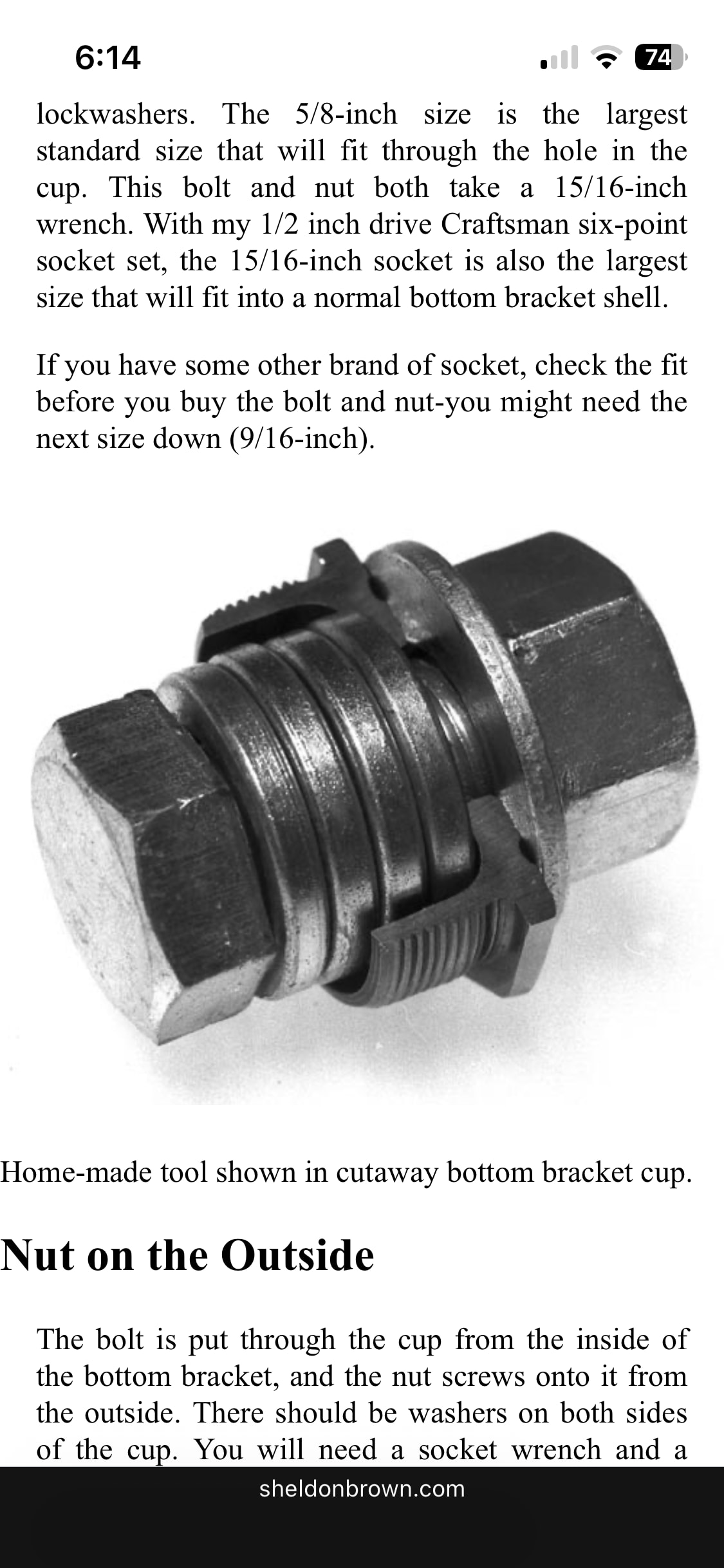

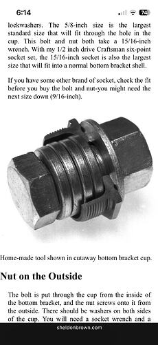

I did something like this with success (From Sheldon)
I also poured some mix of motor oil and gasoline I think down the seat tube and let that sit for a couple days. I might have used a propane torch as well on the bb shell until that oil mixture started smoking and the cranked on that bolt setup with a cheater bar and it worked. Really felt rewarding

the sheldon nut thing worked for me on an old mountain bike that had been left outside all winter

I had thought this was something every Home Depot had but I guess hand tools are a limited option depending on the store. Northern Tool, United Rentals, etc would be the next option.
pipe wrench worked!
