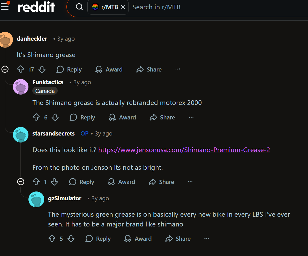

Is the Park grease less costly than the Shimano grease? That’s all I’ve ever used.
The Park stuff is rebranded marine grade grease, but in a smaller quantity.
Shimano has like 5 types of grease at least, so it’s a little generalized to say “shimano grease” is the motorex stuff.
the motorex stuff does look to be the same as the general shimano grease they glob on things like crankset splines. just like a slight neon yellow/green hue to it. there’s always a lot of that on new bikes assembled with shimano parts. but which shimano grease is this?
there’s special grease (for freehub bodies), premium grease (doesn’t say what it’s for, just says it’s for dura-ace level components), dura-ace grease (is this the same as premium grease?), roller hub grease, shift cable grease (also says special grease but in a black tub), IGH grease which is the same as the derailleur clutch grease.
Internet is 99% sure that Shimano is rebranded Motorex, which itself may be rebranded
Park polylube is proprietary blend

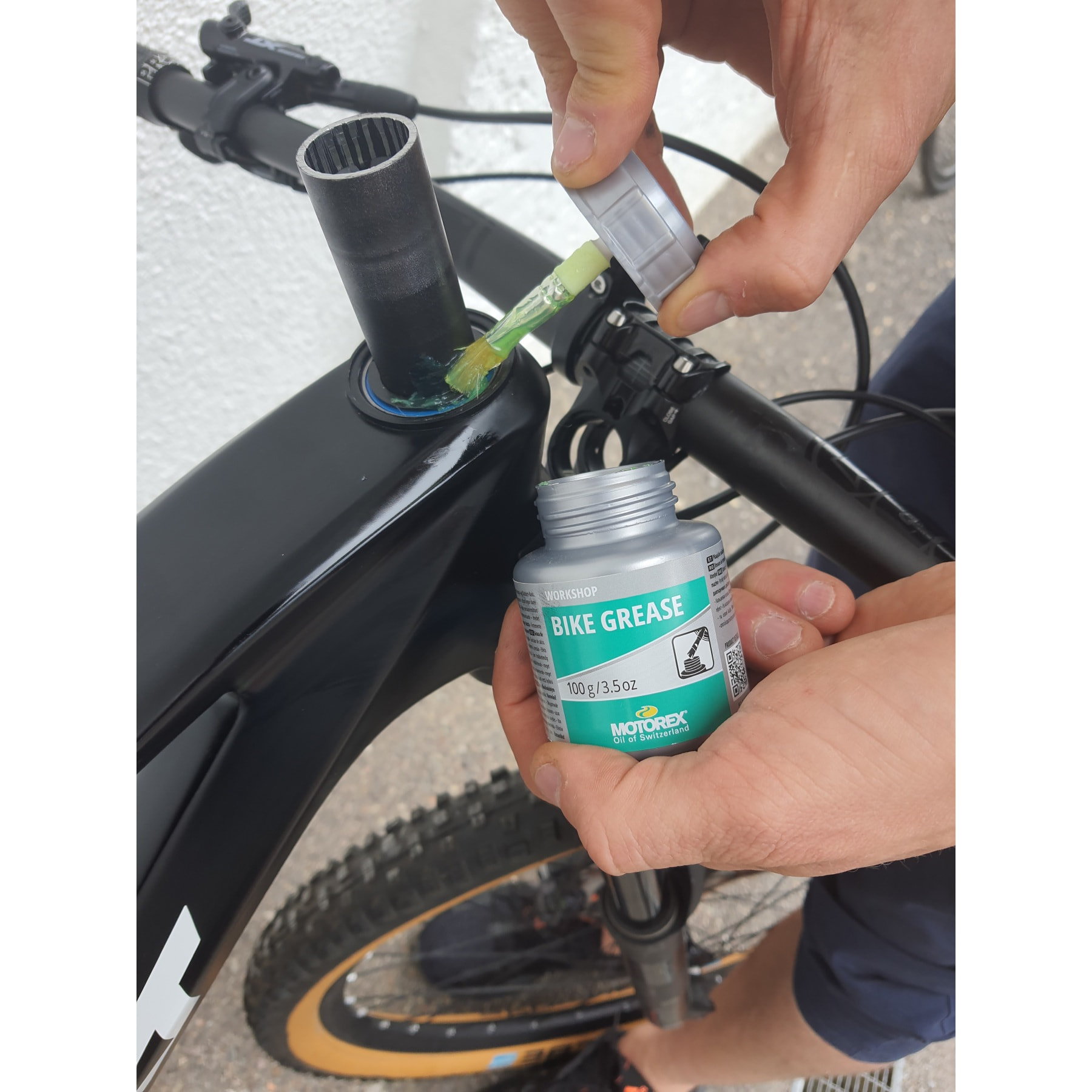

bike24 sells motorex bike grease

Shimano USA now distributes Motorex, and the rep said the Motorex grease is indeed the general-use Shimano grease. ¯_(ツ)_/¯
We’ve been using that for assembly grease for over a year now, and I like it.
