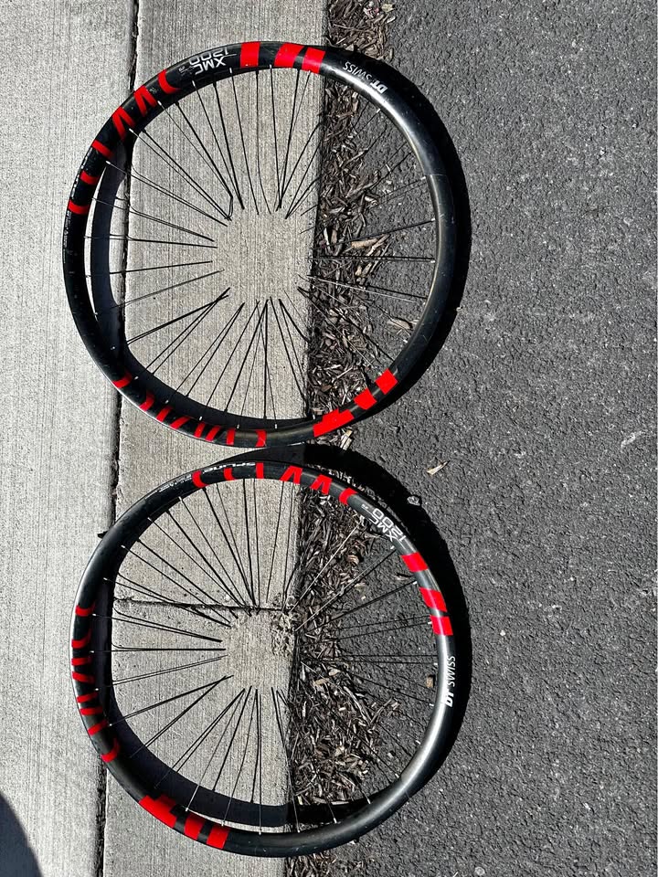

Local dude is selling some used but in good shape DT Swiss XMC 1200 rims. 700c, 24mm ID, hookless, carpet fiber. $80 for the pair.
I can’t find pics online, which makes me think they are older, but they’re in fine shape.
I am hesitating, I don’t have a burning need, but could be good project wheelset for my gravel/pukebacking bike, which I need a dyno wheelset for.
I’d say as long as you avoid goofy Panaracer-made tires, you’d be fine in a or b scenario.
you should have zero issues with MTB tires at MTB pressures (although imho 2.6" tires are on the wide side for those rims); hookless has been the norm for MTB stuff for a long time. Depending on what pressure you want to run, you should be fine with the gravel tires as well.
I’ve been running rene herse RTPs (26" x 53mm) at ~40psi on chinese hookless rims for several thousand miles and haven’t died yet.
