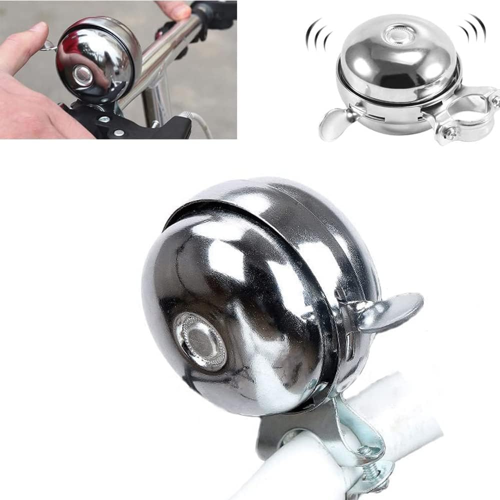

can anyone help me find a good quality rotary bike bell that goes bring-bring like a Crane bell that isn’t also $40 and not very durable like a Crane bell?
Burger bell
(Dimension brand?)
I believe the bell sound is “klingle”
ah yeah. we have burger bell on the tandem that’s 10+ years old
how about a Incredibell Clever Lever Double Dinger
that one goes ding-ding
I was gifted one like this and it is comically loud and obnoxious.
i have that one on a different bike. it’s like a doorbell. it’s absurdly huge though
Ash has a similar bell but with polka dots. It goes DING-DONG!!!
damn I want a DING DONG with polka dots
There is a genital warts joke in there somewhere.
