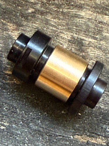

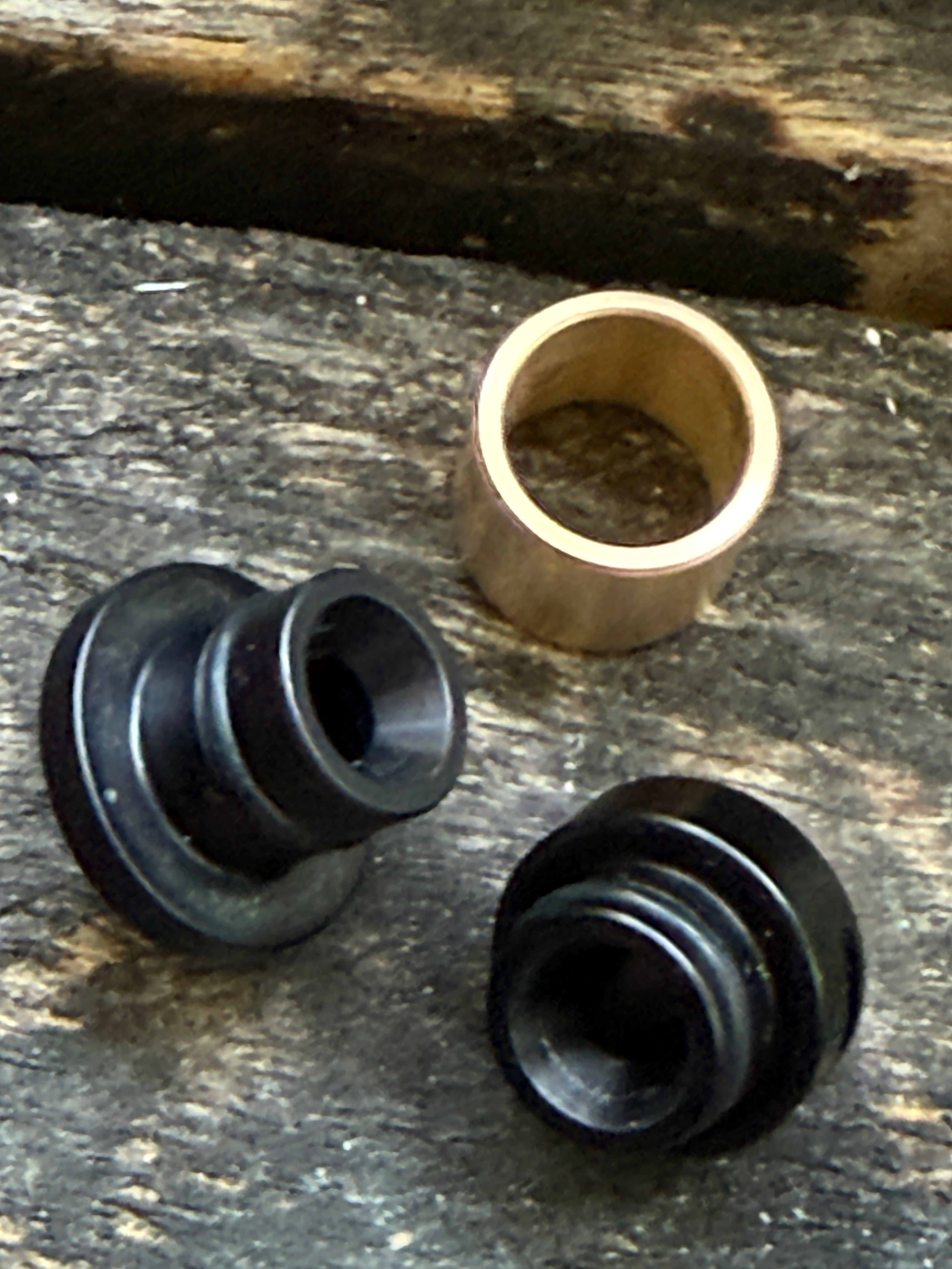

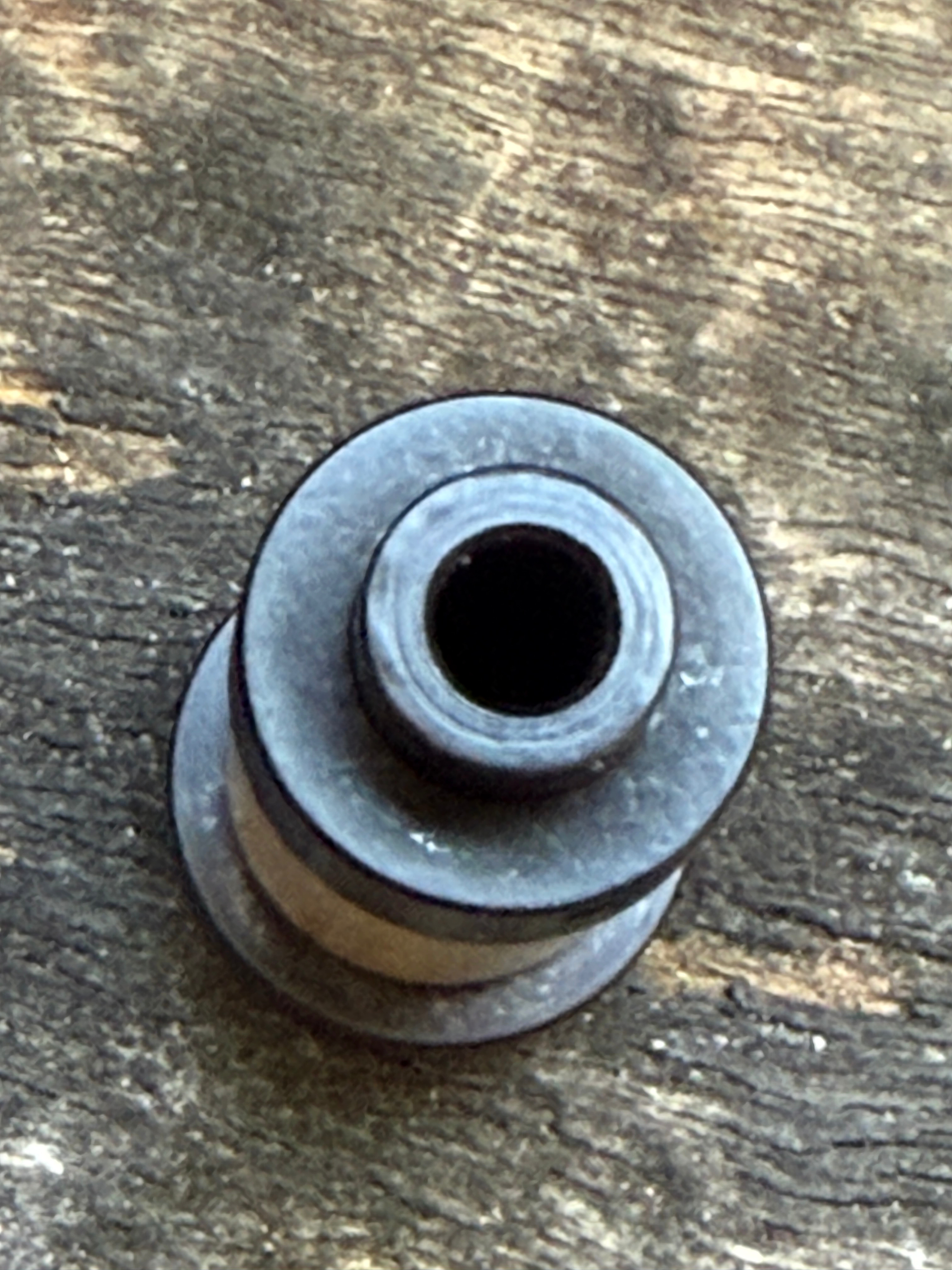

These are extra qr end caps for my grin hub
I want to drill and tap them for a solid axle.
I don’t have access to a drill press right now.
I bought bits in 1mm increments.
If I try to do it by hand will the existing hole keep the new hole straight?
I have three tests before the one that actually matters so I’m probably just gonna try it.
Worse case I ruin them and I blew $10+$20 shipping.
Did it work? You could tap them first with whatever tap will fit, leaving less material for a drill bit to remove and which should help the drill stay straight.
A metric step drill bit with longer sections might be useful too.

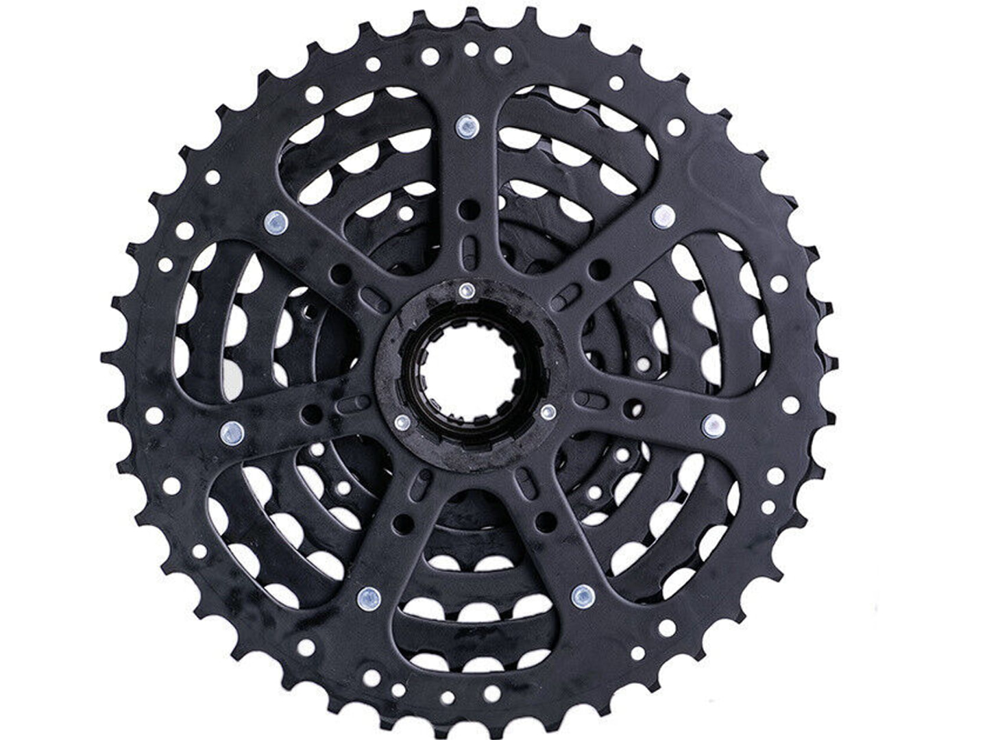

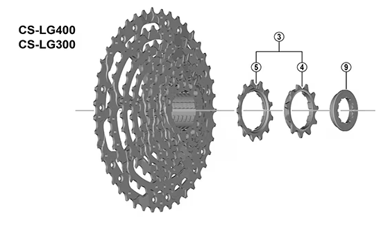

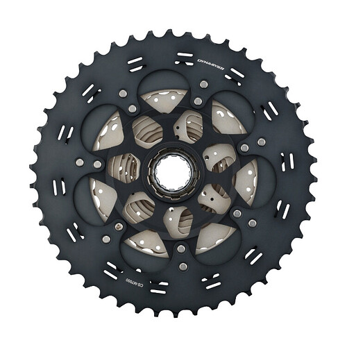

Are the cogs of CUES cassettes loose full cogs riveted together? I could drill out the rivets and take the whole cassette apart? That’s that it looks like but I can’t quite tell, anyone have one to confirm?
I want to use the 39 on another cassette and then experiment with individual cogs for other stuff.
Alternative is some of the cogs are partial and attached to a common carrier:
