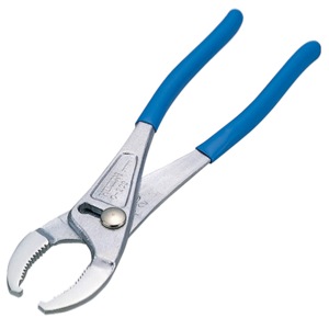

These days my Hozan lockring pliers get used more often to take the grate out of the shower than they are used to remove a BB or sprocket lockring, but if I have to, they are a joy to use and far less likely to result in bloody knuckles. The last time I bike-used them was probably to loosen/tighten S&S couplers, possibly more niche than loose ball BBs.

good lockring pliers are nice to have, but if you’re going to bin the BB and fit a cartridge you could always destructively remove the lockring with a pipewrench, and then the cups with the sheldon bolt on hack (scroll to fixed-cup tools)

I do enjoy this destructive removal idea too. I am not sure I have a pipe wrench big enough on hand but I should go see if my jumbo vise grips are big enough.

bloody knuckles option

Those all look good but now that I know I have a pair of vise grips that will fit, RIP to that lockring
