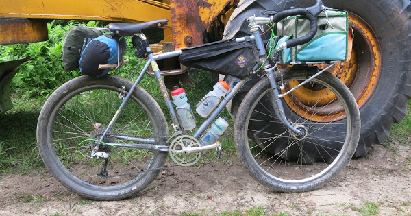

Whats a good replacement for this bike?
Google Photos
I want discs + thru-axles + sweetly compliant ride feels. And some provisions for touring.
Alternatively, I’m considering modding this Radlawn with disc tabs. Cost of decent wheels + TRP Hylexs doesn’t seem that stupid. Figuring ~$200 for local f-builder to braze things.

There is nothing in production currently that fits your criteria. If you want to keep the flexy frame you’ll either need a custom or get disc mounts on the radlawn. Your best bet would have been the radlawn xsogn that walmart was blowing out for like $700, but even those had stiffness akin to the ditherer, not the rsogn. You’re not going to find a flexy low trail frame with thru axles.
Crust Lightning Bolt? Not sure how butts or tire clearance compare to the nerdwagon.
Both worse than the rsogn. Wasn’t there a Seattle Instagram guy who got disc mounts on one of those? I might ask him how it has gone for him, because I would be leaning toward keeping the radlawn
Have your framebuilder lop off the current dropouts and replace them with t-a ones? On the rear end of the machine two birds could be killed with one stone by using one of the lovely (and expensive) Paragon disc mount dropouts,
They aren’t that expensive. You are already getting into a lot of bullshit so might as well get the good stuff.
