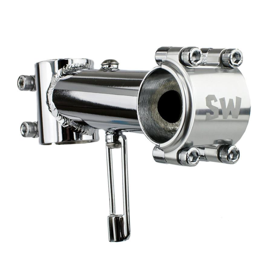

Has anyoone ever #bicyclesecretsed an ultra long drop front canti hanger? I’m converting my nordavinden to centerpulls to try to squeeze in an extra few mms of fender clearance. My stem is pretty slammed, no room for spacers above the hanger so even the problem solvers one is pretty tight. Cantis are beyond dead now so options seem limited. I thought maybe there’s a way to do it with a surly rear cable hanger + minoura mount or something.
dis looks good but $$$
V-brakes & a travel agent.
(failing that, what are you using for a front rack? You could always jury rig a cable stop to it if it was sturdy enough.)

Nitto Mark’s tombstone rack. Do you think that would actualy work? I’d be afraid of torquing the tombstone backwards.
p.s. it’s for centerpulls. No canti studs or the vs would already be v’ed.
I’ve seen it done before (on flickr? I wish I could remember.) But the 5/16ths brazes on those racks are pretty sturdy and if the straddle cable sits close to the tombstone the lateral forces would have to be pretty high to start bending the tombstone.
If you’ve got access to a torch, you could tack on a upside down u-shaped crown stay with a cable stop on it.
The difficult part is, that’s right where my boxy bag slides over, from top to bottom. Dangit constructering is hard
Send me the rack & I’ll tack a stay/cable stop on for you?
I like where this is going. But can you ms paint me a sketch of what you are thinking of? I’m too dumb to figure it out.

The fork side of the inverted U would have an eyelet to bolt to the crown, the other side would be brazed onto the rear rail between the legs of the tombstone.

Drill the stem like we used to back in the day?
What about one of those headset spacer cabal hangers?
Oh! Yes, that might work too (or one of those hangers that reached up from the fork crown) and it has the advantage of not having to either ship racks back and forth across international borders or having to do a couple of 1400s to deliver and return.
