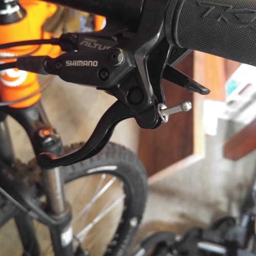

Hey I’ve been calling around with no avail. The C-clip and washer need to be replaced in the brake lever. In general do those replacement parts exist, or am I going to make life better by replacing the whole lever…?
Thx
A whole new brake lever/hose/caliper is stupid cheap and pre-bled.
