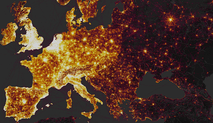

I would like to see some heatmap data to find some new places to ride. Is Strava not-free version the best way to do this?
They paywalled the heatmap? lame.
Strava heatmap is free / freemium.
Personal heatmap is paid (and really fun fwiw)
WAT
I assumed the many peoples heatmaps cost $.
