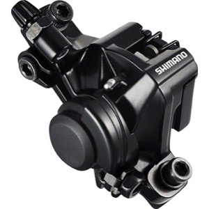

Are these Shimano mechanical disk brakes worth buying for the money? Folx seem to like the Hayes, but these are like $15 less per caliper than the long pull Hayes MX-5 calipers. Looking for options in case the wet brake upgrade to the Lorry doesn’t work out.
Just get the Hayes. I’ve seen several of those Shimano ones develop an issue where the pad adjustment screw backs out and you lose inboard pad contact. Plus they require 3 different tools to setup and adjust rather than 1.
Would the Hayes be compatible with the wide Shimano rotors? I already have those.
This model is saying “Pad adjust tool size unified to 5mm allen key“, maybe they’ve fixed that part.
That’s cool they fixed it. Still a clamshell caliper. The Hayes magic is in the one piece forged design.
