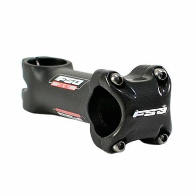

Replaced the fork on my fixie with an old surly, everything is an upgrade except the steer tube length, I’ve got about 30mm and all my stems are 40ish, what’s a 9/8ths threadless stem with a low stack height? Ideally 100-120ish long.

Some of the older FSA stems were 35mm:
