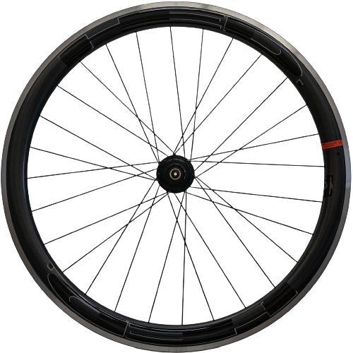

the hed jets have a pretty good reputation. alloy rim with carbon fairing. not the lightest alloy wheelset available, but decent and good aerodynamics.
of course, you cant hang your bike from a hook so might rule these out for anyone storing their bikes this way.
