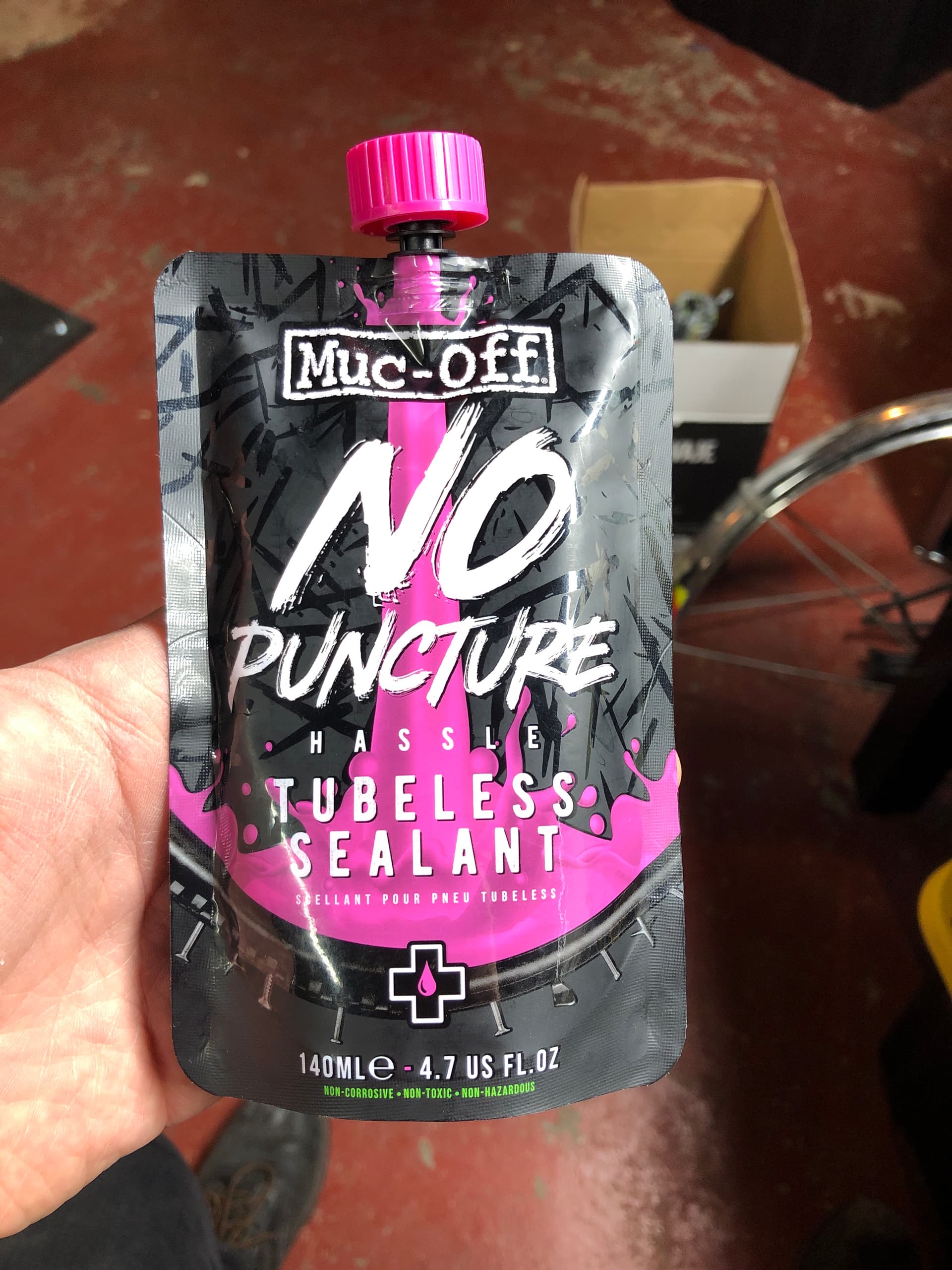

Is this stuff any good?
It says right on the bottle ā€œHASSLE TUBELESS SEALANTā€ which is not promising at all
But if it is actually pink I’d use it
respect to Muc Off for doing minimal packaging. how does the syringe connect to that package?
It is actually pink.
True minimal packaging would be like a cardboard milk carton with a resealable plastic cap.
I hate the way their sealant smells
Wait a minute…
Well is it? Have you used it? I’ve only used Stan’s an Orange.
