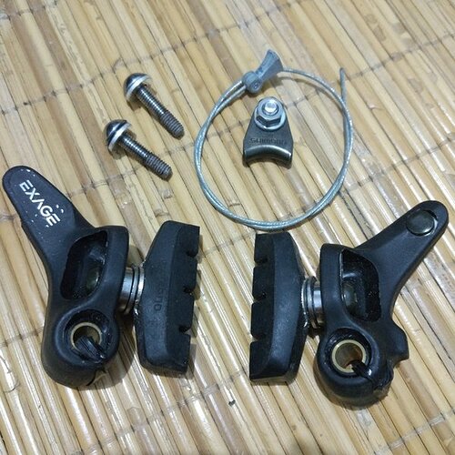

What’s the modern appropriate replacement for old Shimano cantilever brake pads? Like these pads:
Nothing clearly compatible came up with a quick google
No 8 in here might work. I searched on u-brake shoes. U-Brake Bicycle Brake Shoes and Pads - Modern Bike
I’ll bet something like a Koolstop Supra2 or City would fit
https://www.planetbmx.com/shop/bike-components-parts/brake-pads/kool-stop-vans-brake-shoes-in-colors.html
Rearrange the washers on a modern cartridge style v brake pad?
Replace with Tektros?

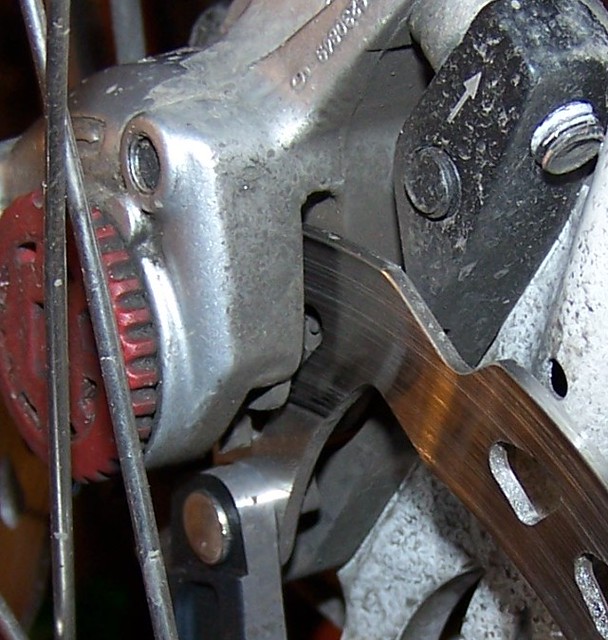

Are all 160mm rotors compatible with all 160mm calipers?
If this is too complicated, how about MT800 rotors with BB5 and GRX calipers?
I’ve been told that some enduro/dh type big rotors might be thicker enough than other rotors that they might not play well, but who knows.
Some CL won’t work with bb7s
Thanks y’all.
Gonna give it a shot.
New wheels arr CL so if that doesn’t work for my BB5 than it’ll be time for new breakers.

Imgur
The little tab on the BB7 inboard pad, which hangs out toward the hub is sometimes too long and will hit the aluminum carrier of some centerlock rotors.
In that pic above I have trimmed the tab shorter. If you do this and have spare parts on hand go ahead and pre-trim your spare too.
They can also be issues with the tab fouling with the brake adapter too. Some adaptors come with a built in recess, some have felt the wrath of my file.
