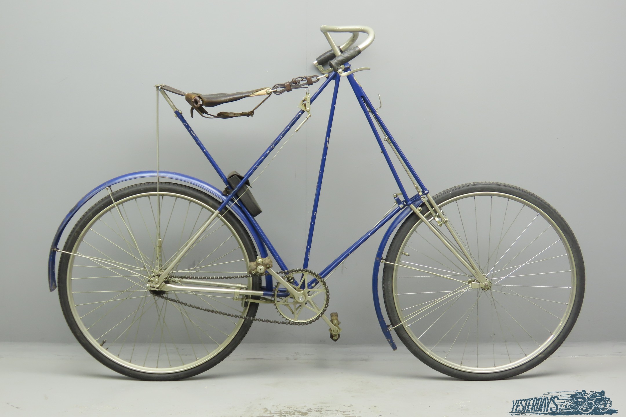

What’s that kinda bike called that has the hammock between the headtube and seattube?
Pedersen
:smilegront:
at first I thought it was a joke but then I learned the legend of Mikael Pedersen of Dursley
for when you’re not sure if you want a bike or an AP Physics diagram
Think you mean this, right?
Pedersen is what I was thinking!

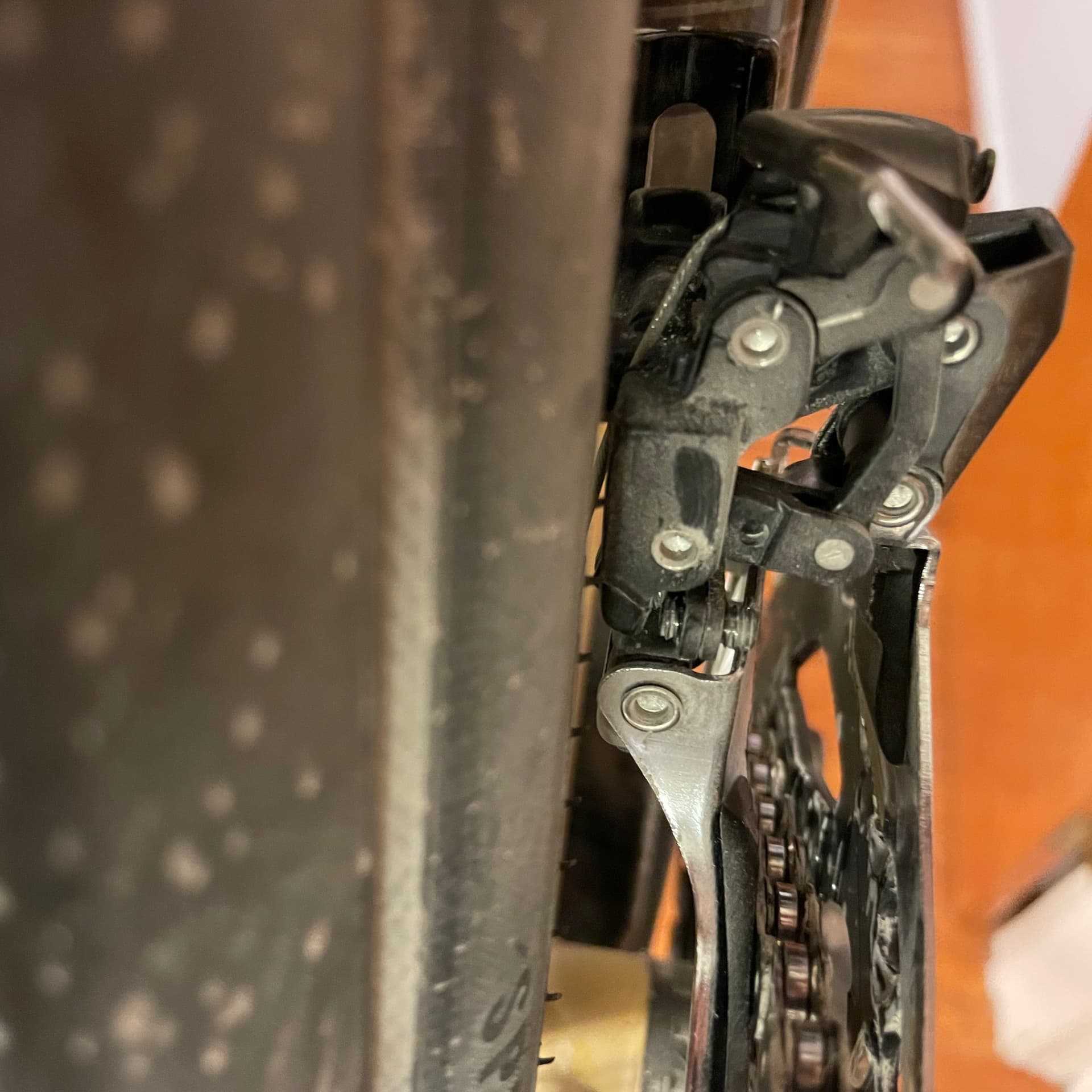

Sorry, fighting this thing is a PITA and I didn’t get back around to it until now.
Yeah, I think your way just gets there a little faster. The manual starts with the L screw in, so that the cage outer aligns to the outer ring, which just results in less use of the tension screw later.
Following all your steps until:
When I drop into the small ring, the chain rubs the inside of the cage with the L completely unengaged. Letting the H screw out here does what you’d expect the L to.
I’m pretty sure it’s the clamp setting the derailer too far outboard. You can see the L gap here, with chain contact on the plate:
That’s super weird. I use the problem solvers mounts almost exclusively with no issue. I see it’s the GRX crank too. BSA bottom bracket?
Derailleur is angled to be parallel with the rings? Not tail out at all?
What size seattube? No shims in the derailleur clamp?
May not matter but I like to make sure the derailleur is fully tightened into the braze on adapter without trying to force the angle at all. Basically let it settle in where it wants to so the concave and convex surfaces between the two nest together nicely. Then fool around with angle by rotating the clamp on the frame itself.
I also leave messing with the support screw until the very very end once everything else is dialed.
Yeah, BSA, no shims 28.6, parallel cage.
I’ll try starting from scratch with it later this week. Thanks for working on it with me! Mostly just needed the sanity check.

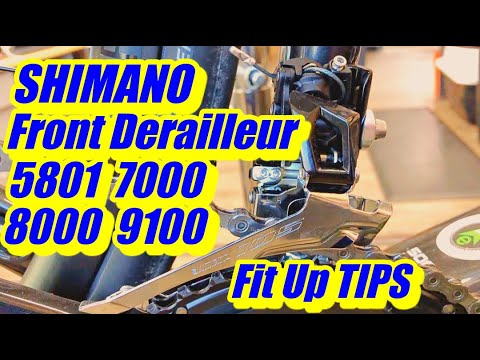

This video legit saved me from losing my mind while setting up my r7000 FD a few weeks back. I wasn’t having any luck with the dealer install guide etc but got it working perfectly after copying his setup process. The GRX design looks similar enough that it might be relevant/helpful?
