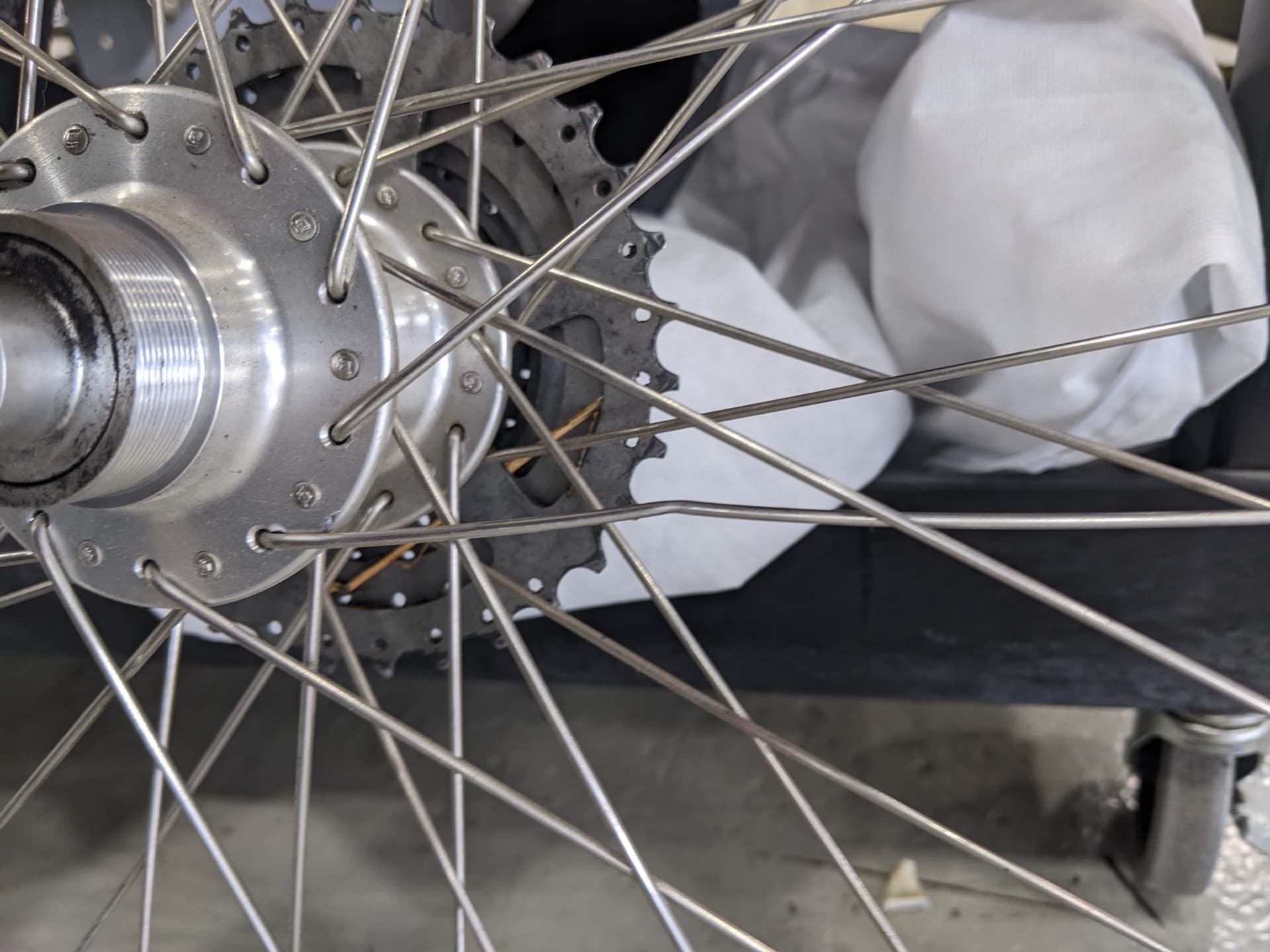

I should replace this bad spoke, right?
Ehhhhhhhhh
Is the wheel staying true and that spoke is holding tension OK? If so I’d probably let it ride.

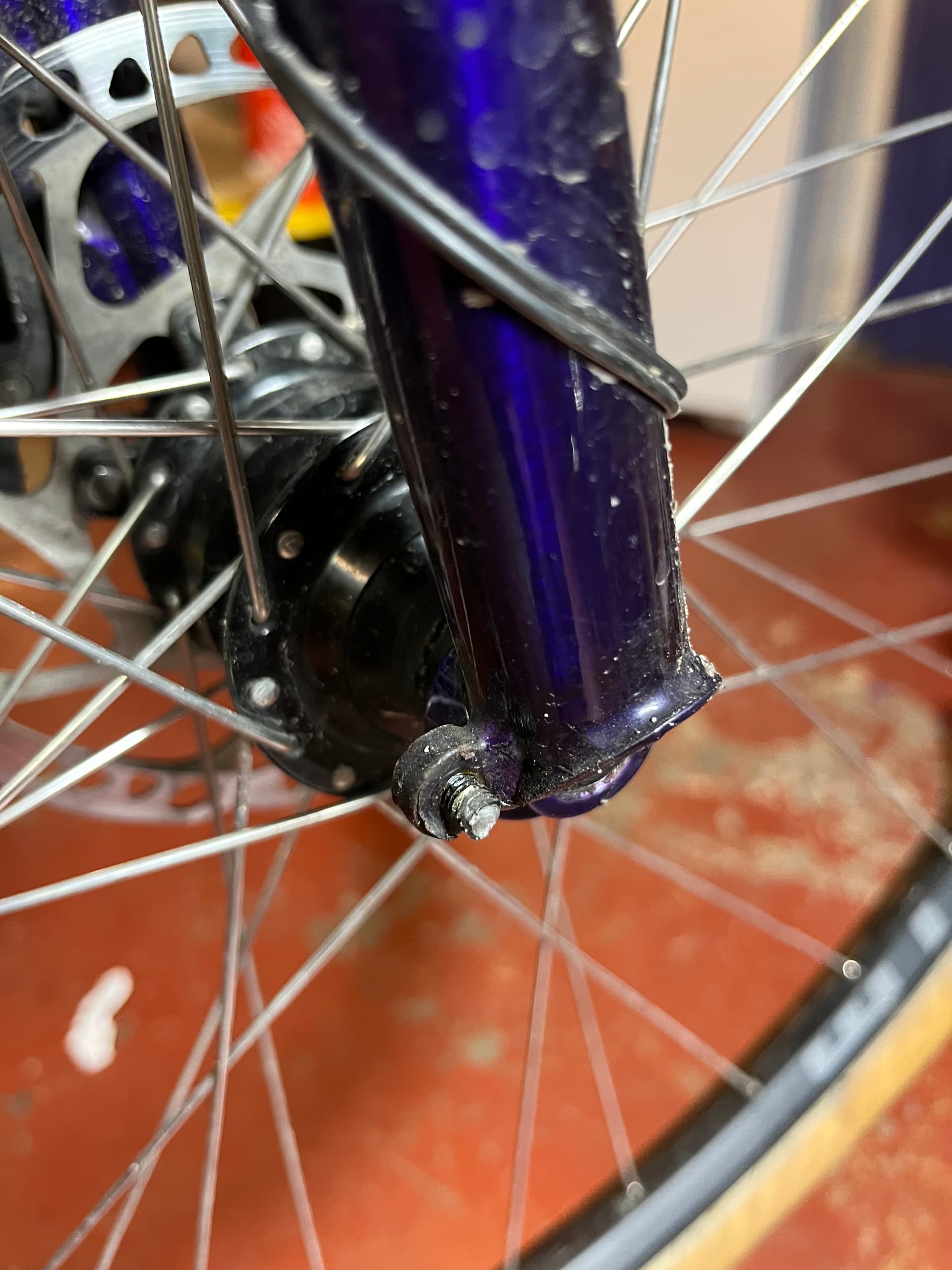

How do I extract this bastard bolt? Vice grips are a no go.
Maybe cut it flush with the fender boss, drill it out and retap the threads? I’d probably permanently bork the brazeon or rip it clean off the fork.
I’m assuming repeated bouts of Liquid Wrench did nothing? Probably not worth slotting it for a try with a flathead screwdriver? Get your biggest pliers, put on gloves, rock it tighter and looser?
Those are the steps I take with messes like that, sorta works sometimes
Set the fork on an anvil (or moral equivalent) so the brazeon is supported, then whack the end of the bolt with a mallet, then see if the gentle vice grip of persuasion can rotate it?
Try drilling from the backside, which will be turning in the direction of screwing it out the nearside. If possible immobilize the fork while doing this, and while you drill, have someone else also try to turn the nub with 6" Knipex cobra.
Soak it in pb blaster. Wiggle it with vice grips. There’s enough sticking out to grab for sure.
Say a prayer to Sheldon Brown, light some candles, and reef on it with vice grips.
Find good vice grips. Tight pivots. Parallel jaws. If there is play in them they are more likely to rock off. I might avoid depot for something this important. Some tools at depot look identical to something you get other places but costs a lot less. They force mfgrs to make tools at their prices and it can show up in the quality. Welding supply will have the best vice grips.
