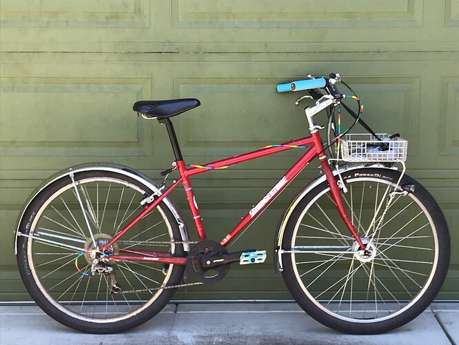

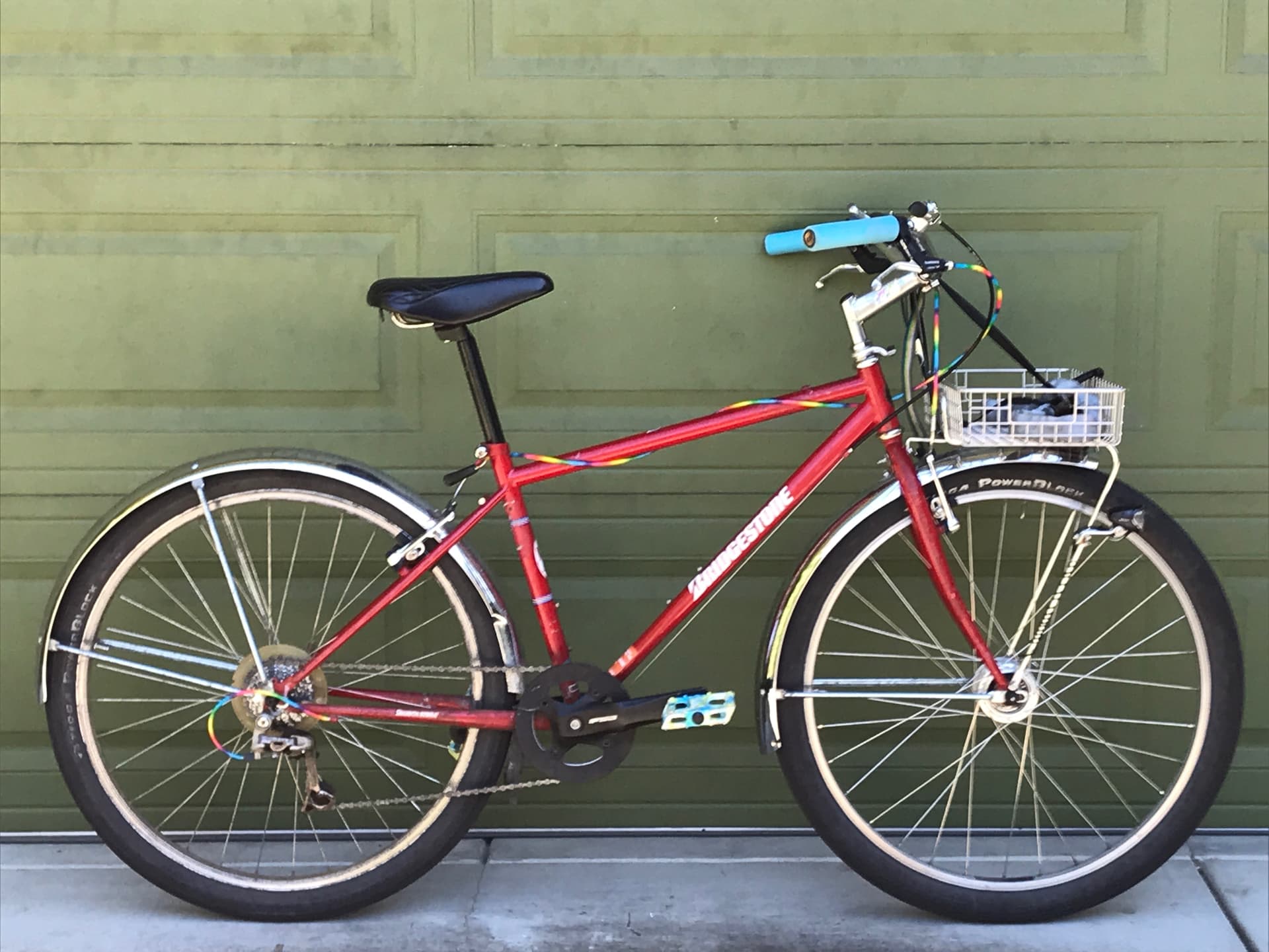

iām due for a new rear rim + cassette on my red bridgestone mb-4 and want more range, so i might as well do a new hub, too. What can a squeeze in here? 11speed and keep my power ratchet thumbie? Will I need a new dangler if i get a big new cassette?
Dt Swiss 350 comes in 130mm
I donāt think your going to get more than 36 teeth under that derailer.
