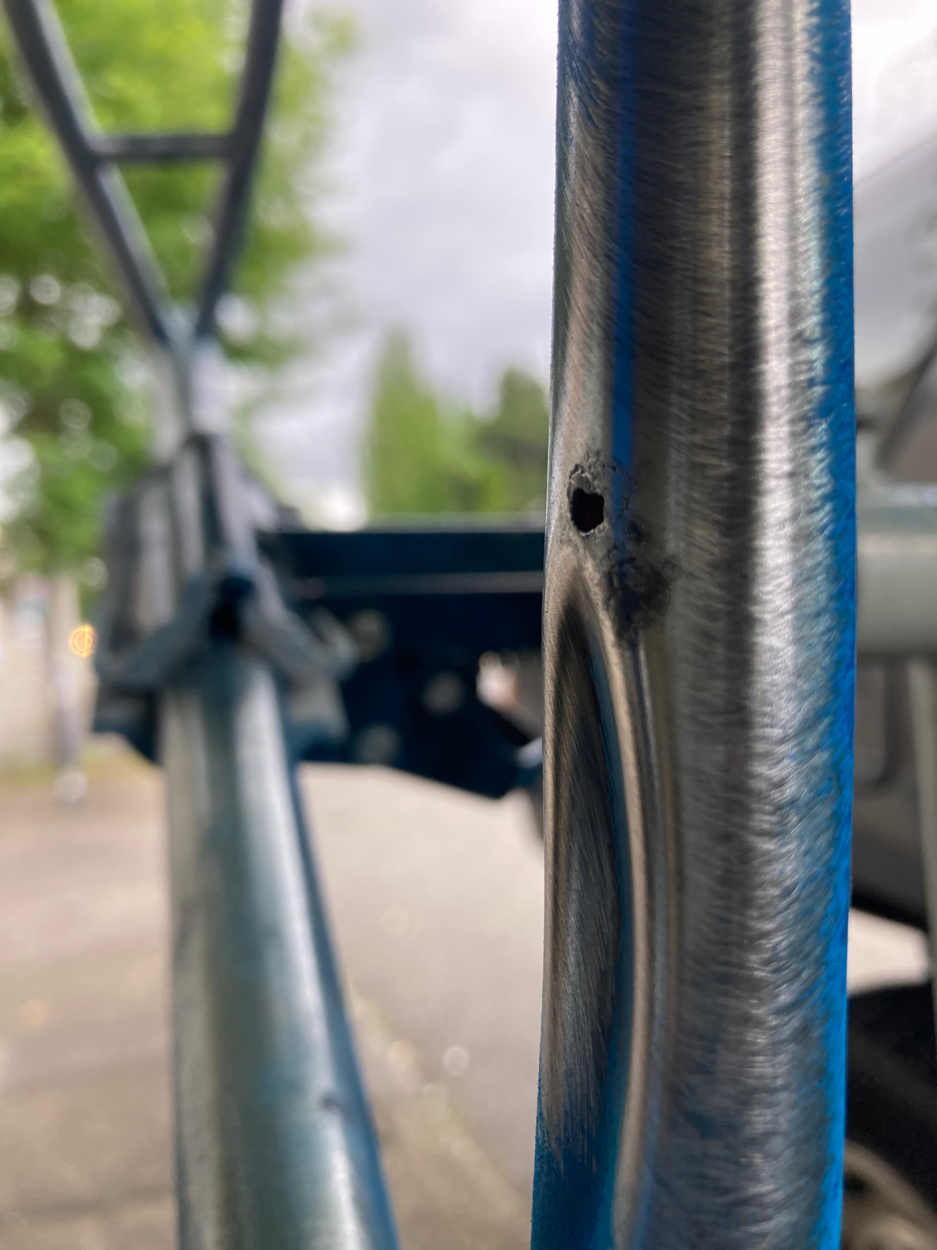

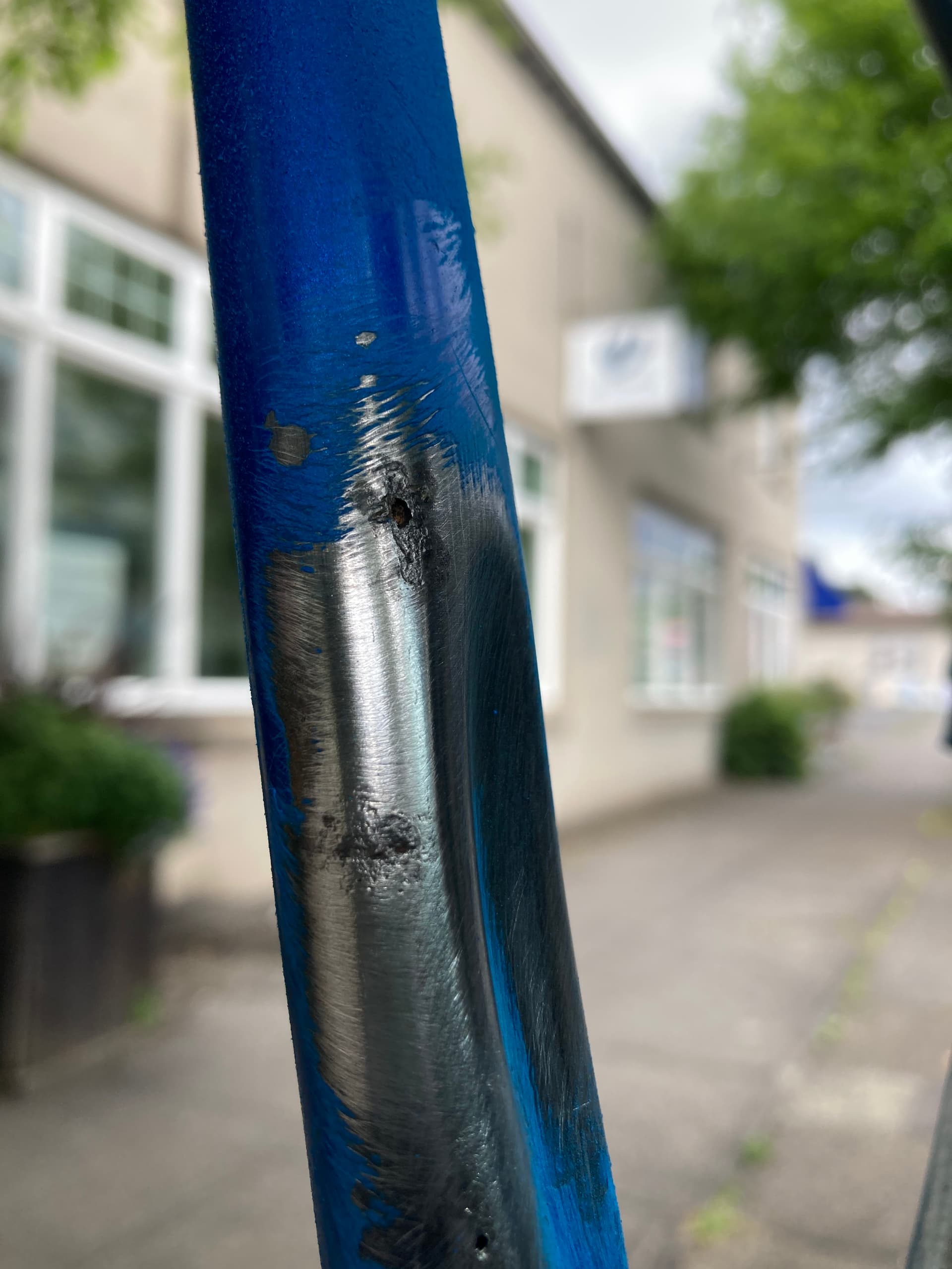

Sanding down a frame to paint for a friend, found some pinholes due to rust on the chain stays.
They don’t do much heavy riding, primarily small commutes and jaunts to tinder date park hangs.
Figure I could rustmort the insides and then frame save but what do y’all think about me just filling the holes with brass?
The previous owner was a shithead bike messenger so I can only assume that’s when the rust happened but he isn’t the original owner of it either.
If that is what you can see on the outside I’d be pretty worried about the inside IMO. Some of those look like the surrounding area is very thin.
I’d be nopeing out, pointing out the holes and leaving the ‘should I ride this’ decision to the person who takes the fall if the frame fails.
That’s sort of what I’m thinking. Like if it were mine I’d fucking send it. Definitely has been neglected for a bit. I’m still sort of leaning towards maybe doing that but no yeah I for sure understand that
I’d be a bit nervous about the pitting around those holes. If it was mine, I’d be lopping off and replacing those chainstays, but that’s a somewhat more involved repair than a repaint.

Yeah, fair. I just didn’t really want to go thru the process of stripping another frame down to paint
