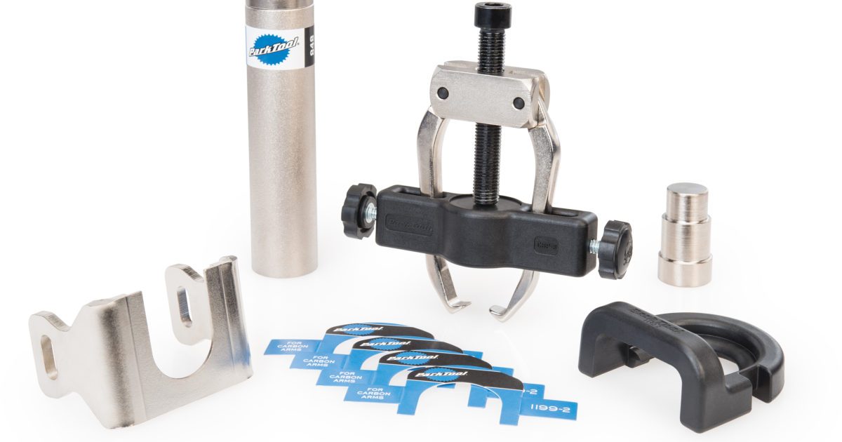

The removal tool is a two-jaw bearing puller with cardboard to protect the back of the crank but Park has an alternate method:
They eventually made a coupLE PT cranks that removed with an autoextractor bolt, don’t know which ones , or which this is.
Just the number of tools in that picture makes me think it’s not worth it
Interesting, I didn’t know this.
I will say, it’s annoying but not insurmountable. I have a set of aluminum Centaur cranks on an old cross bike that gets loaned out frequently and I’ve only had to change the bearings once. I used a harbor freight bearing puller and a piece of tube to protect the crank.

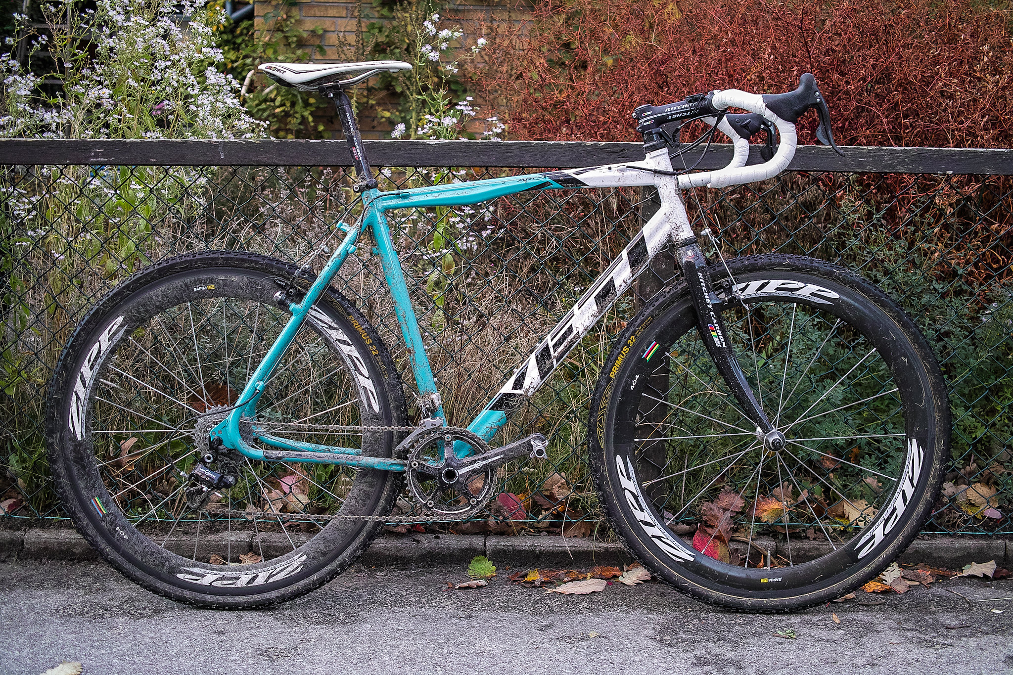

I ran the same type of bb (Veloce with power torque) on my Yeti CX race biek way back when, had zero troubles and the removal isn’t that bad as people make it out. I made do with a simple bearing puller type jobber from the hardware store and never had to remove the bearing from the NDS crank arm. I suspect that would be the most cumbersome job but for that type of money I’d give it a whirl

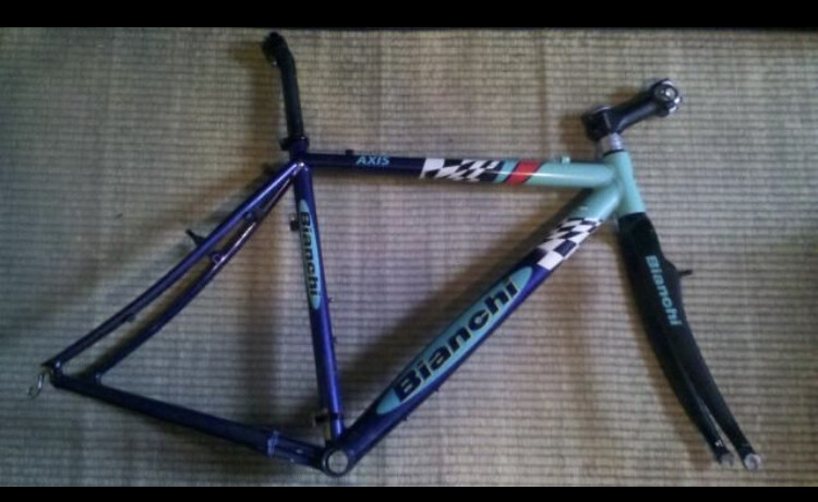

man i love old light alu cx bikes. i still miss my bianchi axis
i do not miss my empella bonfire one bit
also do not miss the van dessel i had
i didn’t know much about bikes then. it was my first light bike and my first bike i used clipless on. it was fun as hell
best photo i can find right now. too cool for school.
i was so jealous of those. i loved the weird checkered flag lookin thing on the paint
That thing is fuckin sick
