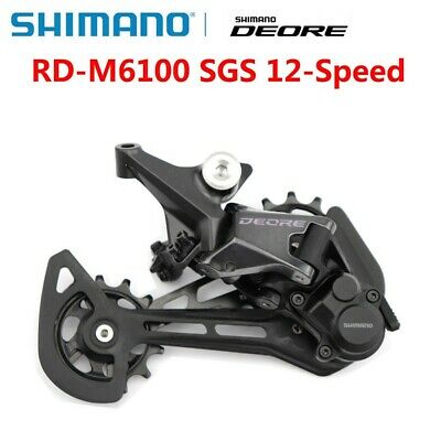

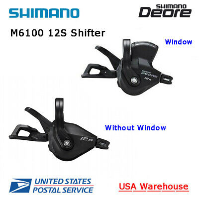

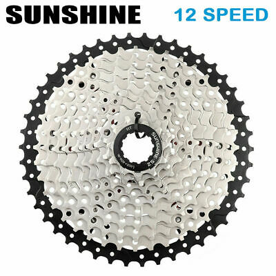

Why not spend $150 on a deore 12 dangler, shifter, chain and cassette?
