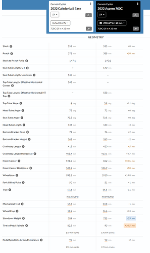

Yes I believe the Caledonia presumes youre riding it more like a road bike. Bigger stem. etc.
Aspero is longer top tube for a short stem, etc.
I believe that the Aspero is a pretty racey gravel bike, not slack at all.
I’ve read accounts of people owning both bikes. Aspero for gravel/mud, and Caledonia for roadie duties with some hard pack mixed terrain.
The geometry differences between the Caledonia/Aspero are some real 1m/m-er stuff
I get it, just never seen such a clear “use a 10mm shorter stem”

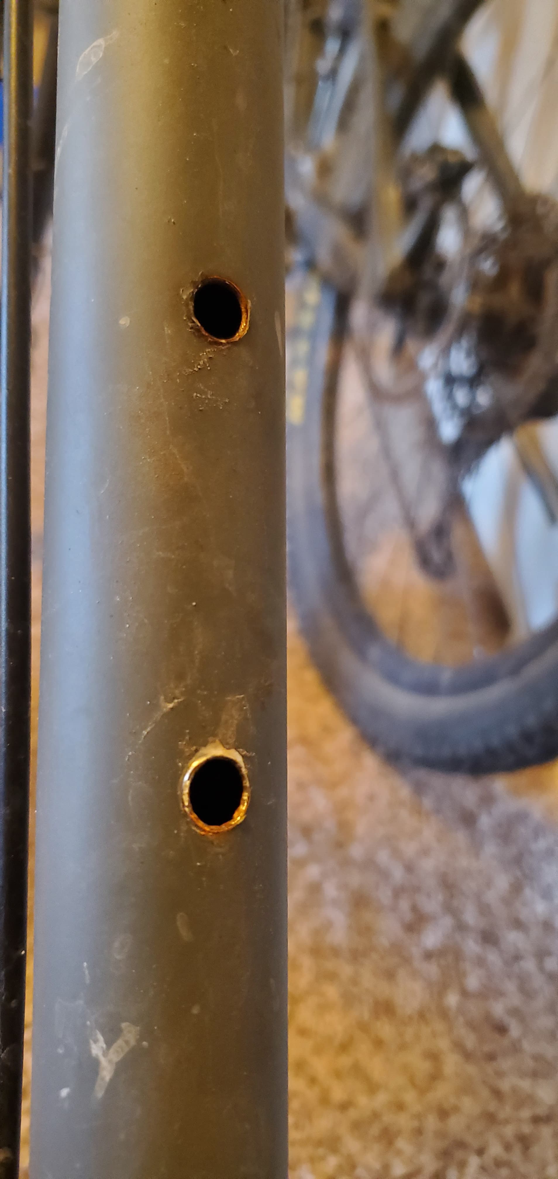

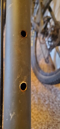

Alright folks. So my bottle cage bosses came right off. They appear to be rivnuts. But like, was the hole drilled too big? Rivnuts installed wrong?
What happened and how do i fix it?
Yeah :man_shrugging:
They look like brazed bosses to me, but with a pair of very incompetent brazes
sounds like some eldridge crap
yeah, those are weakly brazed braze-ons
you can get new ones brazed back in, or switch to rivnuts
if you do rivnut, I highly recommend spacing the rivnut with one of these when doing bosses on steel frames. I can send you a pair if you go this route
assuming rivnuts are still a durable option, that seems like my best bet. i paid $1000 for the whole bike, so not working with a big budget for repairs either.
they’re all cross checks my friend
