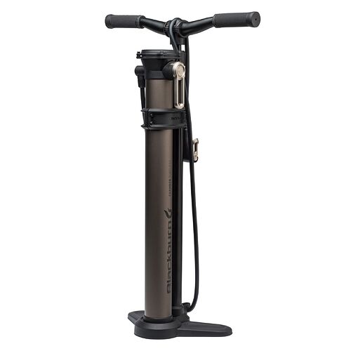

someone please get this and tell me how it is
that is nothing but tubes?
yeah it’s a large high pressure tube that spurts air through a small and flexible tube to fill the tire that doesn’t have a tube
