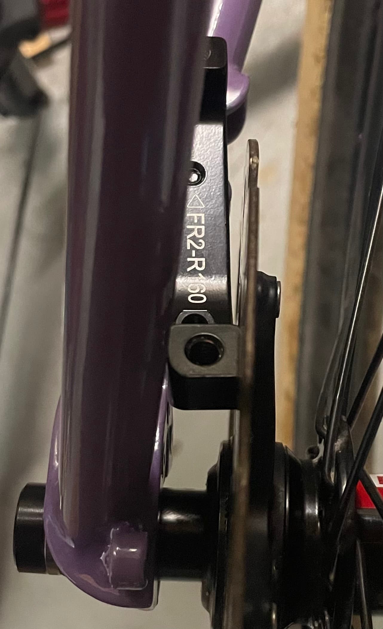

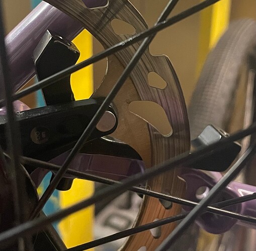

I was hoping to use my post mount Juin Tech GT-P dual piston brakes with 160mm flat mount adapters. Alas, the rear triangle of the small size HG is too smol to fit either the naked adapter or the fitted caliper. Tried CX77s, same issue.
Looks like I gotta get a flat mount caliper.
That’s a bummer. I planned on using adapters as well. The XL is probably a different story, but gonna check that out first just in case.
For sure- why I specified. It seemed like the kind of seat-stay interference that would possibly disappear with a bigger angle there, but it might still be tight. The adapters just kick the calipers waaaay far out from the frame.
Edit: some photos of small size interference. The adapter can’t kick out of the way of the rotor enough due to the seatstay, meaning a flat mount brake is required.
Shorter seat tubes this go around not helping either. It’s definitely appreciated to get info like this from someone that builds stuff up right away instead of multiple months later (like me).
It’s tight there. The original SM and MD sample frames couldn’t clear a flat mount Klamper so we opened it up.
Not a ton of real-estate to work with
