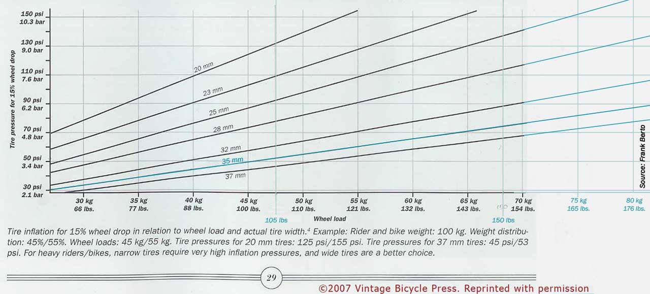

I typically run 32mm tires at like 60/65 for street and I weigh 185 on a good day.
What is the point of fat tires if you don’t run them soft?
Got to get that 15% of sag on: http://www.bikequarterly.com/images/TireDrop.pdf
that chart makes me feel better about running absurdly high pressure in my skinny tubs
Plus tubs just eat up the pressure like candy compared to clinchers
I’ve followed this & have been pleased:
Tire Width=20: Pressure(psi) = (0.33 * Rider Weight in lbs) + 63.33
Tire Width=23: Pressure(psi) = (0.33 * Rider Weight in lbs) + 53.33
Tire Width=25: Pressure(psi) = (0.33 * Rider Weight in lbs) + 43.33
Tire Width=28: Pressure(psi) = (0.33 * Rider Weight in lbs) + 33.33
Tire Width=32: Pressure(psi) = (0.17 * Rider Weight in lbs) + 41.67
Tire Width=37: Pressure(psi) = (0.17 * Rider Weight in lbs) + 26.67
