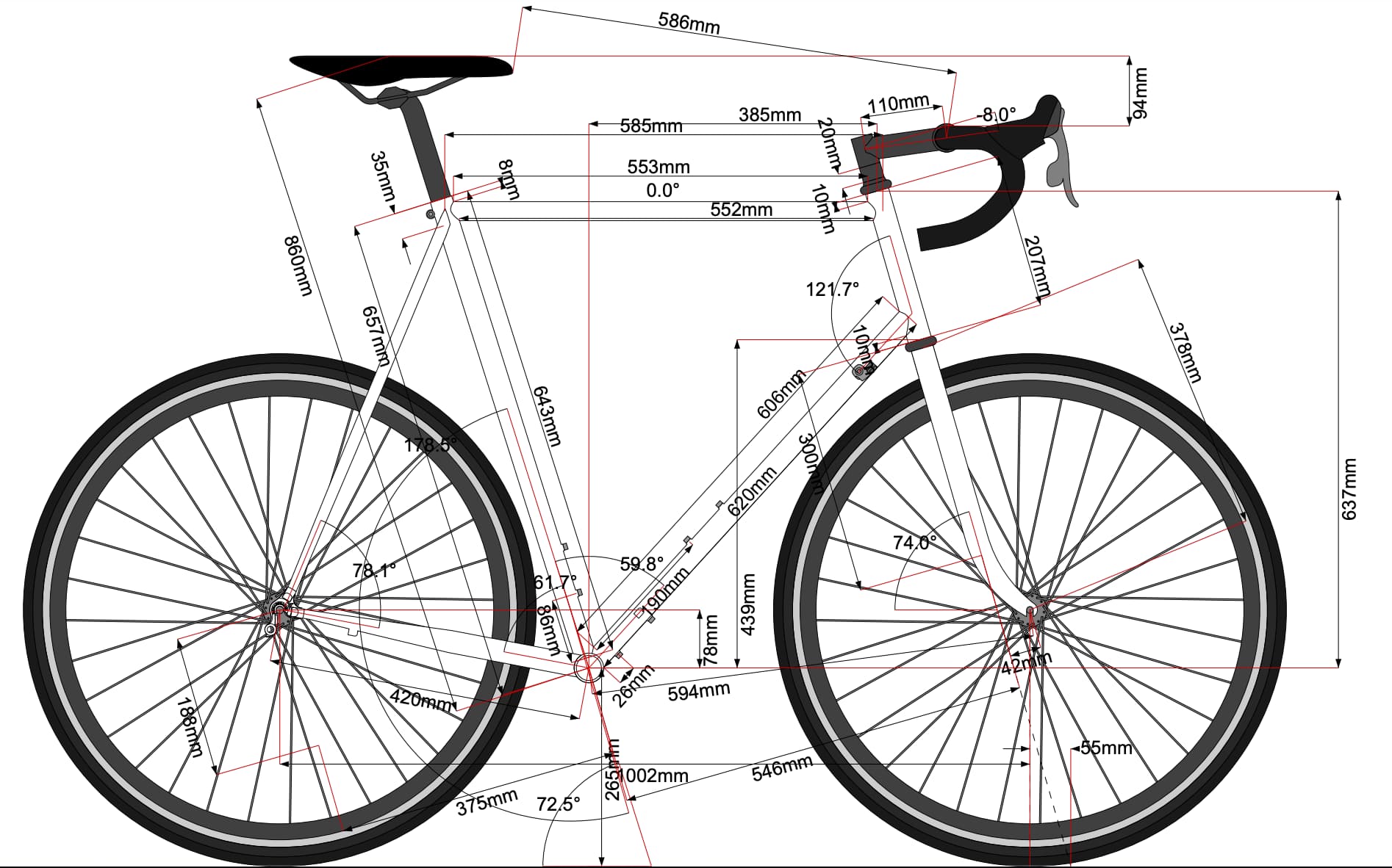

Hey y’all, in order to soothe the unmitigated disaster that was my cycling season, I have decided the best way to get riding more is to build a frame. Impeccable logic, I am sure you agree. My only road-ish bike is my rando bike and it’s too much for a spritely 60 km spin in the hills in nice weather. The only true road bike I have previously owned was a 64cm Marinoni built with SPX. I loved it, but didn’t want to sauvage the drive train to make it practical (it’s gone now).
I have a framebuilder friend helping with the details but I need to make a call on tubing spec. My fomo and curiosity on wigglebikes has me wanting to build the new frame out of the Kaisei super light tubeset, but with the geometry my framebuilder friend is cautioning me that wiggle bike could be an overcooked noodle. As for riding style, I spin and rarely stand/sprint though I should expect that a lighter and more fun bike might at least get me out of the saddle for some climbs. Any words of caution for this approach?
Geo below (building for 700x32 clearance) and 1" threadless steerer. The fit shown here is based on my rando fit, more or less. If there is anything else to flag, I’m all ears.

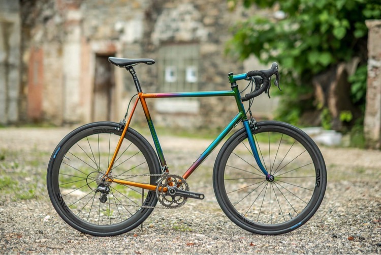

Inspiration (which I am sure to bastardize):
How much do you weigh
Right, should have mentioned this. 165 lb soaking wet.
Probably fine with the standard diameter super light tubing. Others you should check out is Columbus SL and Reynolds 853/pro team
Thanks, will do. I think @JUGE_FREDD had his mercian built with this stuff?
Not sure on the complete tube set but I know he got some for sure
so you’re like all legs,huh. I was going to give the standard large person caution about how all bikes plane, but if you’re a steady 165, it’s probably less of an issue.
