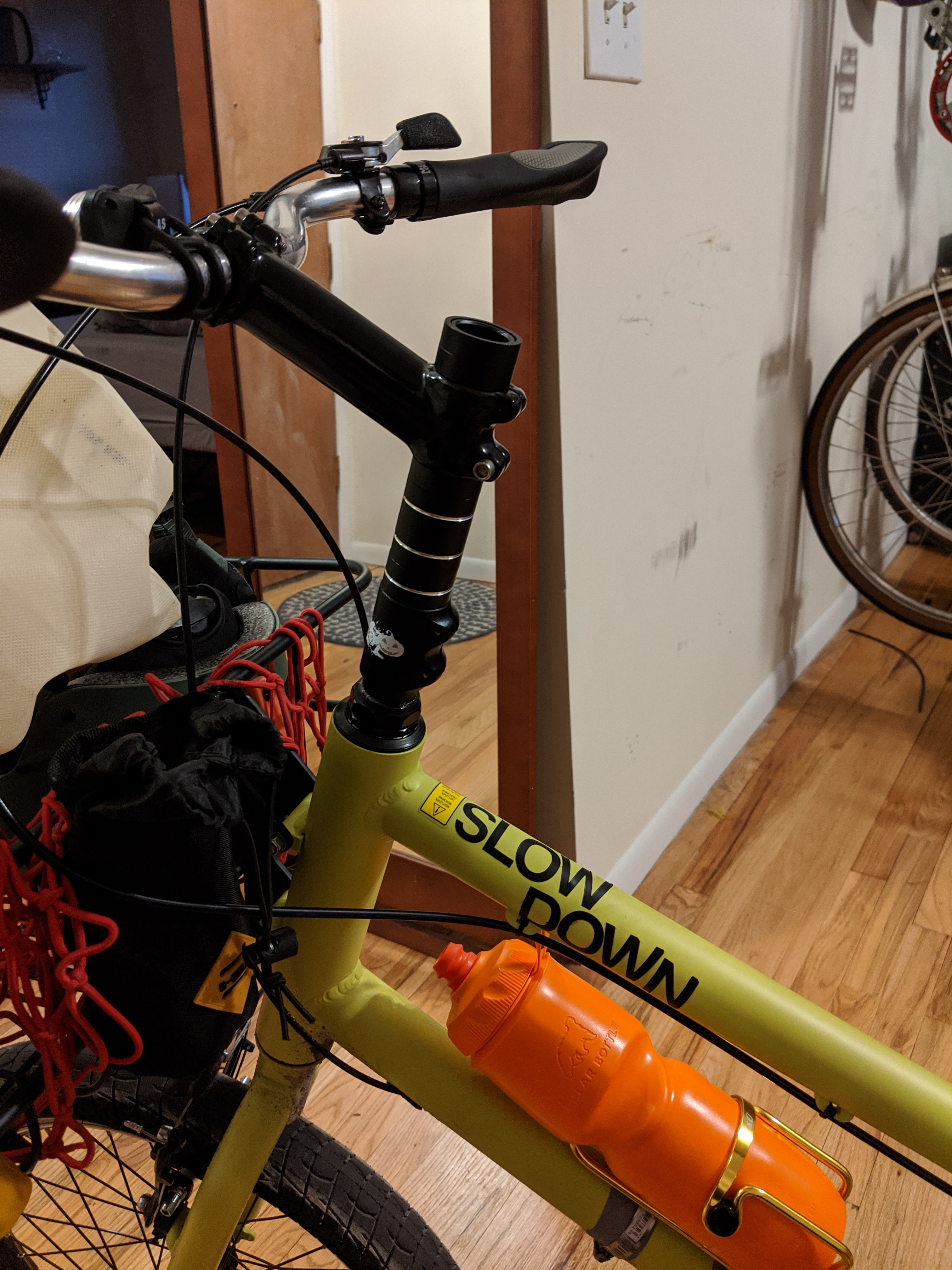

How may adapters in that spaghettistack?
just two
threadless adapter in 25.4
7" threadless extension
out of previous self respect. ive never used an extension so idk if its all of them but this one works with a really long bolt that threads into your headtube’s starnut, which makes a lot of sense. I can’t use that because i’m running this threadless adapter, so i need to put a starnut in the extension itself. losing some strength but will be fine on this bike methinks.
The starnut sounds like it would only be there to hold on the top couple of spacers above the stem. There might be simpler ways of doing that which don’t require setting a star nut (maybe using mild adhesive). You could also just leave the spacers off the top if they’re decorative only…

Def just decorative but it’ll drive me nuts to just be an open hole
That’s what you deserve for having that stack and only one set of handlebars.
