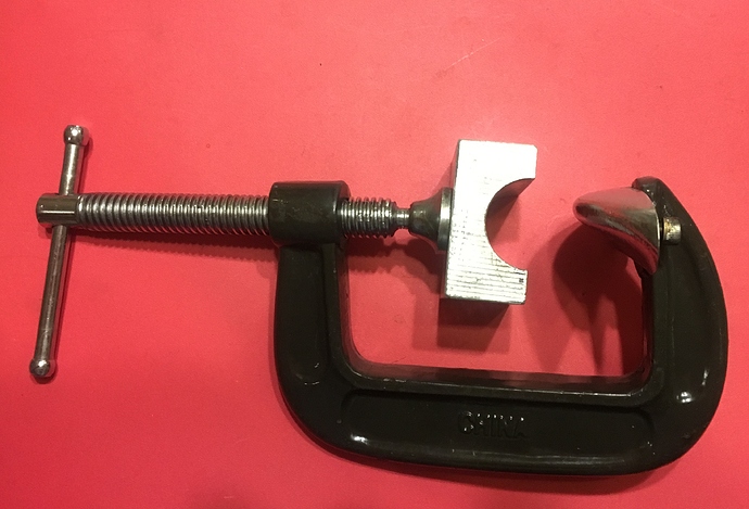

Economy chainstay dimpler, made from the back of a golf club head, a 3" clamp, a couple of m5 bolts, and either a 1⅛" or 1" (depending on what sort of chainstay I want to dimple) tubing block:
It takes a while to saw a golf club head in half, but there was no way I was fitting the assembly into the gap between chainstays unless I thinned the fuck out of that thing.
Only bettered by a complete golf club swung with unerring accuracy at a stay balanced on the tee.
Neat! I’ll probably need to make something like that when I 650b the Trek.

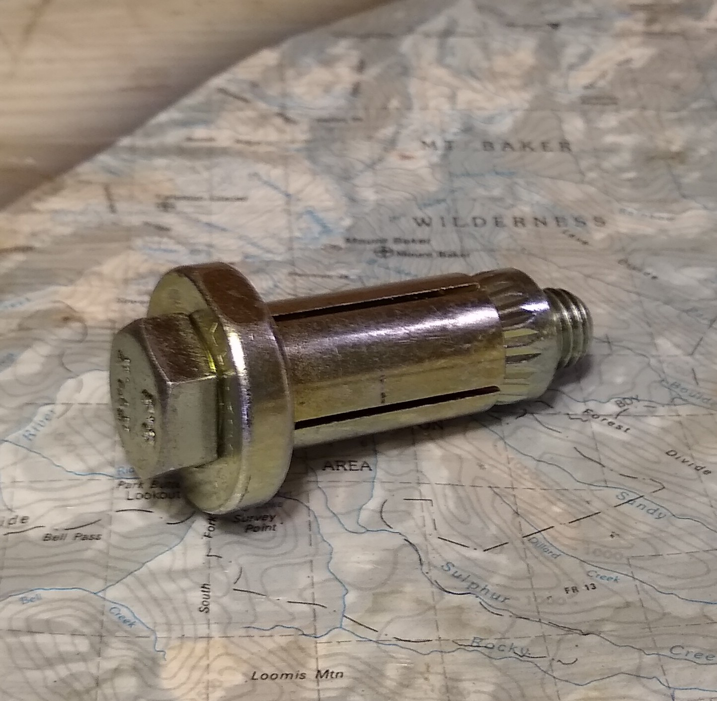

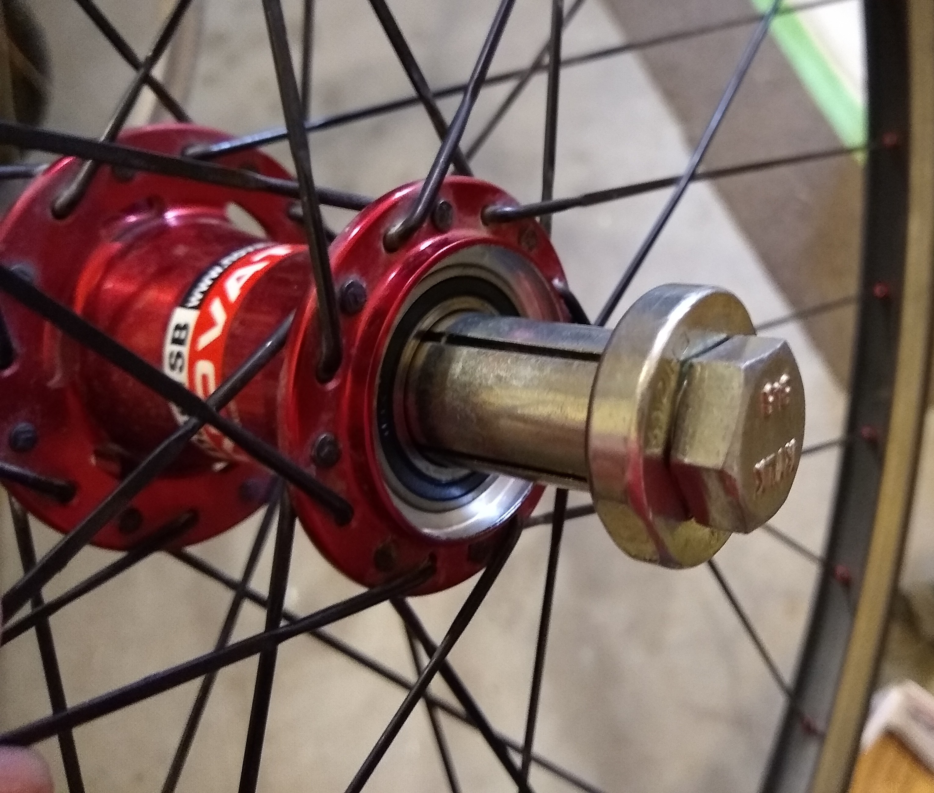

https://tof.cx/images/2017/12/29/9f6f64a0efe1d9f915e2d395e75b9156.md.jpgLast minute wheel bearing replacement, but I don’t own any blind bearing pullers.
An M12 Hollobolt is a perfect fit for a 20mm bore on my bearings, Yahtzee!
I have an old spectrum downtube that was cut into a door pull. Basically chopped the head tube and chainstays/seat tube along a flat plane
Dude those hollo bolts are like $10 a piece. Also, where do you find them locally

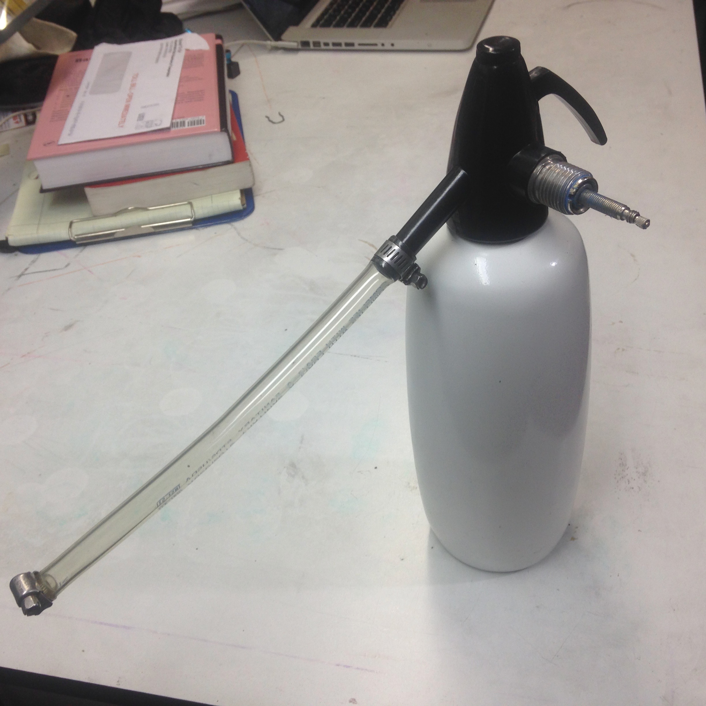

I freebie’d a whipped-cream maker, the kind that takes n2o carts. After gluing in a presta valve and drilling out the internal restriction, it works as a bead seater:
How did you glue the valve in? I will keep an eye out for one at the op shop if the conversion is that simple
The valve is mechanically held in by some washers/nuts around the already existing gasket, with blue RTV to seal it up. Also need to disassemble the valve before drilling the restrictor, but it was pretty straightforward.
This one has 1L volume and on-label usage is to put in .5L of cream and then charge. Opening an 8g n2o cart into .5L of airspace might result in ~120psi if I’m working the gas laws correctly, so it should be safe for that much pressure. I think the valve is also designed to leak if overpressurized but haven’t tested that.
