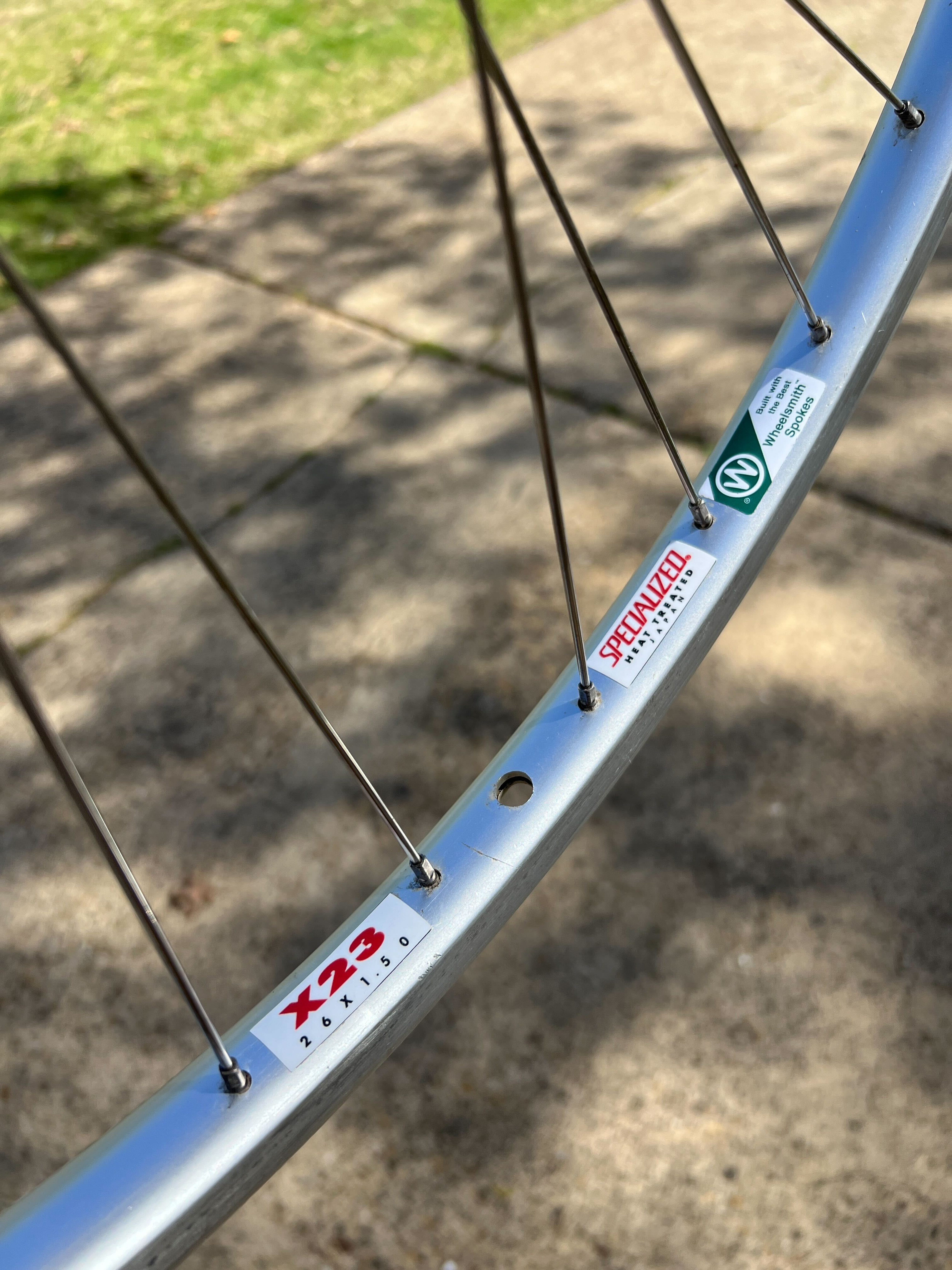

I also realized I didn’t post a clear shot of my reproduced rim stickers on the rim:
I found a reference image in an online used bike parts site and was able to lay it out pretty easily in Illustrator. Found a vector of the original Specialized logo, and the font used in the smaller black text is Futura, naturally.

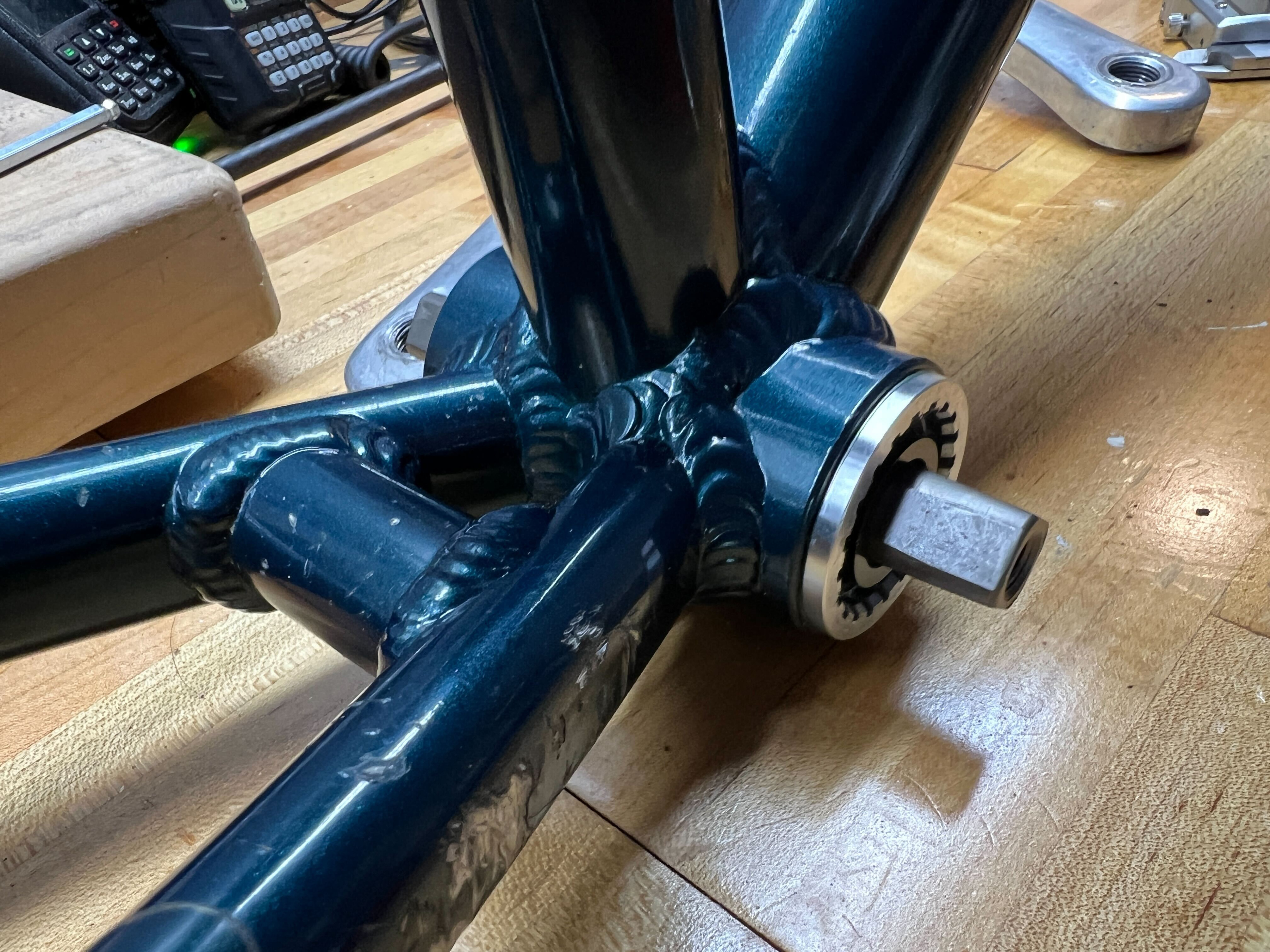

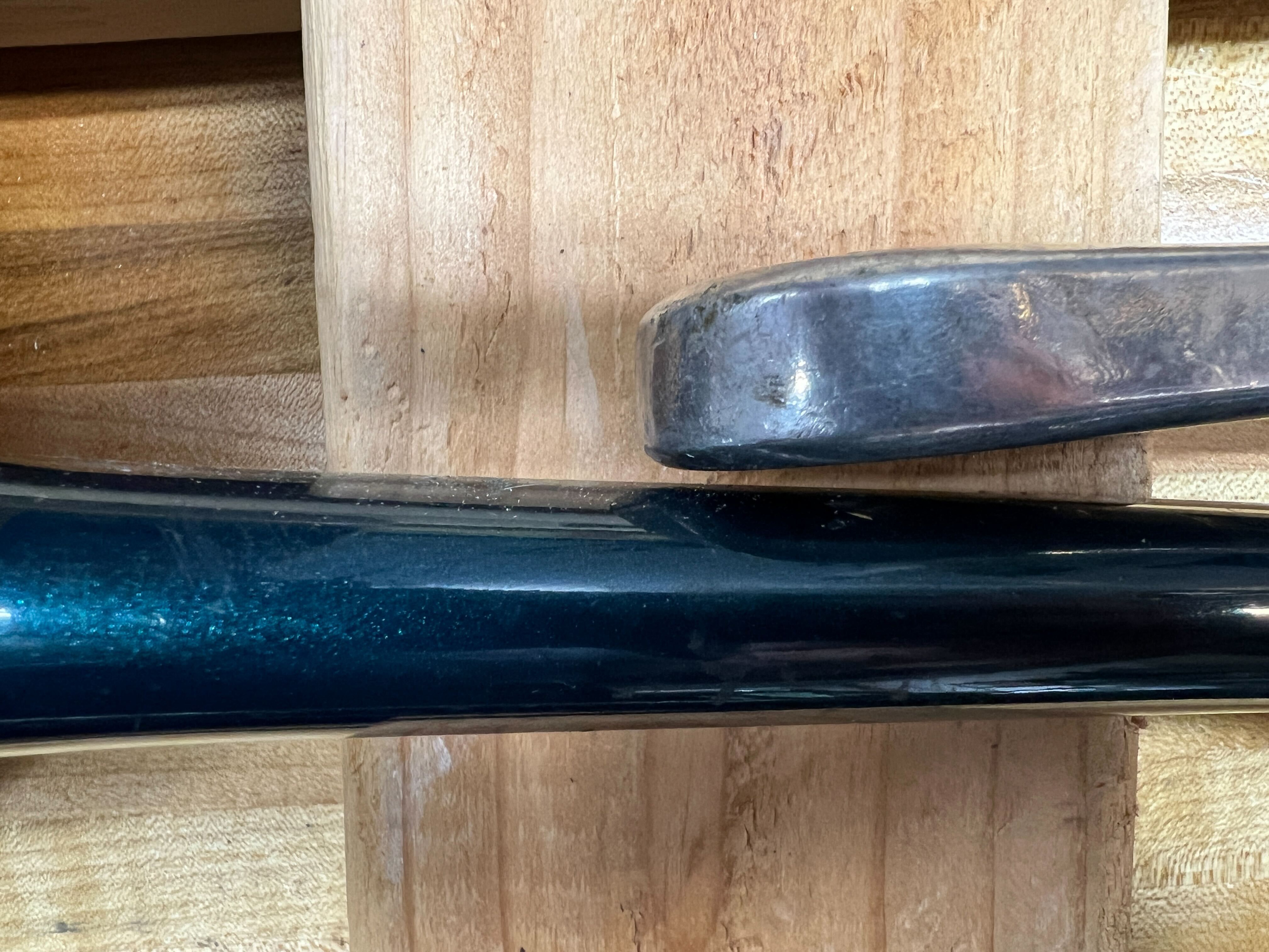

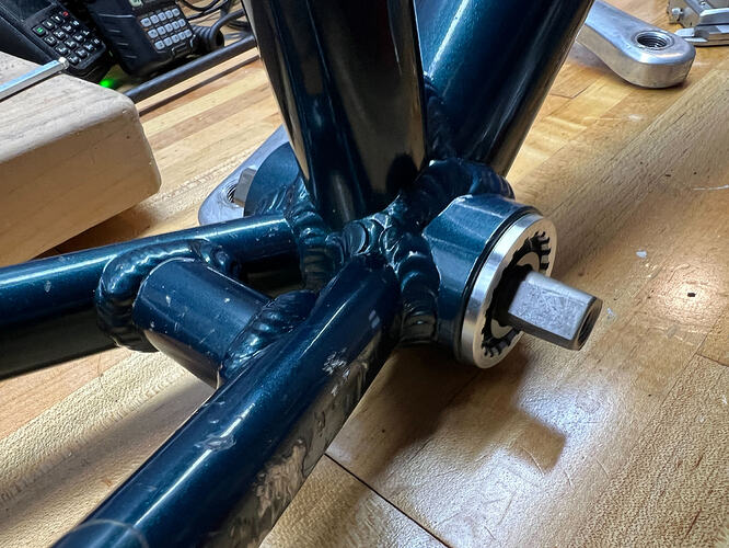

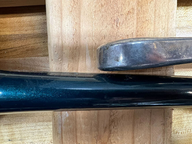

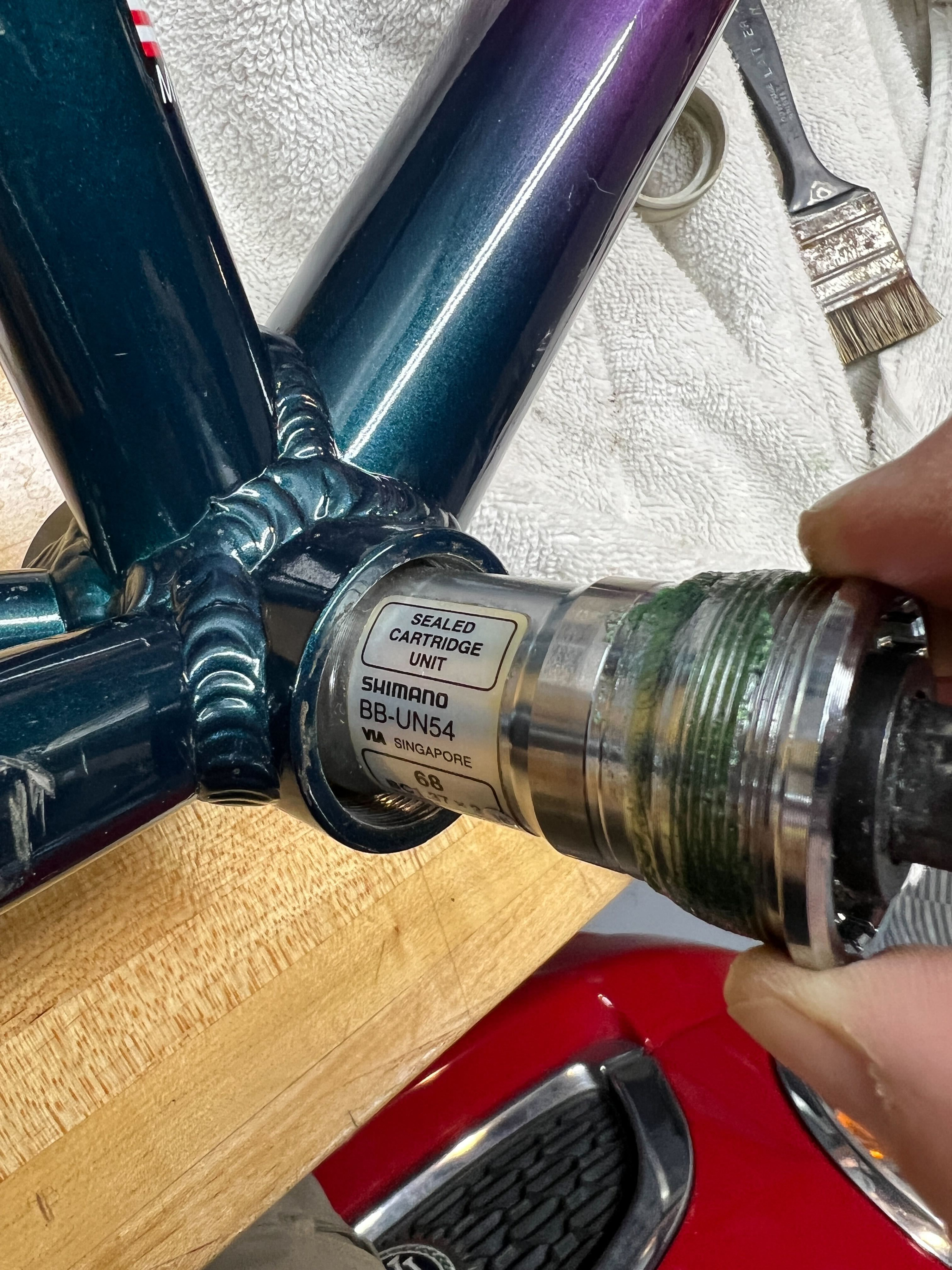

Had some time for bottom bracket blunders…
Turns out “normal width” is 73mm in this case! @jimmythefly called it and I forgot to heed his advice.
I happened to have a 68mm 113mm spindle UN54 on hand, so I stuck that in there like a dummy without measuring the shell, and here’s where I ended up:
Ope!
That’s not gonna work!

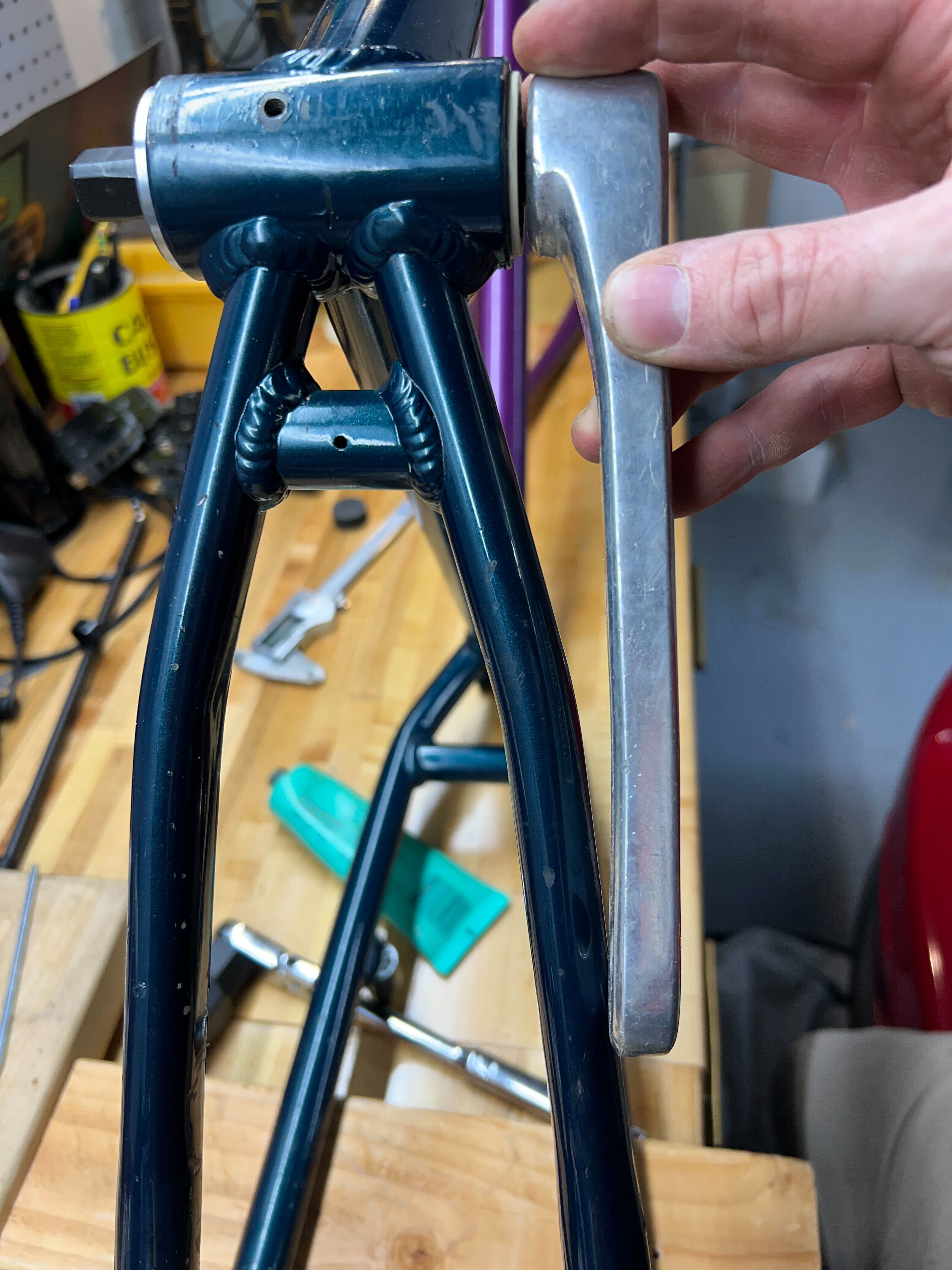

So I went down to the LBS and picked up a UN300 at the correct width and still 113 spindle:
Here’s the NDS:
Not sure if I like that!
I have a UN55 coming in with a 118mm spindle which will probably be the sweet spot, but I’m going to mock it up just to see how the chainline is with this 113 in there. Even though it clears and there’s probably not too much of a chance that it will hit, I think it absolutely will hit under load with flexing/stressing and whatnot.

What cranks? Seems plenty meaty if you wanted to take a file to the backside and shave a bit off for clearance. But I agree it’ll probably hit under hard pedaling. How’s the clearance for the chainrings?
I just met a kindred soul yesterday, selling some of my old 26er stuff to this dude and he also has a garage full of bikes and it was very difficult to actually sell him my stuff vs. arrange some sort of trading of parts between us.
I had that same thought! If the NDS crank arm was just more straight or not as thicc, it might be fine.
Edit: Drive side is completely fine. It’s a triple, but it’s going to be a 1x8 and I’ll run the ring on the outside, hence the 113 spindle. Lots of room for the 38t ring, but would get close with a larger one. I would not be able to put anything on the inner positions, but I don’t plan to.
I’m not especially attached to this one. It’s a Sugino AC, and I have no idea if that’s a “good” crankset or not, it was really just the cheapest option I found that looked decent from a reputable company.
I’m not opposed to grinding if the chainline ends up being off with the 118, but I’d rather avoid it if I can. BBs are cheap enough and it’s already on its way.

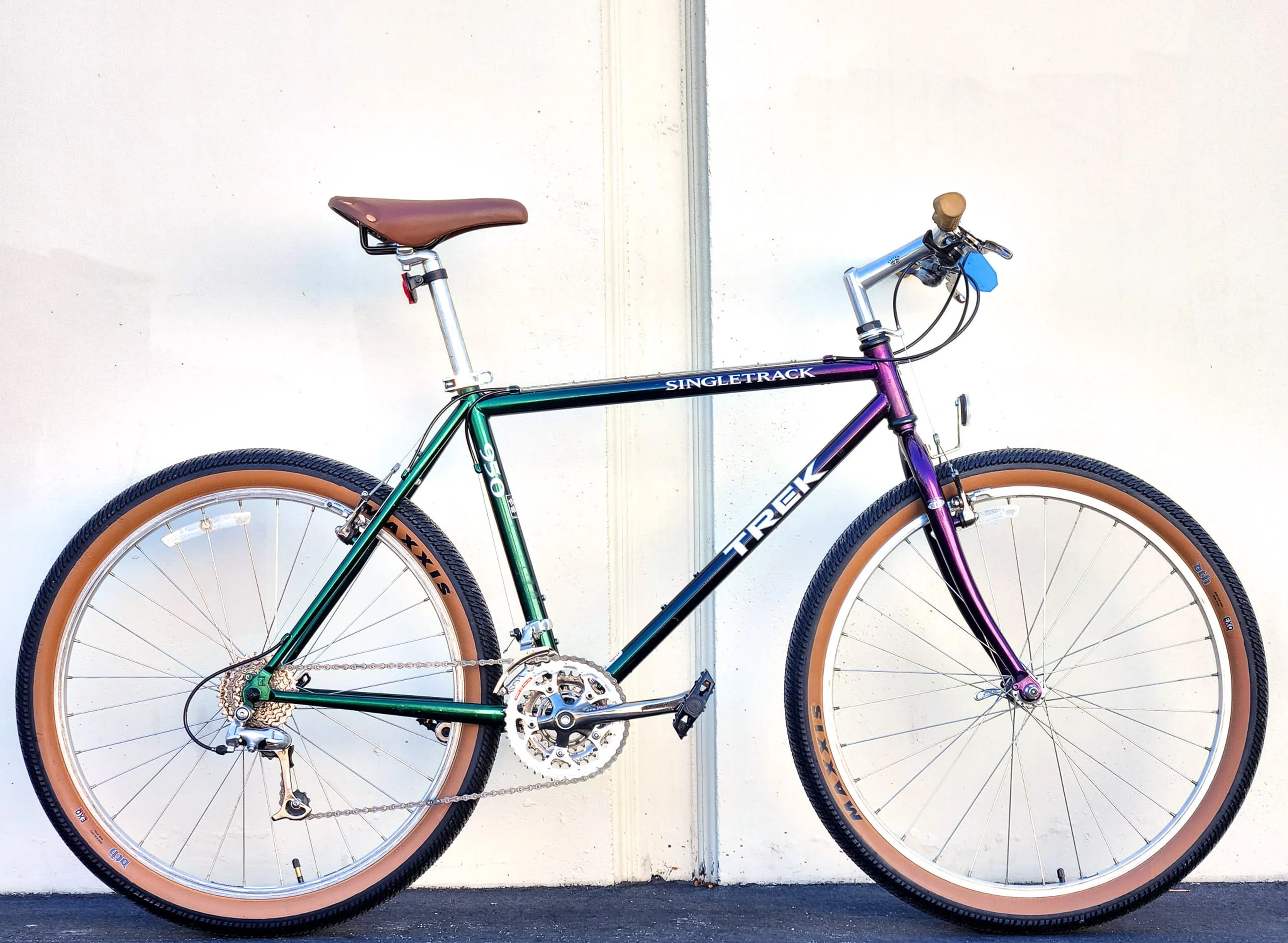

I might steal this paint scheme for my next bike.
it’s so hard to get good metallic fades though, and then you need matching ano parts

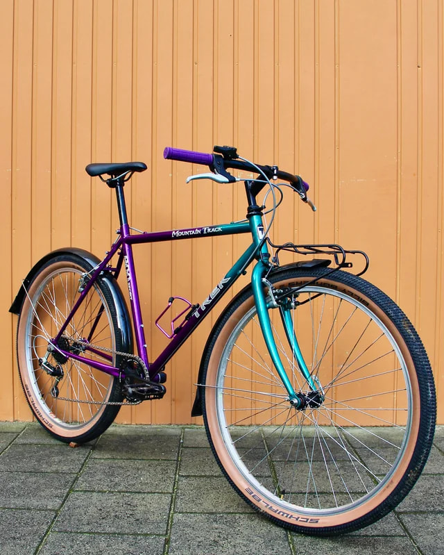

Some Trek SingleTracks, Mountain Track and MultiTracks of the same era had basically the same colourway:
hmm maybe just do the purple→green chameleon paint instead
In addition to the purple skewers, I’m doing some tasteful / tiny gold hits here and there. Just small parts. It’s not like I particularly love gold - it can absoultely get gaudy, it’s just really complimentary in this case. Everything else will be silver.
