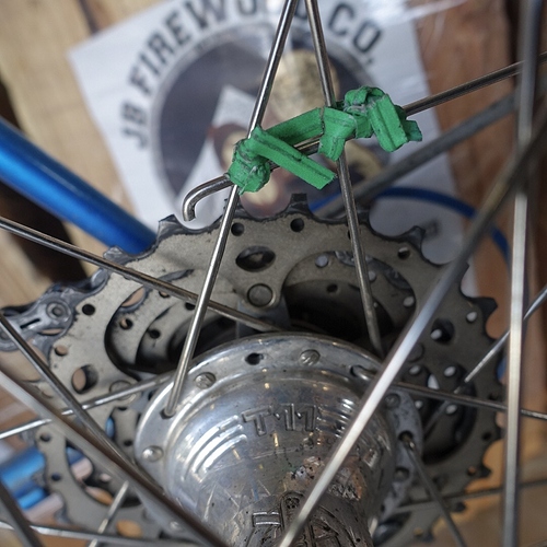

Well now I am up to my 3rd broke spoke on this wheelset. All spokes were driveside rear at the flange head.
This time it was 40 miles into a 130 mile ride. Miraculously it was wobbly but not wobbly enough to rub the rim brake pads nor the fenders so I found some twist ties at the open control grocery store and made do.
