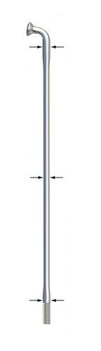

Last spokes I ordered were from these guys:
These dudes are a little cheaper, though:

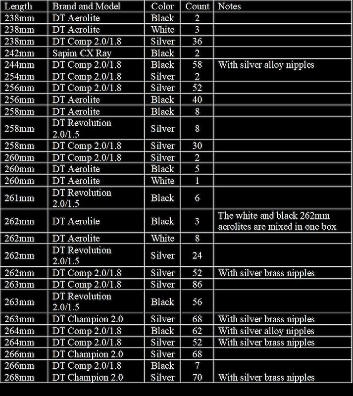

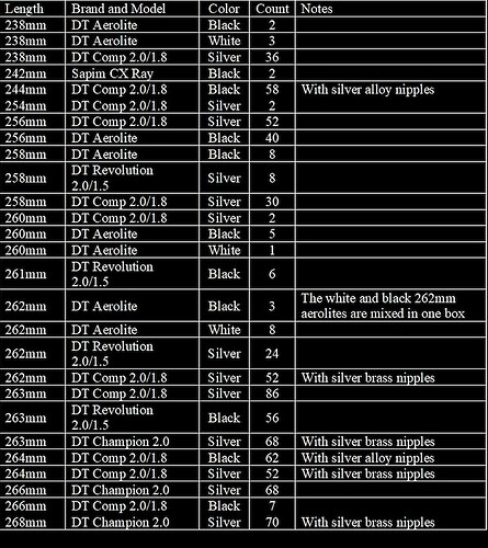

Think I could get away with 262 on the DS even though the measurement is 261.4?
Yup
lol is this your personal stockpile?
No-but-yes. It was a friend’s stockpile, I bought it from him.
Lots of deadender sizes (or deep rim sizes I guess).

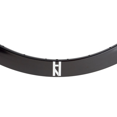

Alright I’m going with deep bois. SL42s are lighter but narrow…going with heavier but less narrow eeros. DT champs w Squorx nips.
3x both or radial front?
Those rims are stiff AF (in a good way). I have some 16-hole ones that feel great and the weight was never noticeable.
