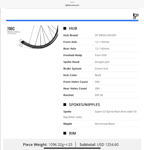

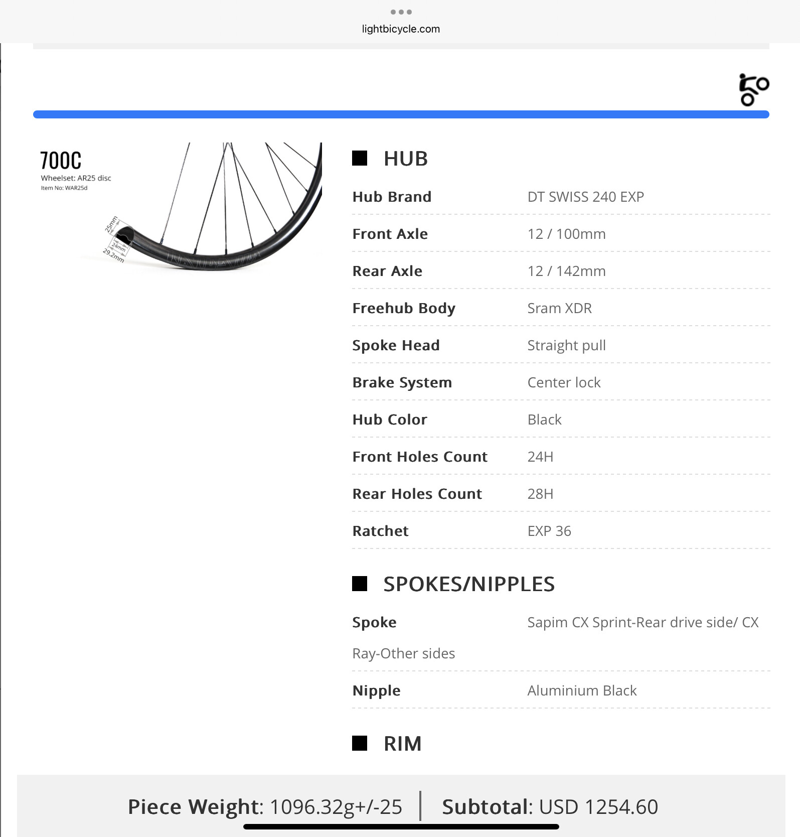

I just checked and if you order wheels from the NA warehouse, LB will build them with Berd polyspokes if you wanna pony up the cash :money_mouth_face:
for lighter faster second wheelset for c/g, 700c- what rims should i get? 24h, probably dt350 front and rear (although who am i kidding it’ll probably become the wheelset that spends the most time on there so i should probably dynamo it anyway)
This is in my cart, maybe if tax season goes well this year :crossed_fingers:
thats fucking light. do be mindful that the max pressure is 70 psi on those rims
They’d be wearing 32-42mm tires, max I’d run would be 50psi👌
