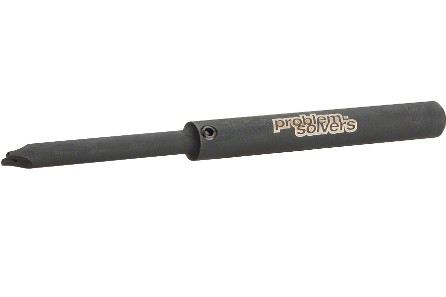

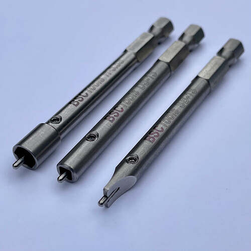

Anyone come up with a clever nipple shuffler, but for ENVE nips?
And one of these, but for the same nips?

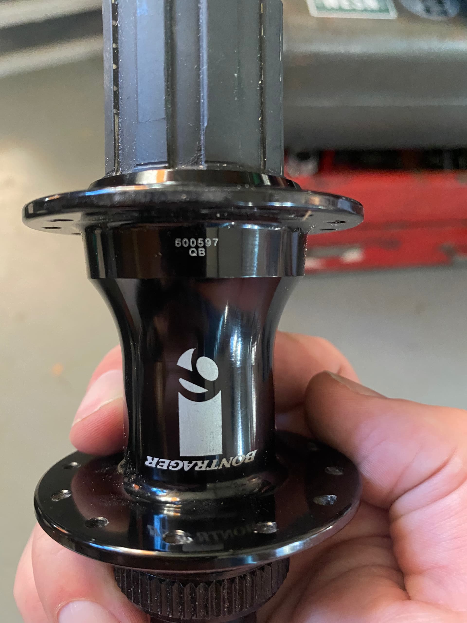

I have this hub
Do replacement cassette bodies exist?

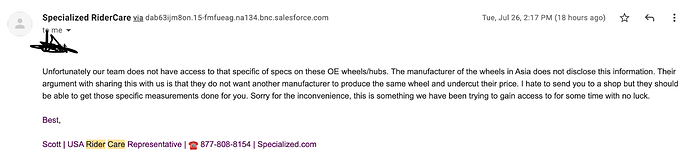

Tried to get hub dimensions from Specialized:
Unfortunately our team does not have access to that specific of specs on these OE wheels/hubs. The manufacturer of the wheels in Asia does not disclose this information. Their argument with sharing this with us is that they do not want another manufacturer to produce the same wheel and undercut their price. I hate to send you to a shop but they should be able to get those specific measurements done for you. Sorry for the inconvenience, this is something we have been trying to gain access to for some time with no luck.
sounds like you need to get some detailed measurements and then produce the same wheel out of spite
my brother in christ, you sell the wheels!
if your team has “been trying to gain access” to the measurements “for some time”, you could simply take your own advice and take one off the peg to measure yourself!

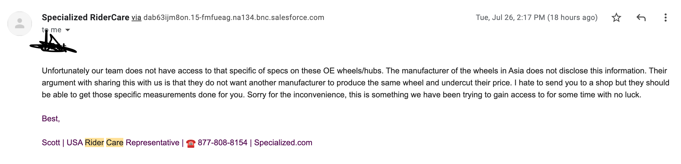

Amazing. Would be great to have as an email screenshot rather than a copypasta (for re-posting elsewhere).
that shop is going to freak the fuck out when they hear about digital calipers
@iwillbe this is Big S, even, not the shitty ebike shop
honestly I appreciate the effort they went to to go to no effort
