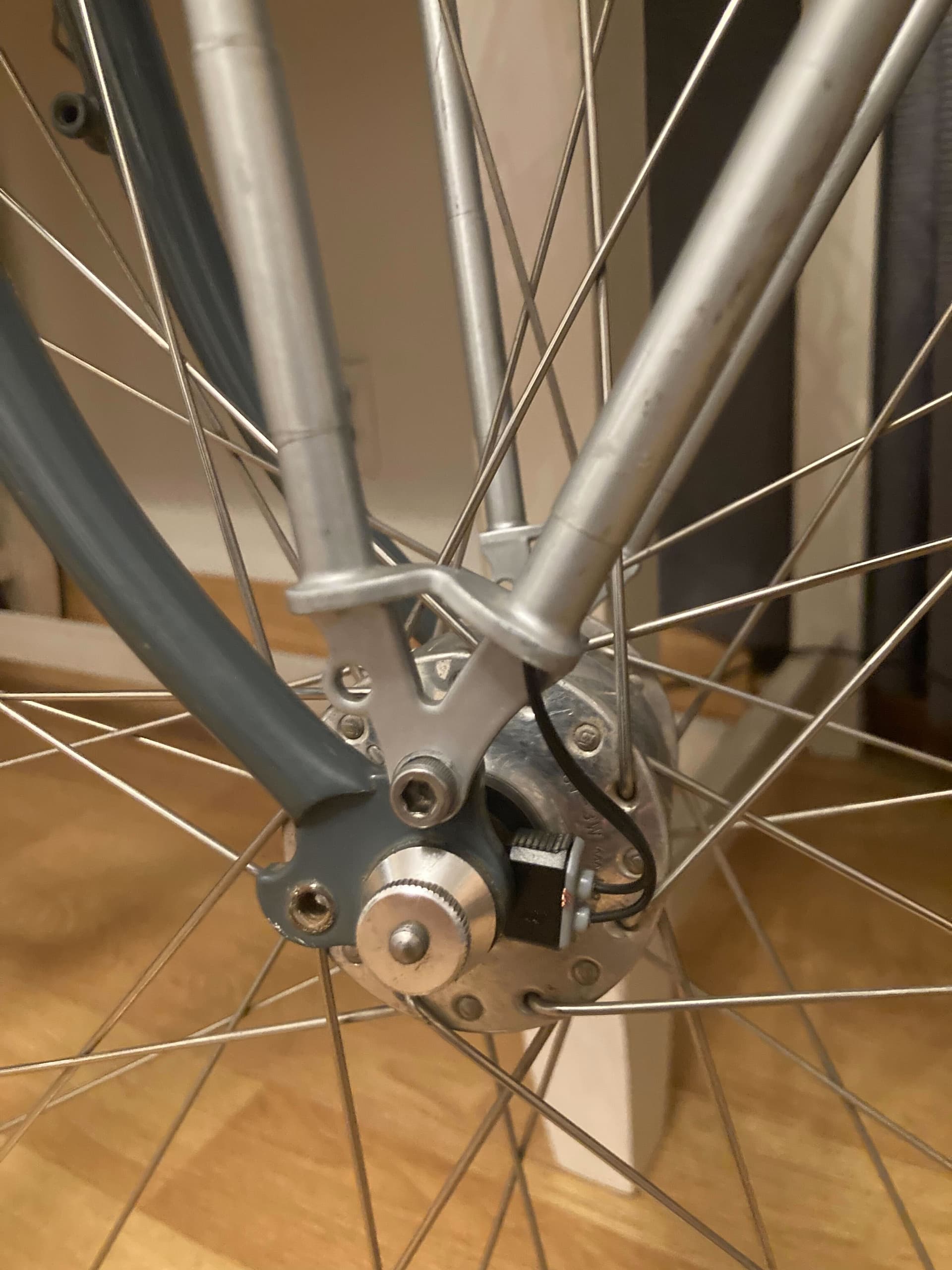

2 questions;
  1. Does the Shimano lego brick work on a Son hub as well? Not really stoked on wheel removal and 2 loose clippies.
  2. Any way to fit a 15x100 Son hub to a qr?
Feel like I remember these being answered, but can’t recall the answers.
  1. It doesn’t
    However the two loose clippies in practice are easy to deal with
    And son have a kit to convert them to coax pluggie if that is your desire
    I have both setups on different bikes and they are fine.
It does, you just have to bulk up one side to take up the slack
As for TA → QR, there are adaptors.
Oh wow :astonished: what is used for bulking?
I’ve heard electrical tape and sugru

@jeffro went absolutely hog wild with this a few years ago, right? custom connector plates in the dropout?
Talbot in the UK has done conductive paint rather than wiring
I think @Andrew_Squirrel had a whole lot of elegant applications of commonly available cabling and cable interface stuff going on with their various bikes.
I, too, get a-dithering when this comes up. 4 bikes wtih dynos and counting…
there were some breezers (?) with SON hubs set up to route power through the axle ends to a conductive plate in the dropout. iirc jan heine was involved somehow. Some tarckers got the wheels on closeout
Yeah, SON sells a special hub and conductive dropout plates for your framebuilder to build into a fork. As I remember it, Wiggle blew out a bunch of those hubs a few years ago and various folks here snapped them up and dithered together out ways to create the electrical connection at the dropouts without building new forks.
Yeah, I was working for Canyon at the time and they were definitely extra stock for the weird urban bike they made and didn’t sell very well.
Dis one
https://nabendynamo.de/en/products/sl/
Standard SON model, not a hienyism
Also I think paragon makes the fork ends
