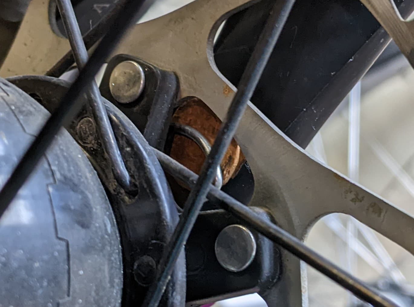

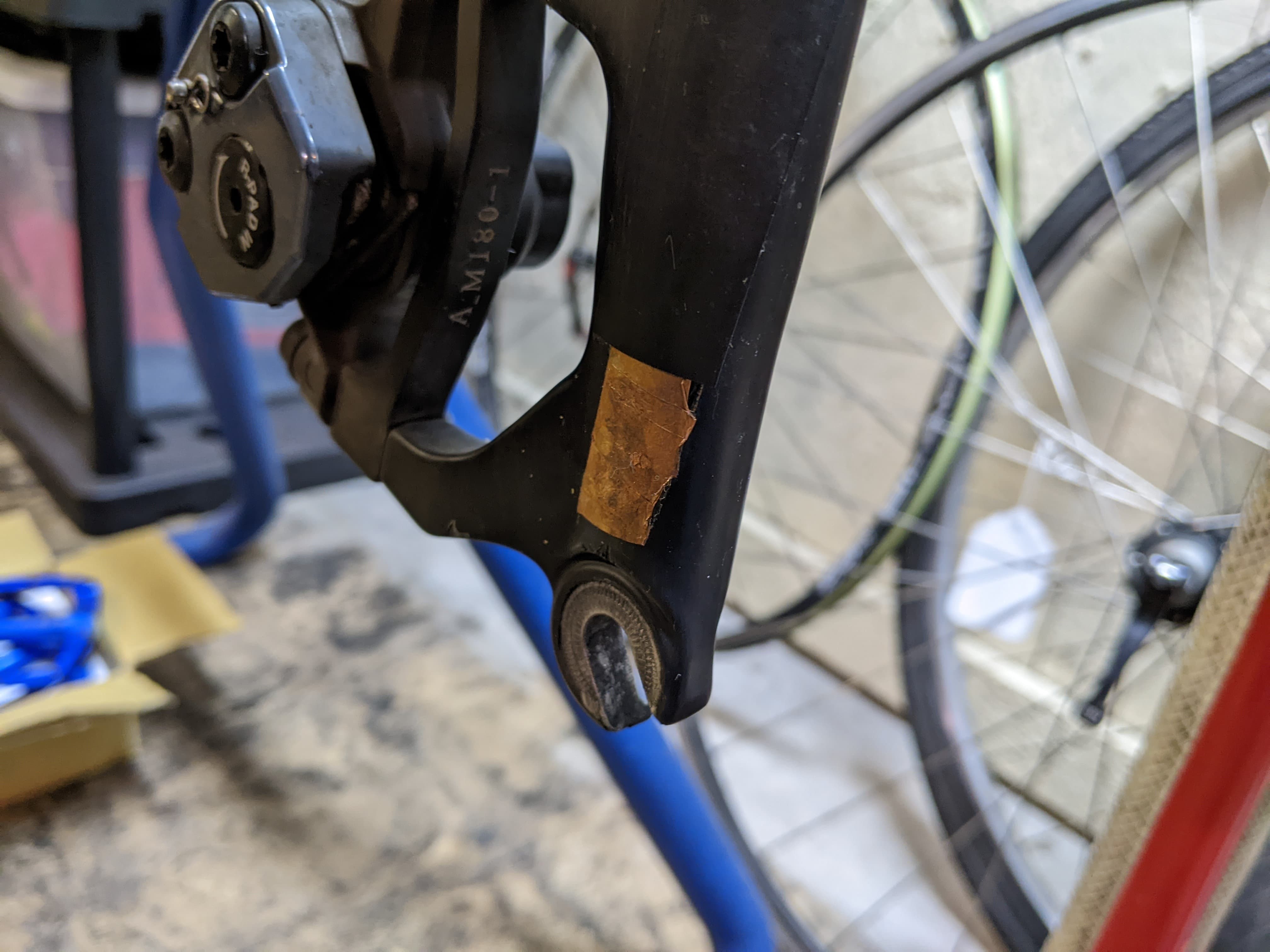

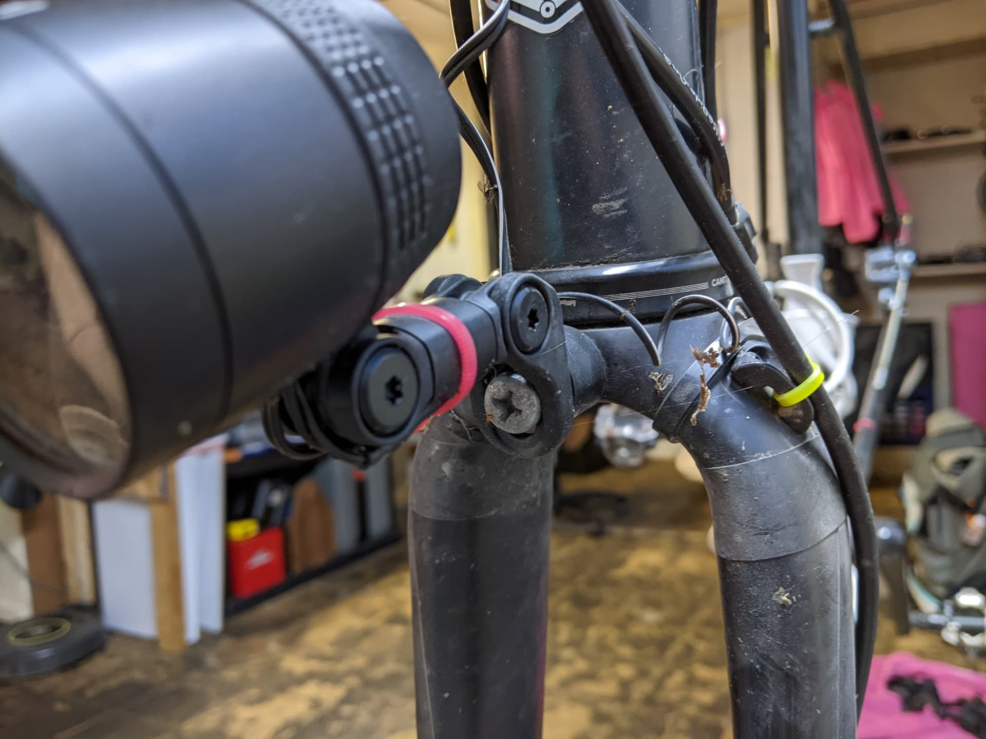

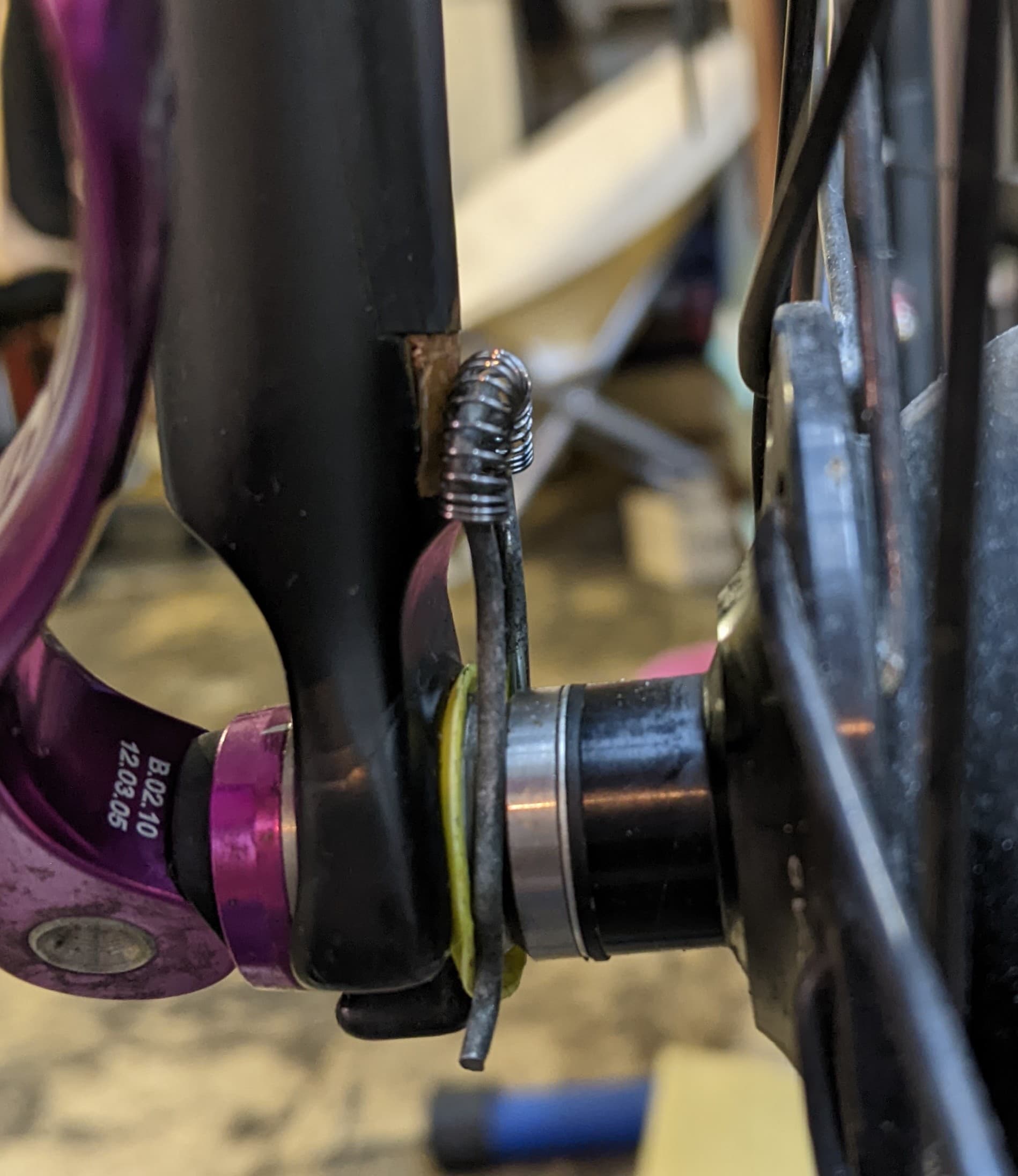

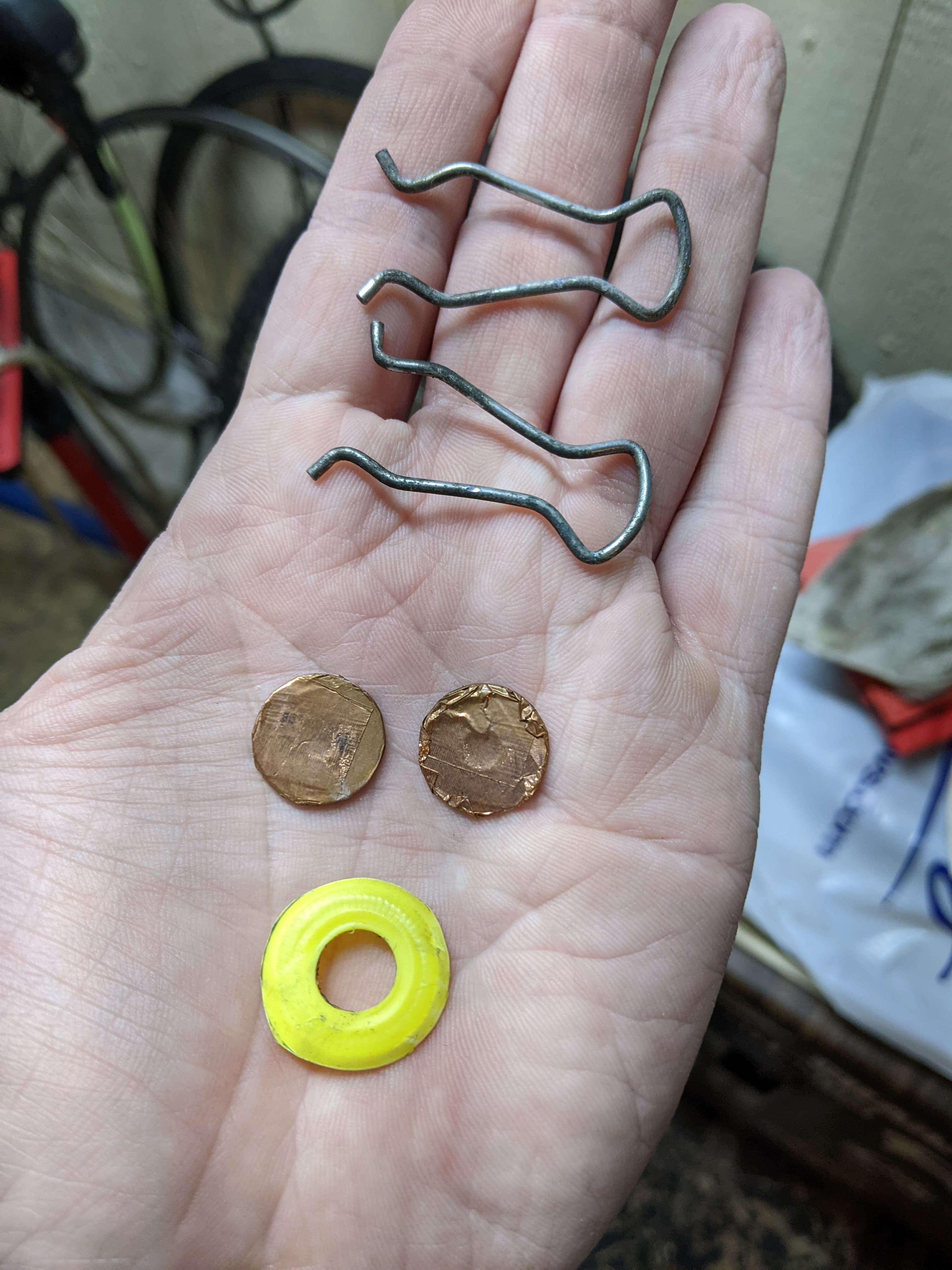

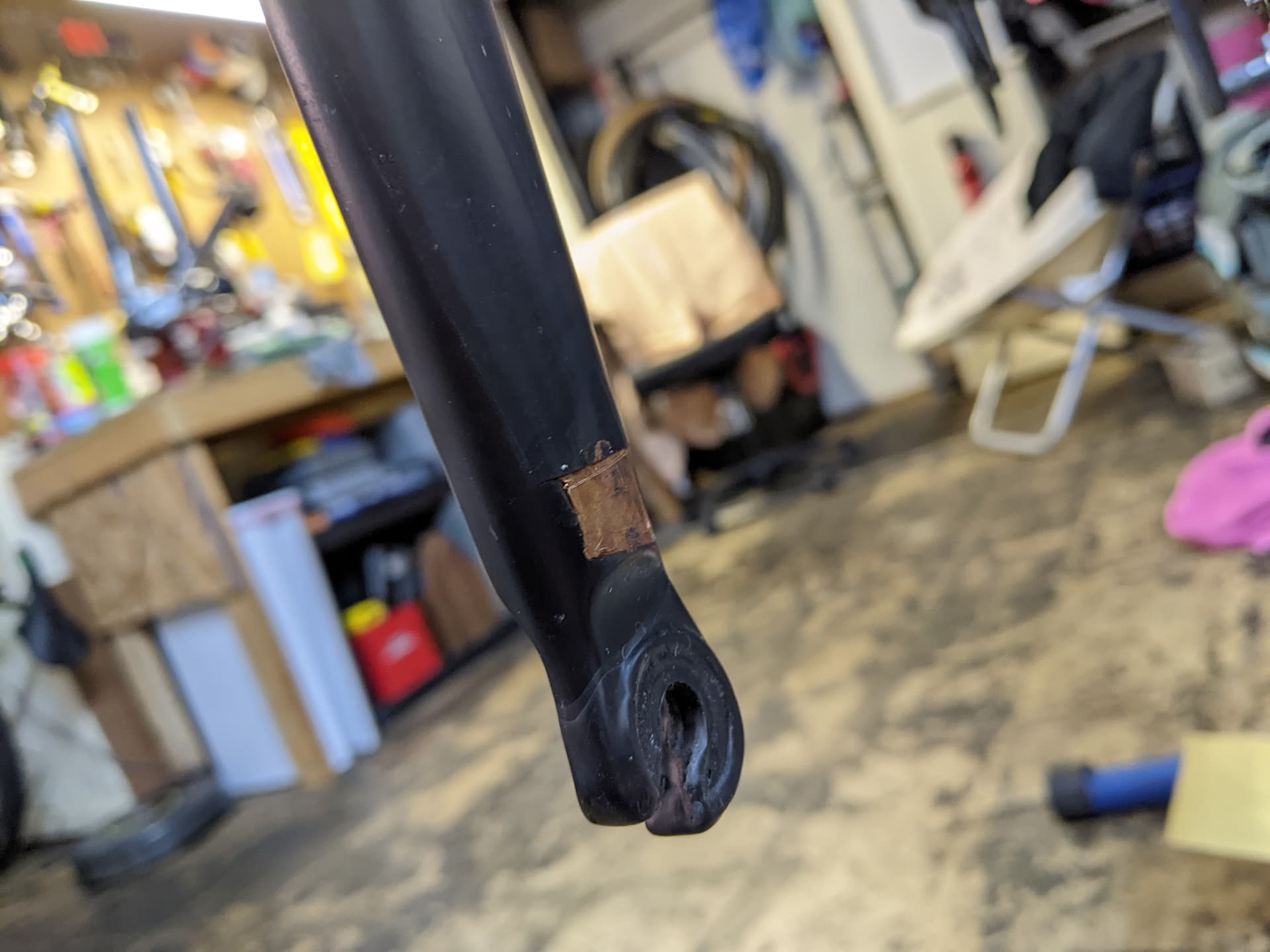

Indeed! I ran copper foil tape down the fork legs, nearly to the wireless SON hub. And I fashioned wire clips that snap onto either side of the hub, standing up tall enough to touch the leg tape. Also used a plastic washer cut from an OxyClean lid to insulate the hub from the dropout. I can post current pics if anyone needs help. It’s worked way better than I expected.

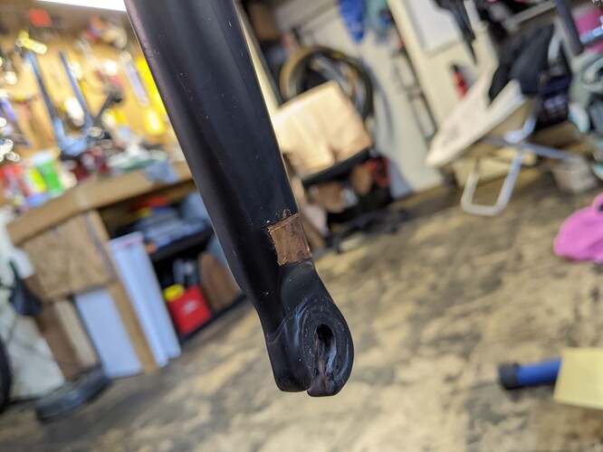

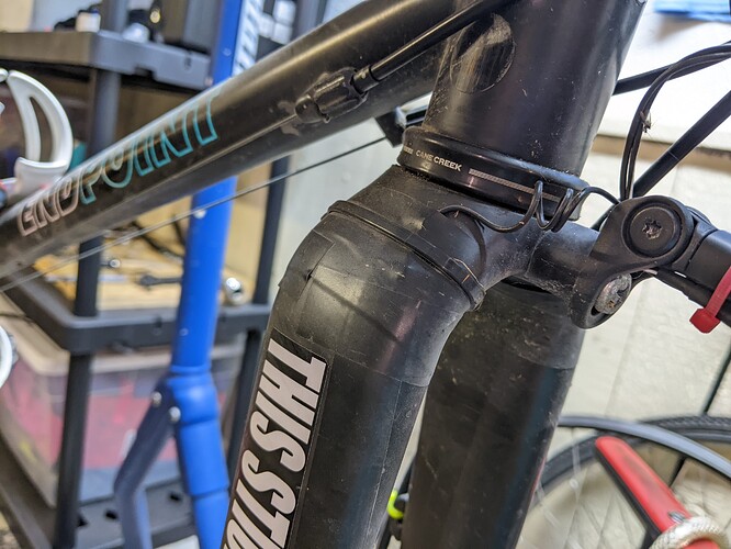

Most of the copper foil tape is now buried under electrical tape, but there’s a bit peaking out at the bottoms of the fork legs. You’ll get the idea.

Update! It occurred to me just now that ballpoint pen springs may be the better option for firming up the power clip contacts.

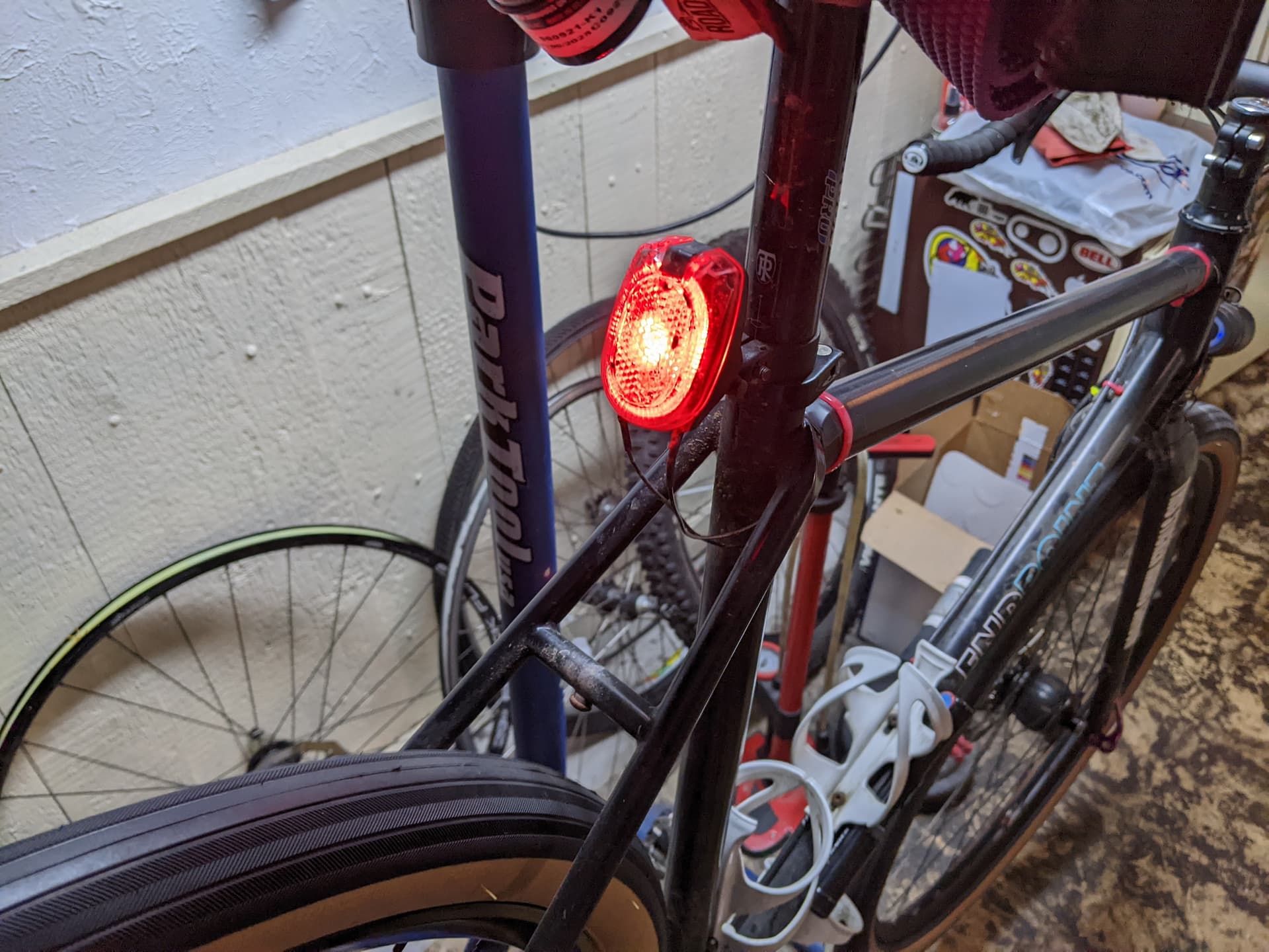

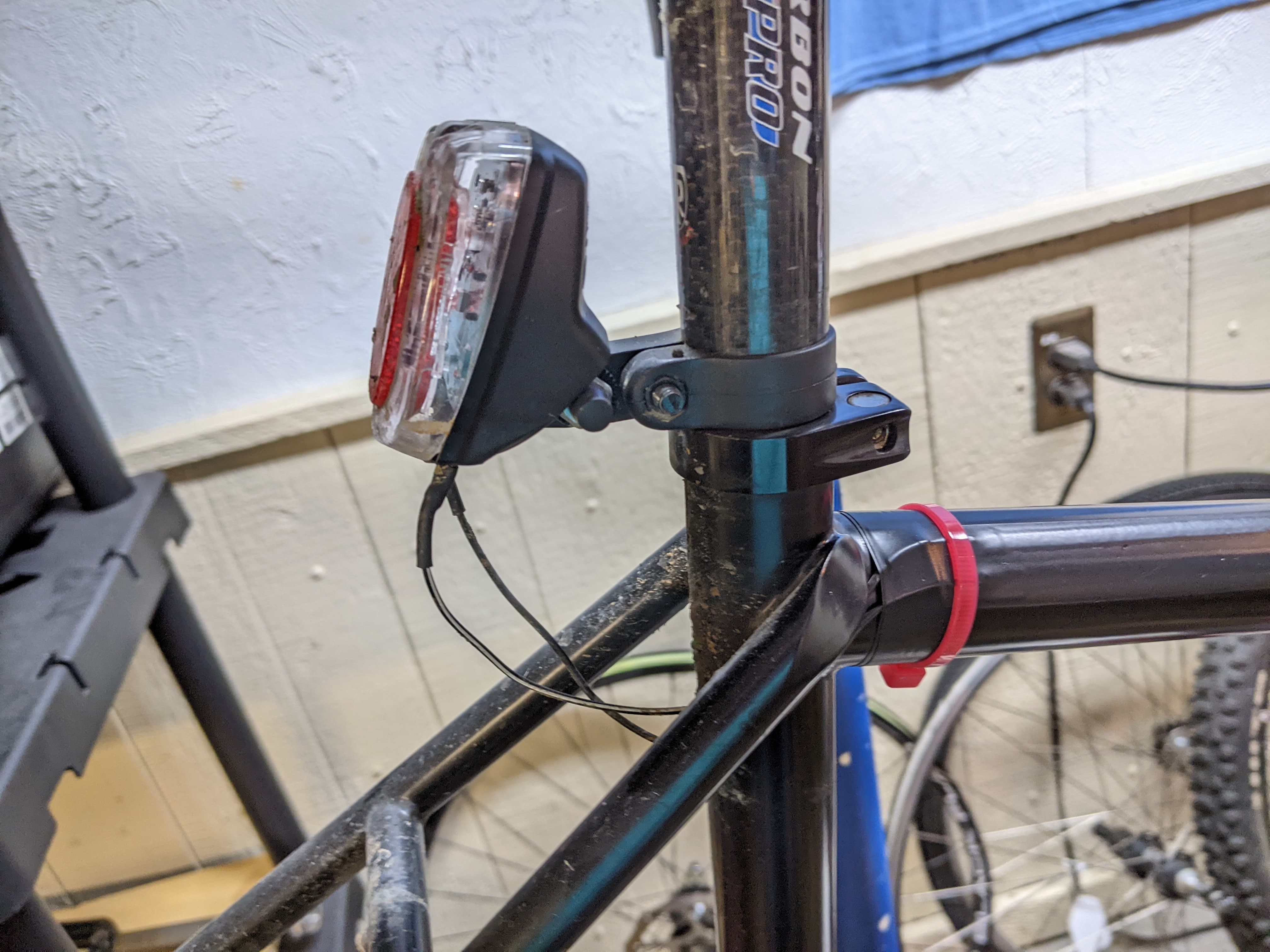

I’ve considered using copper tape along the top tube for the rear light connection. Any tips/words of warning? Did you just solder the wire to the copper tape? Do you have to cover it all with electrical tape?
I didn’t solder anything, just sandwiched the wire between two layers of copper tape. The copper is pretty fragile so I covered it with e tape. I have a zip tie over the wire/tape junctions to keep them smushed together. That was supposed to be temporary for proof of concept, but it’s worked well enough that I haven’t changed it.
