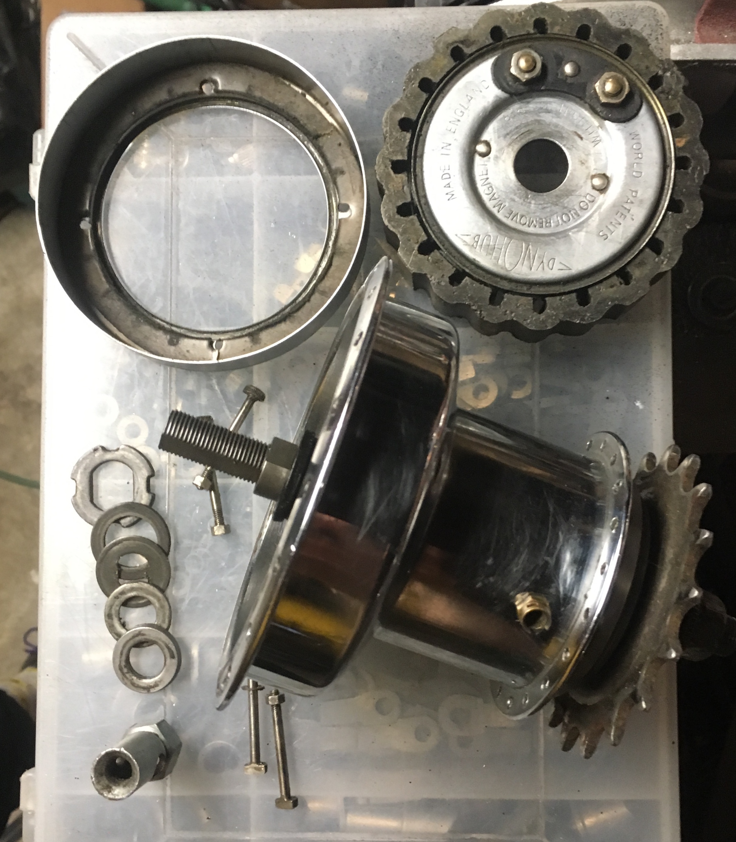

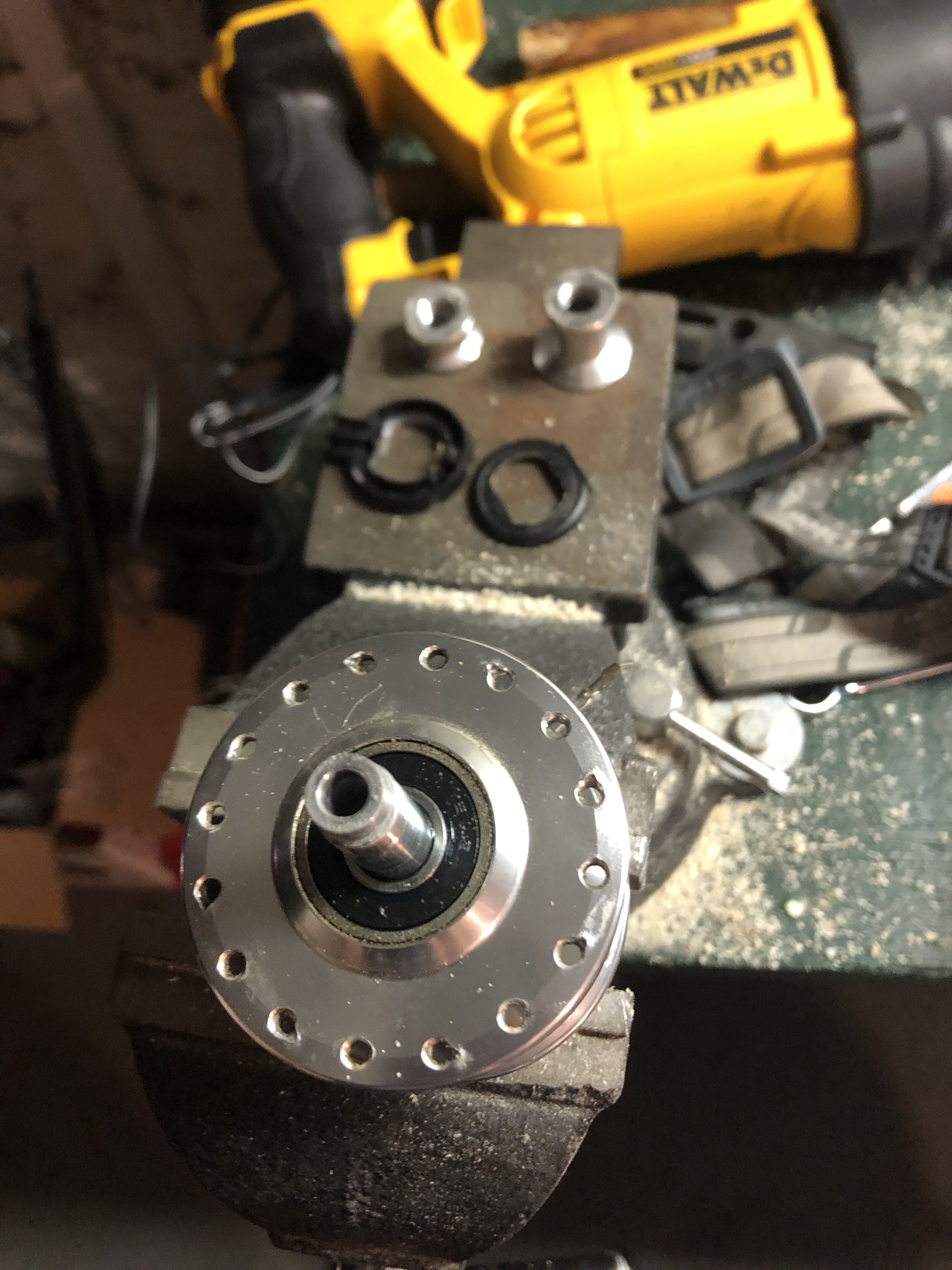

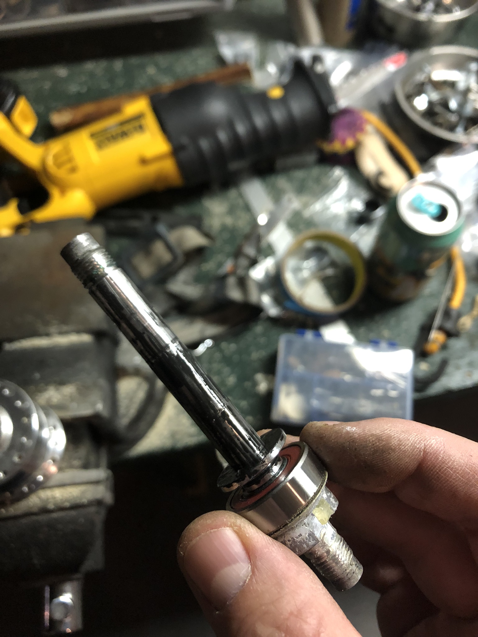

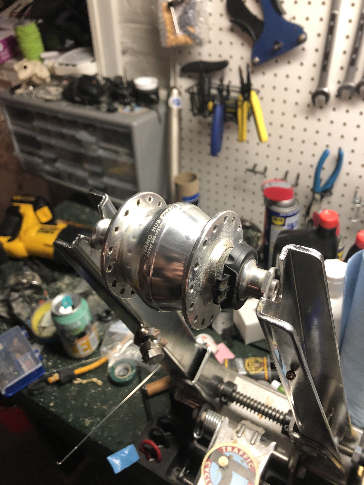

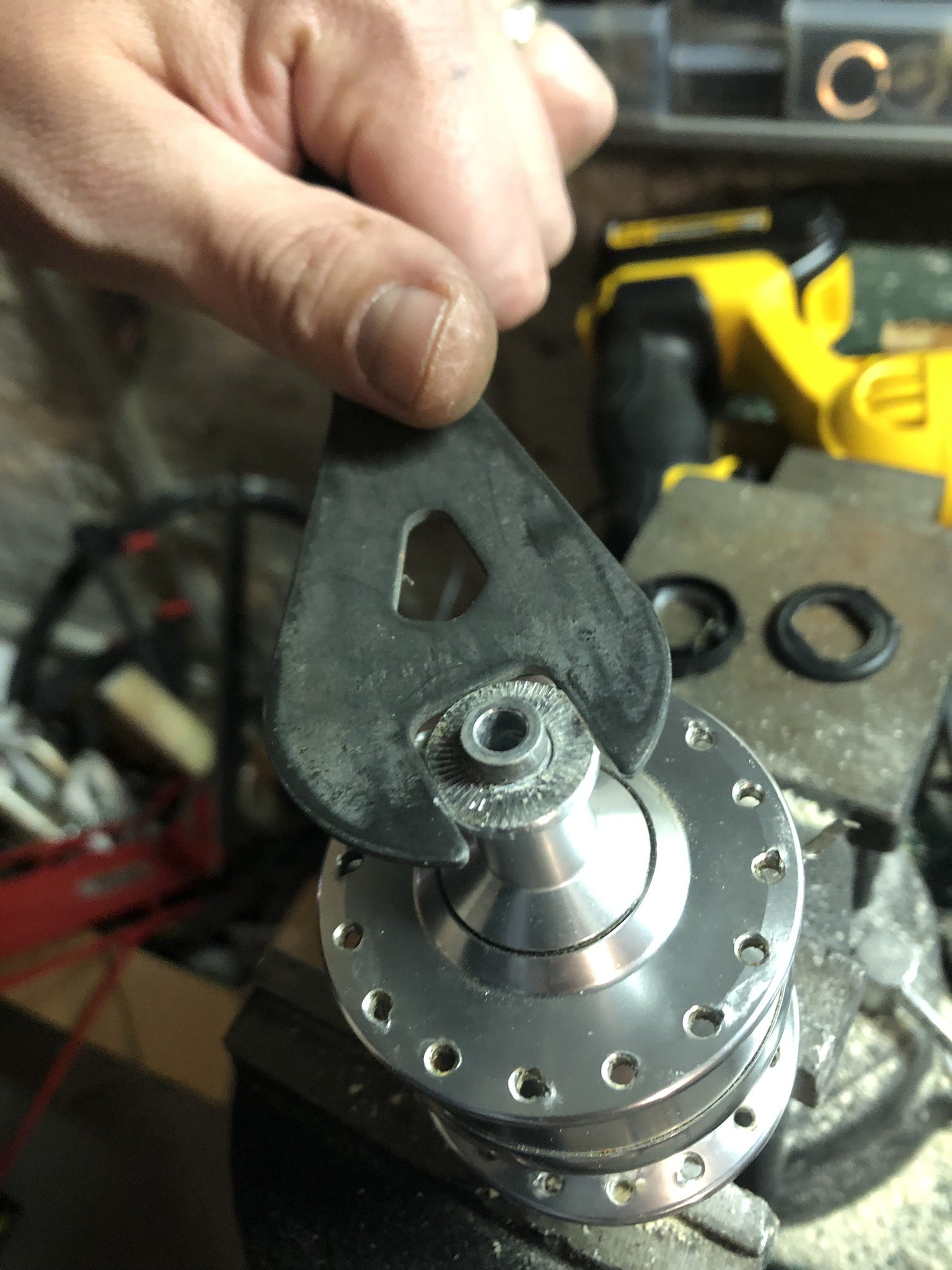

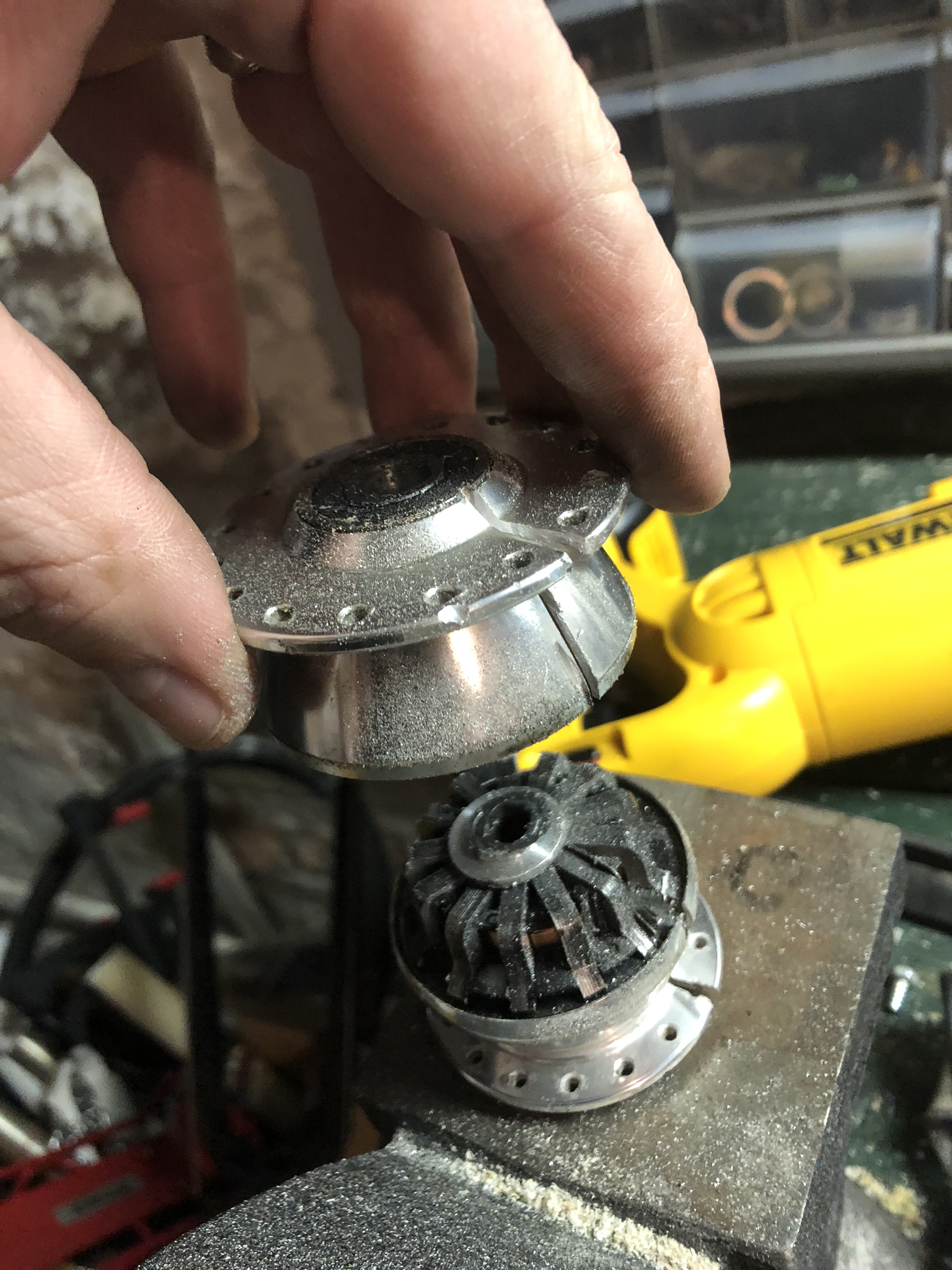

I got a cheap seized Sturmey AG a while back, and decided I’d unbolt it this morning to see what was making it lock up.
These early industrial age hubs might weight a ton(ne), but they’re pretty easy to repair unless someone drives a spike through the rotor windings (this one was seized because the dynamo is filled with grime. Easy enough to repair; easier than repairing the last one, which had rusted solid and had to be wirebrushed clean before the rotor would turn again.)
Are these the ones that you need a 'keeper" when you take them apart or the magnets lose their juju

Yes. I made a keeper out of strap iron when I took apart the last one, so all (fsvo “all”) I have to do is find it and then I can pop the rotor for cleaning.

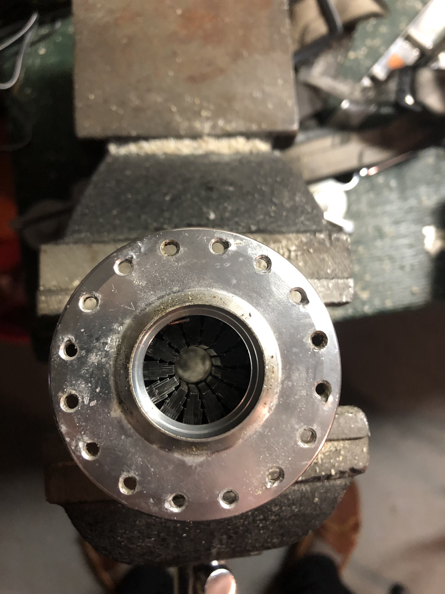

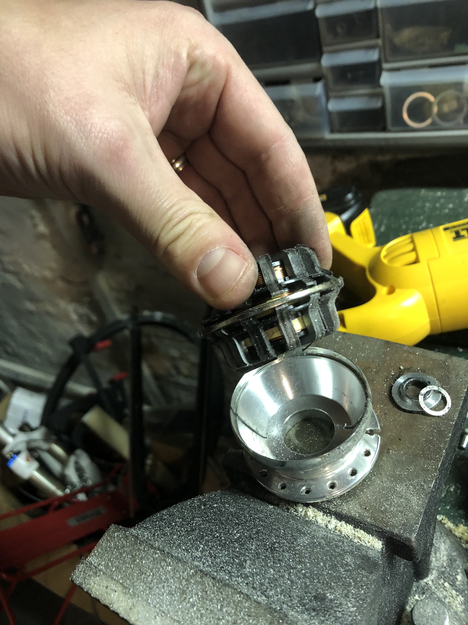

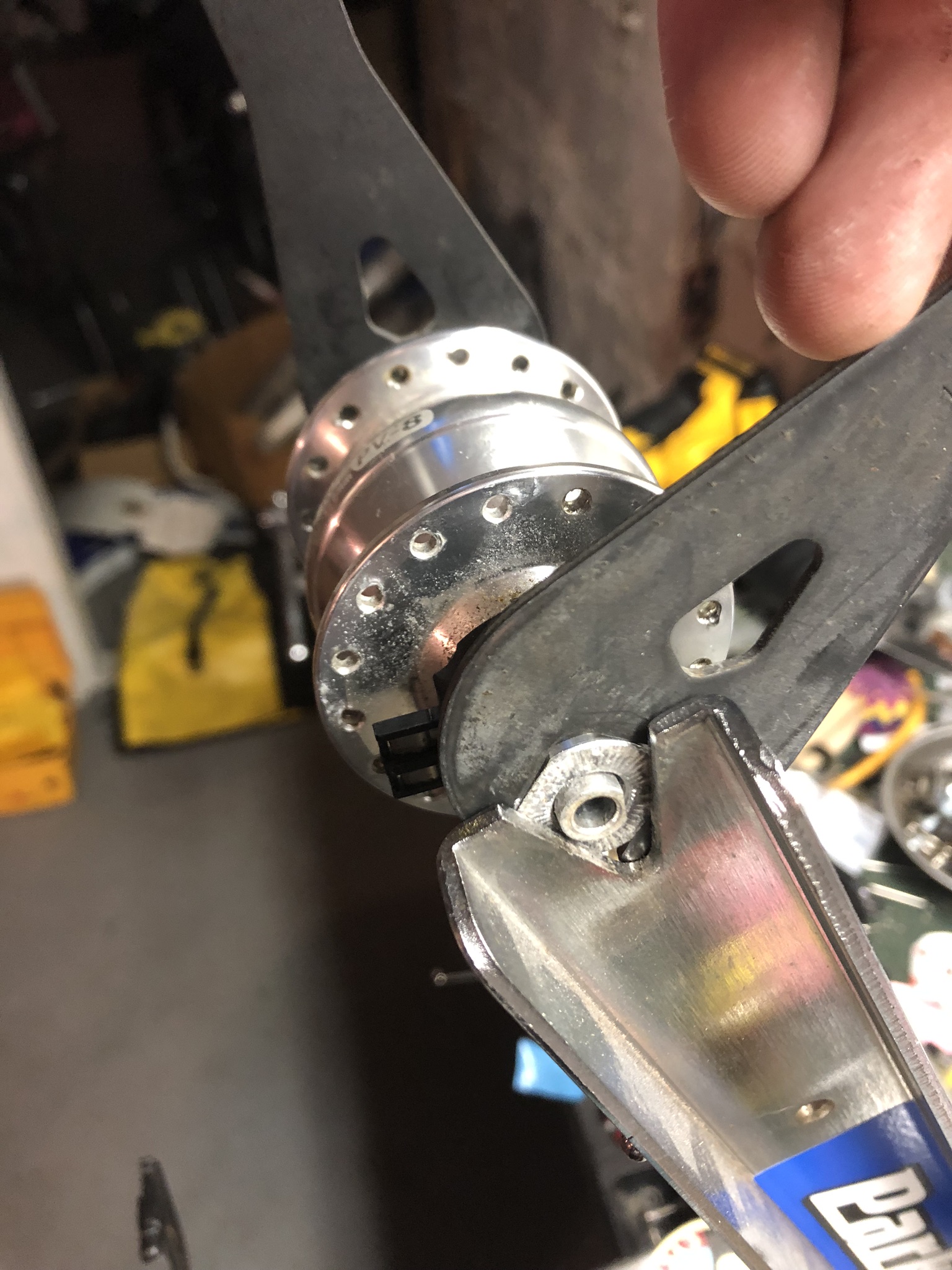

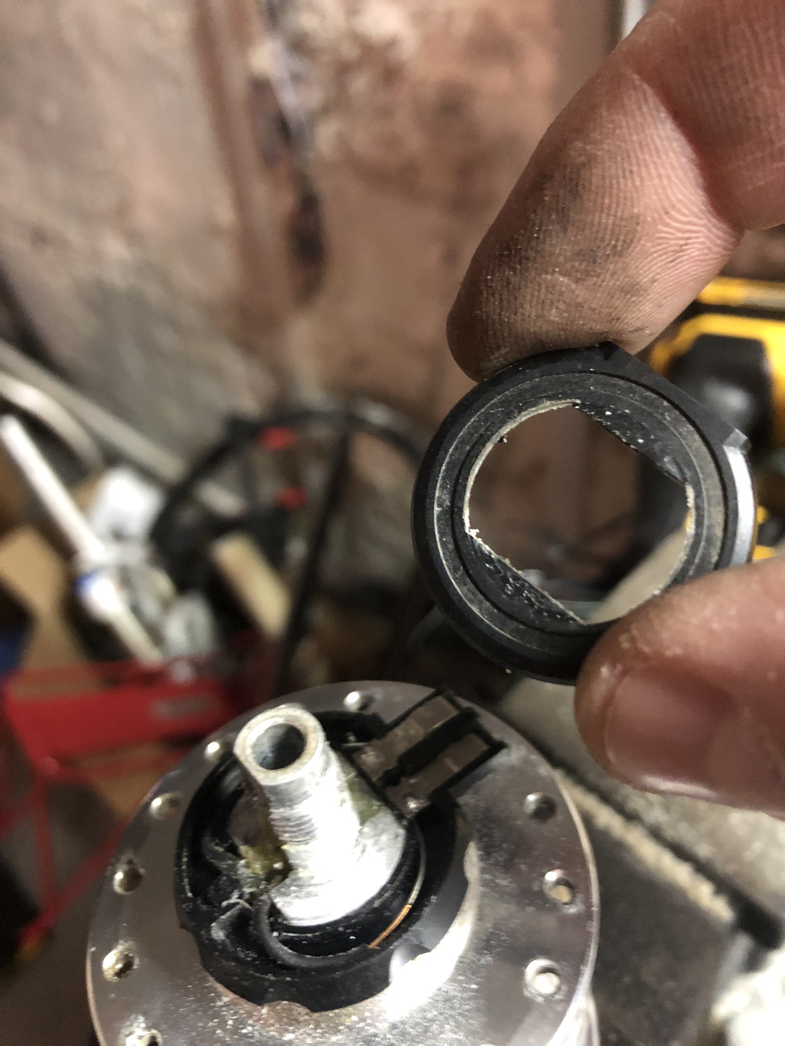

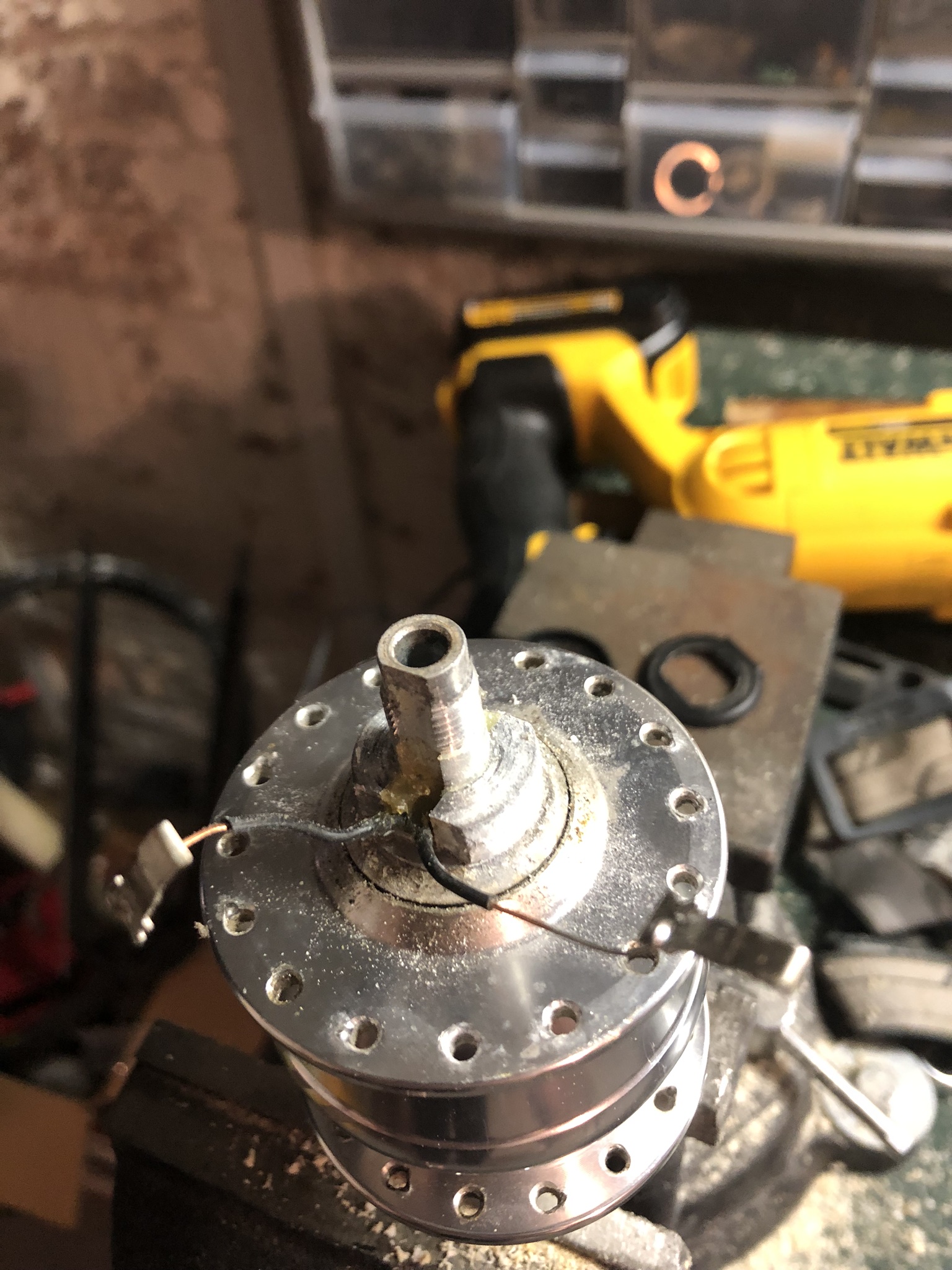

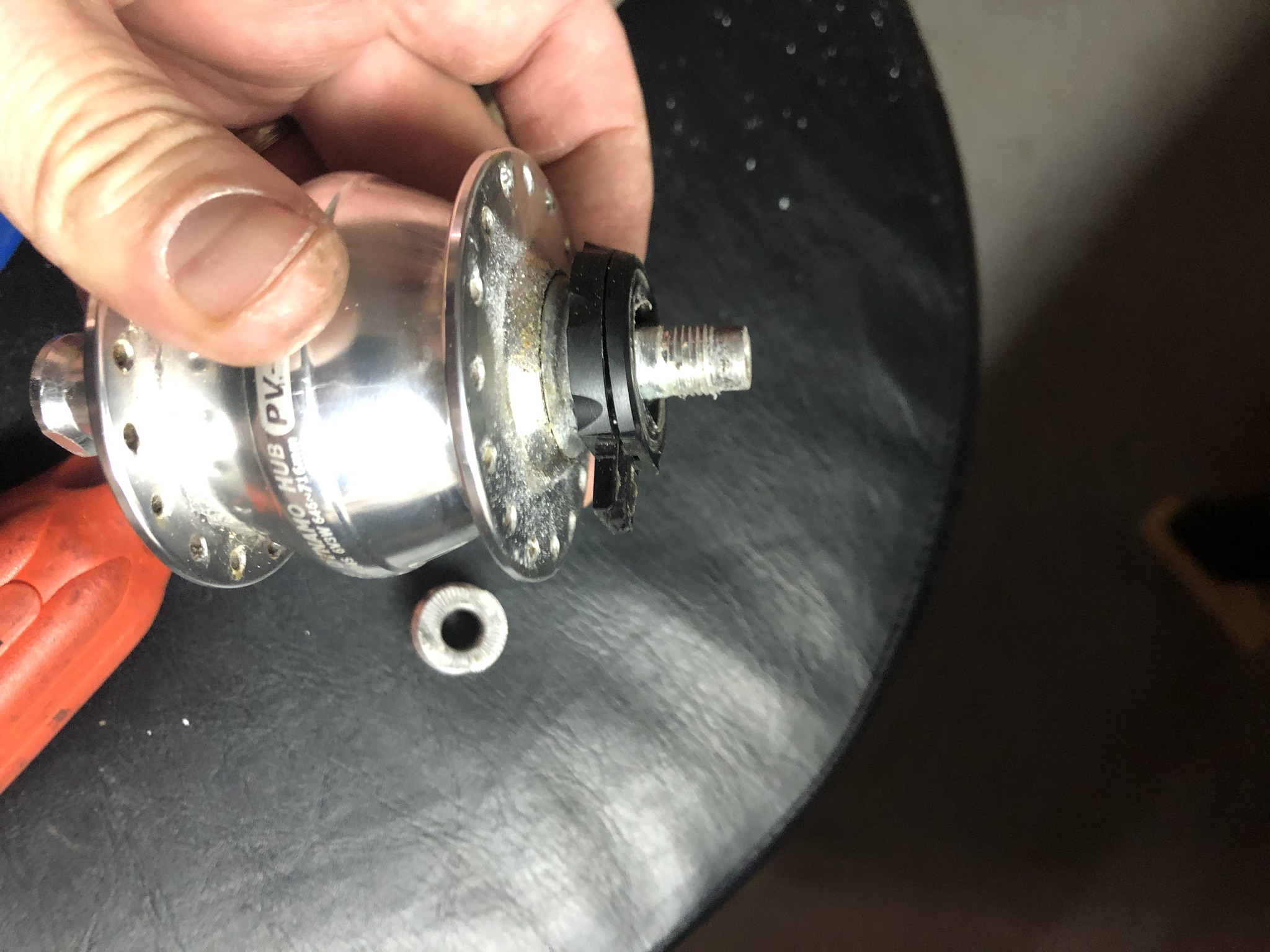

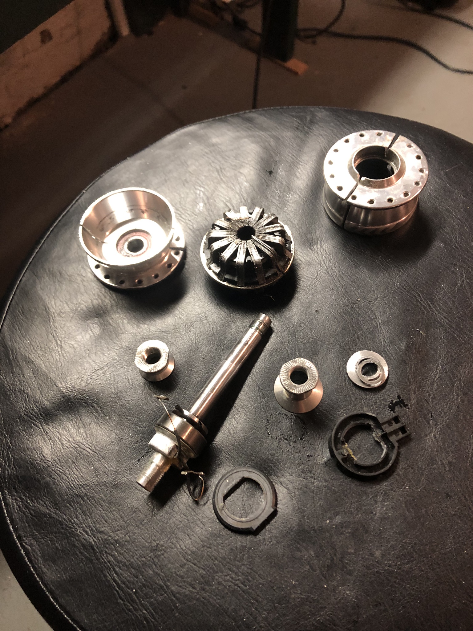

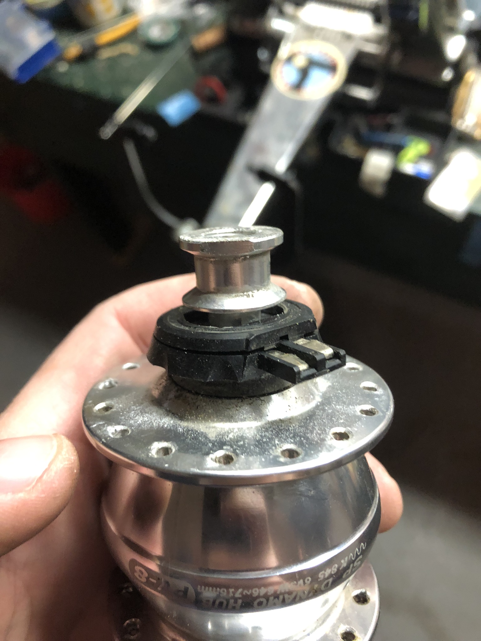

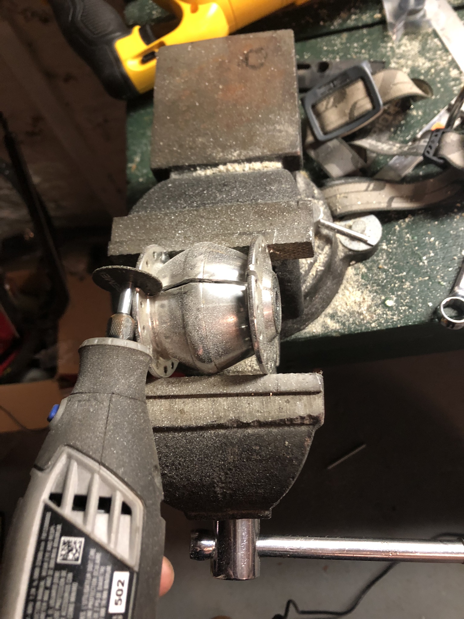

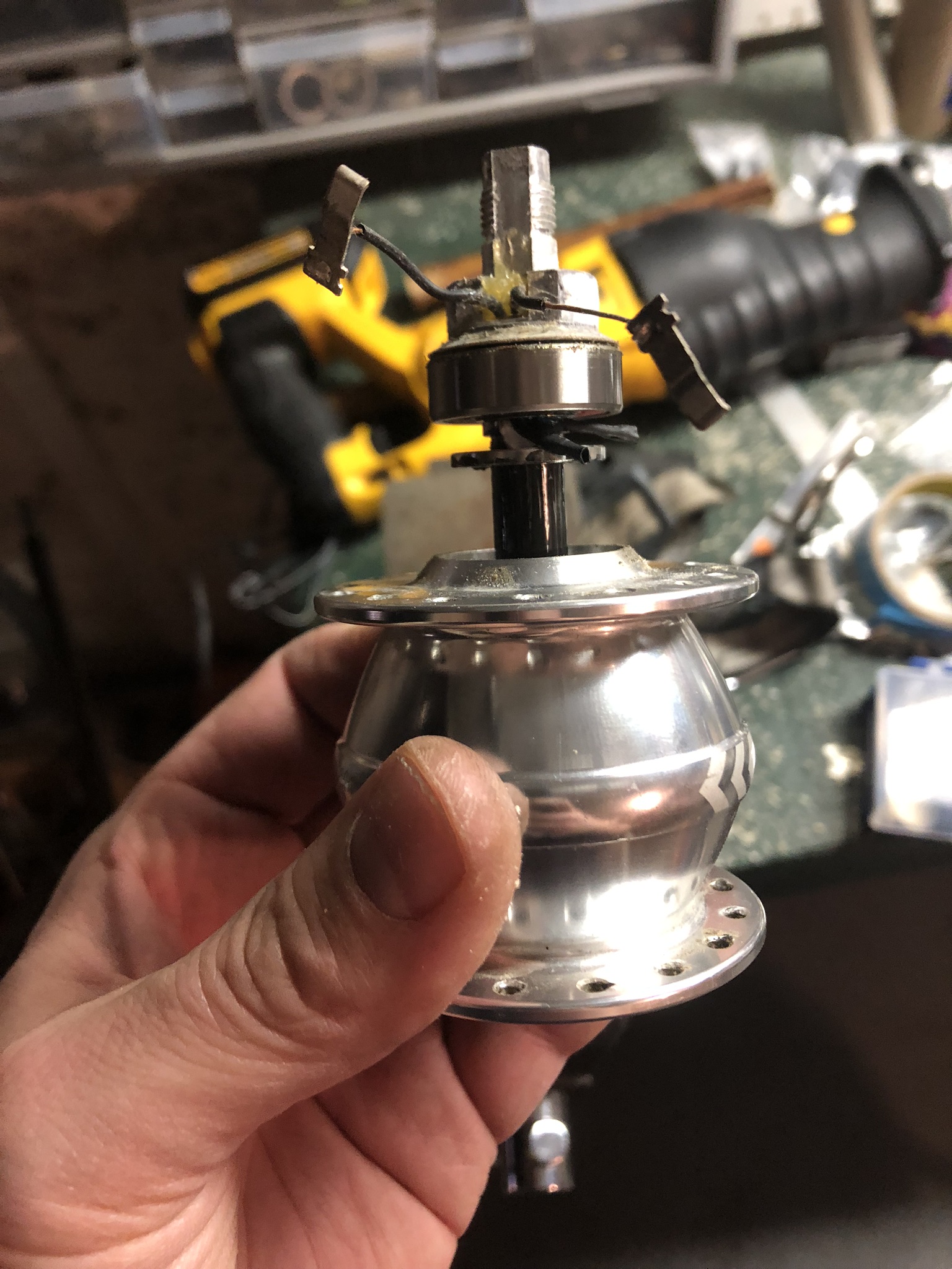

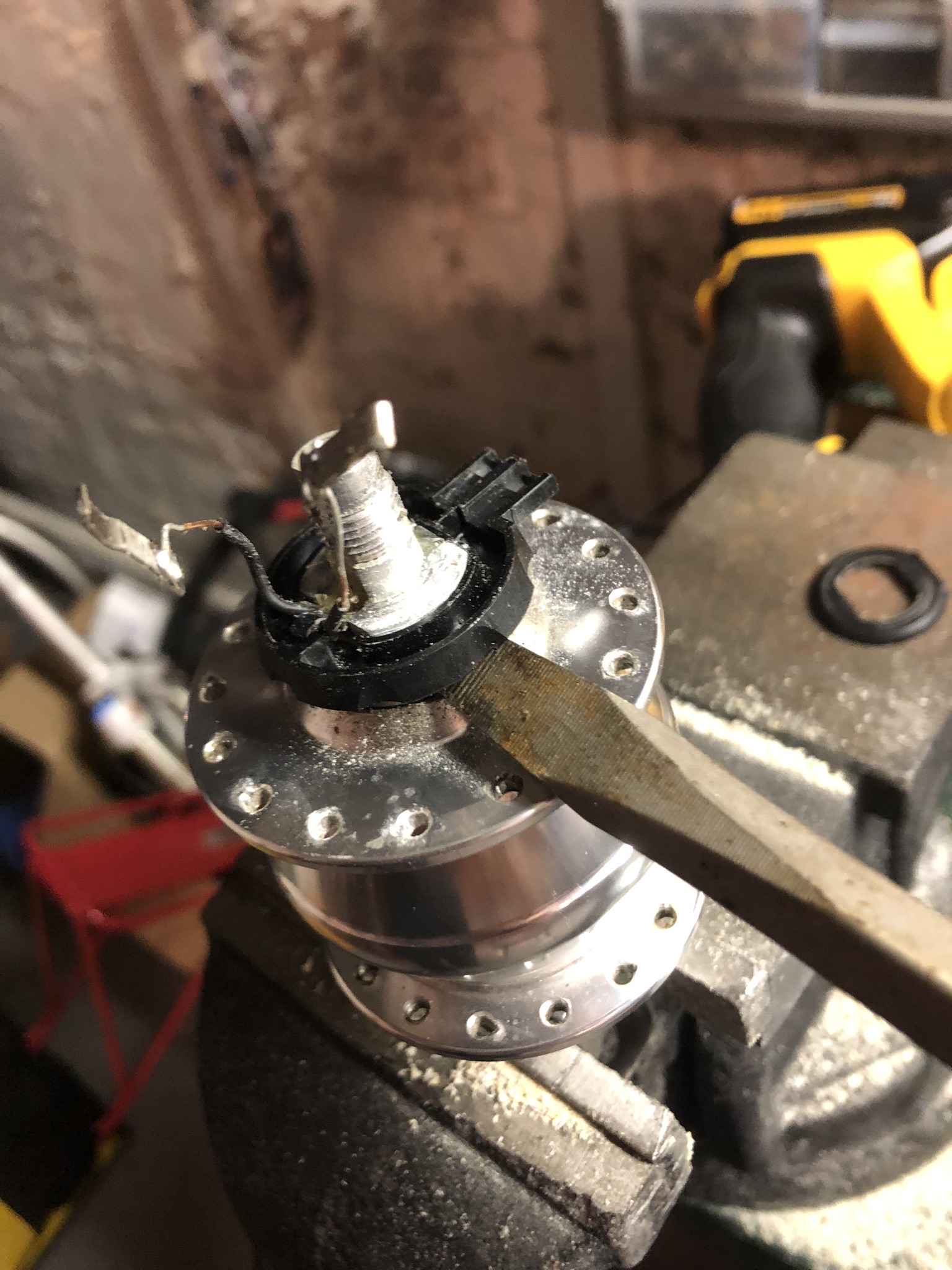

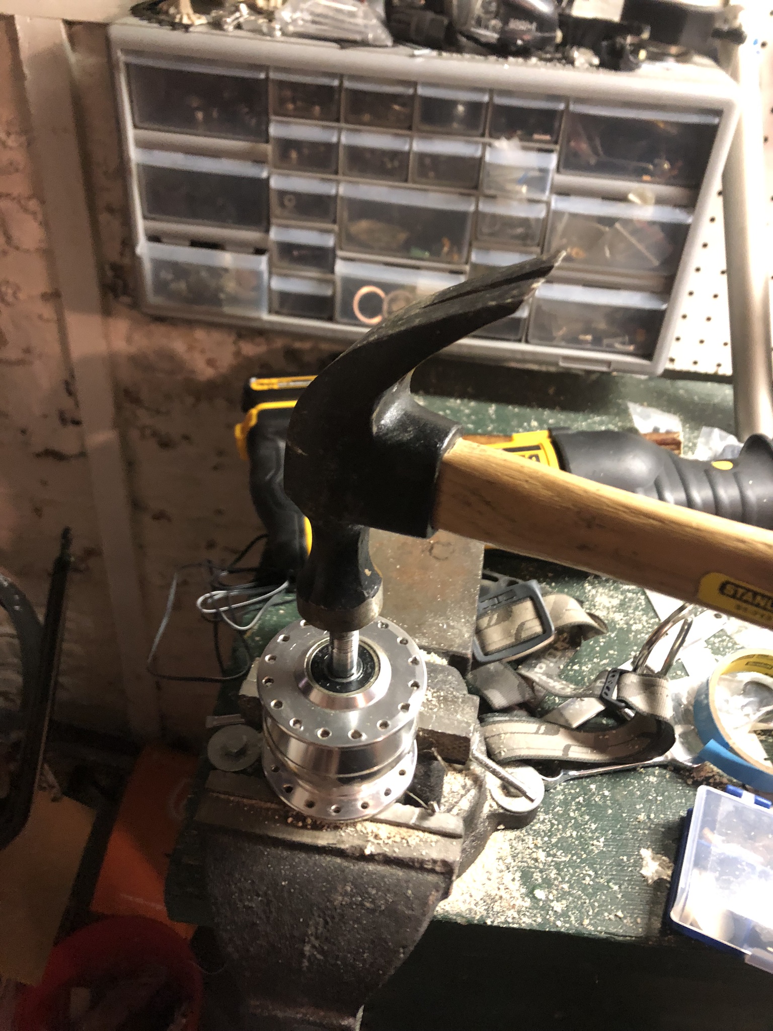

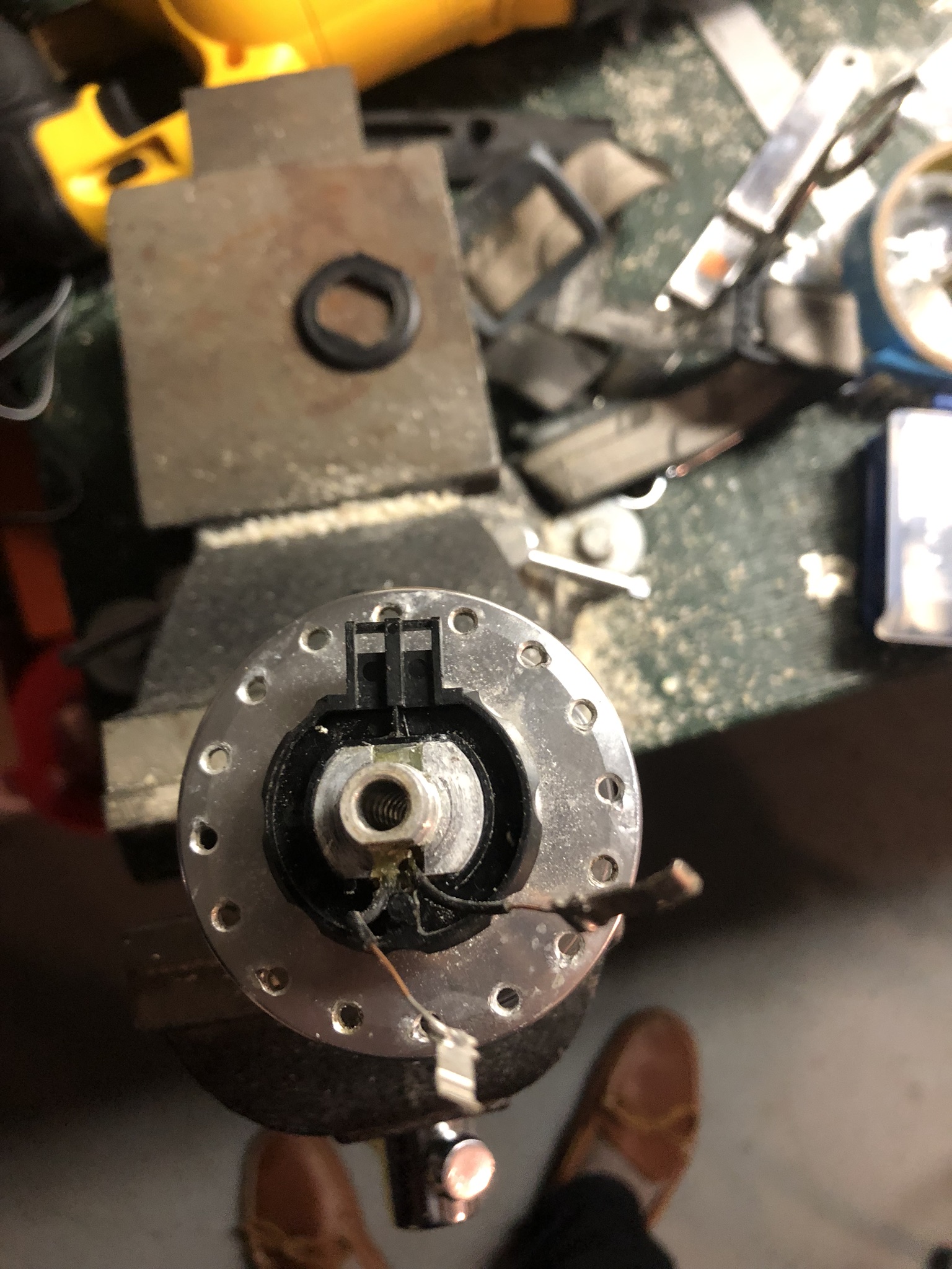

I unbuilt my wheel with the dead SP and destructively took the thing apart. The wires that connect the inner dynamo bits to the terminal were broken.
nice! I should do this to my dead SP, the bearings were shitting out and eventually (probably due to water ingress) something froze to something else destructively and the wheel totally locked itself up. when I got on and rode it for about 10 seconds whatever it was broke free and the hub spun but stopped making power. :colbert:
:heart::heart: Thanks Rusty
