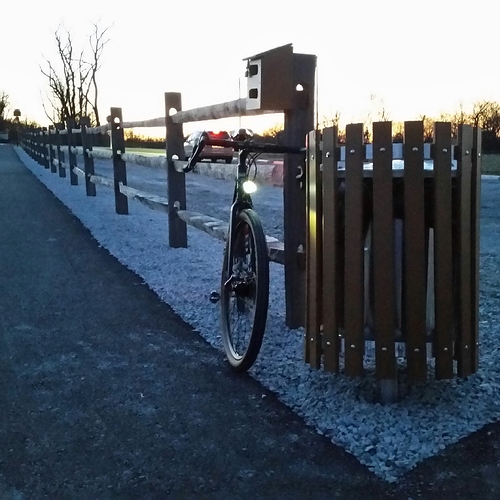

OK, three rides in and the tape dyno is working great. I’m calling it a succes.
