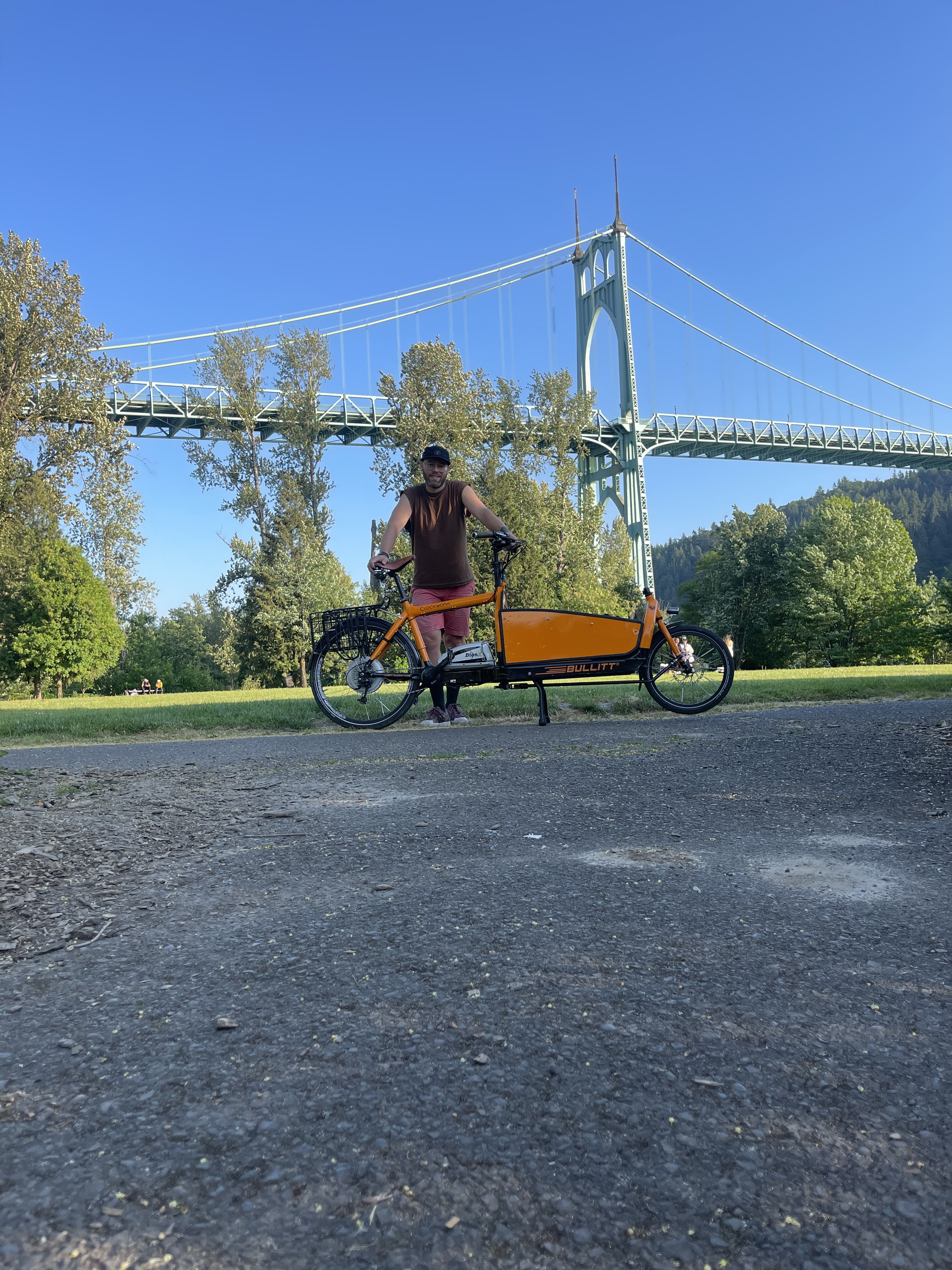

This last week I’ve put about 150 miles on a vintage BionX e-Bullitt, it’s on its 2nd battery and original rear wheel. I love it a lot and am having nostalgic fantasies of circa 2011 when I was going to tour indefinitely on my naturally aspirated Alfine 8-speed bullitt.
Here’s my old carry-shit:
So that orange bike above is a rear-drive and I’m guessing it’s not so good in foul weather? Has anyone tried adapting their own rear-drive system like a bafang? It seems like the price more than doubles for the -ebike version real quick and it’s a only a 250-watt 65Nm system…

Shifting is pretty normal on my torque sensing bike. I think the cadence sensing bikes can have shift sensors that cut power when you shift but maybe they don’t all have them.
Rear drive is probably fine in foul weather assuming it’s not some super powerful hub motor that hasn’t had some tuning (max power or current limited).
There a lots of kit options out there for probably as much as you want to spend. Grin Tech / ebikes.ca would be a good place to start researching kits/parts/etc if you want to go the hub motor route.
all your weight is already on the rear wheel im sure it’s fine until you get into the high watt motors
