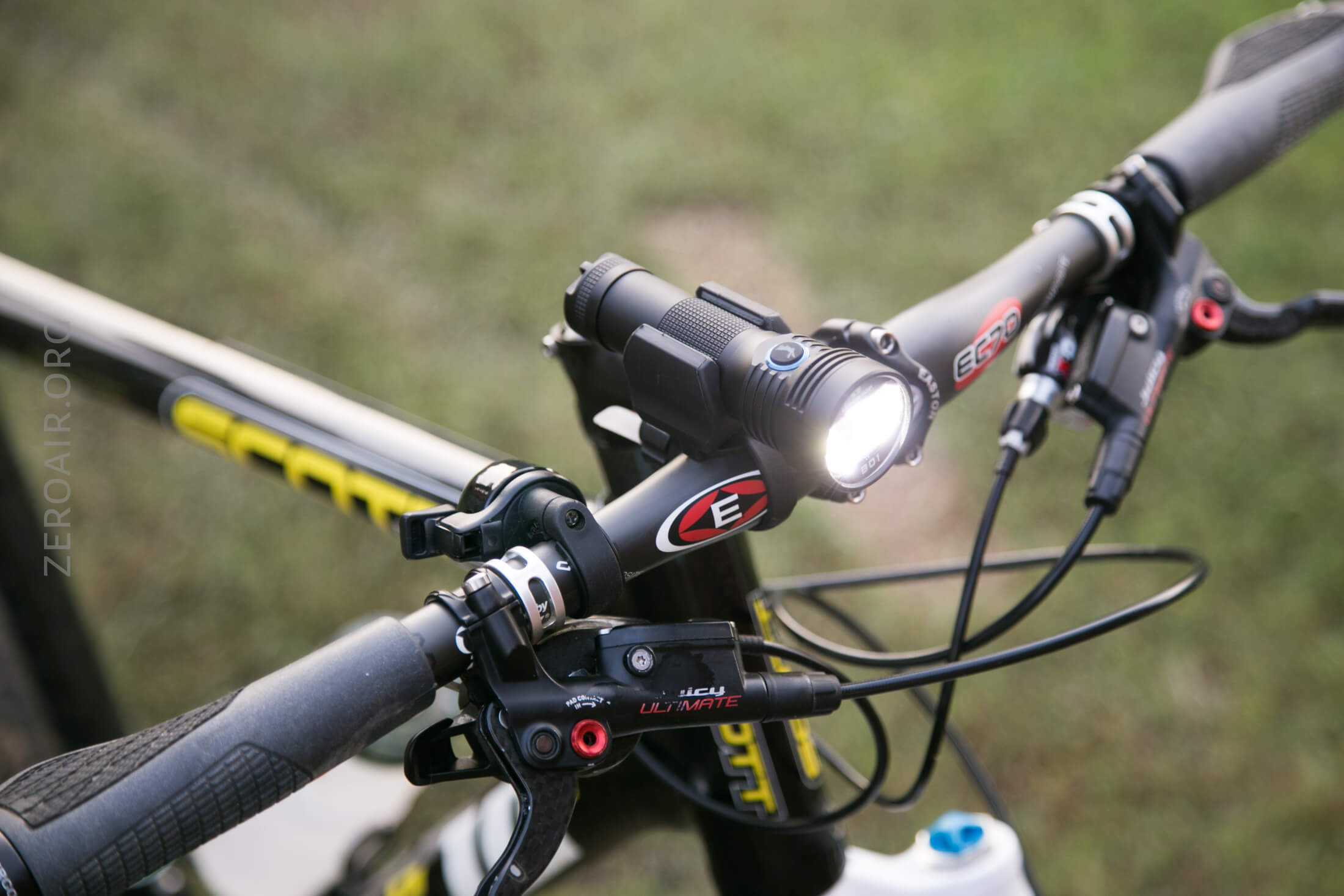

Currently testing this light:
https://www.lumintoponline.com/Lumintop-B01-850-Lumens-Rechargeable-21700-Bicycle-Light-p2093885.html
Has a pretty use-case specific reflector design that aims to be conformant to StVZO regulations. Not sure it’s received any actual evaluation along those lines, but by my subjective assessment the cutoff on it is very sharp. Theres’ a flat-topped hot spot way out in front with a gradient down to a null area and a second hot spot with a crescent shaped beam right in front of the tire. Not sure if anyone here cares about tint, but flashlight nerds definitely do, I’d estimate this one around 3500k, definitely warmish.
Comes with a 2.6AH protected 18650 (9.6Wh) for an expected runtime of 150 minutes at 450 lumens. There’s a turbo mode for 850 lumens, but that’ll get thermally regulated down to 450 after about 30 seconds. Dude here does an extensive review inclusive of testing the output and runtime which are on spec:
I threw an unprotected Samsung 50E 5AH (18.5Wh) in mine and would expect about 5 hours of runtime. The light has a low voltage cutoff at 3V and will freak out if driven beyond that, so I’m not really worried about using an unprotected cell. The onboard charger is incapable of exceeding the current capacity of this particular cell, so I’m not worried about that either.
Quality is reflective of the price and the fact that this originates from a very well-regarded Chinese flashlight manufacturer who targets the flashlight nerd community. Basically, pretty good. Machining is good, anodizing is good, the reflector does the job really well, but it’s not a fancy light by any stretch.
Only complaint is that the 21700 rattles in the case, which I’ll need to fix. I suspect the 18650 in a little plastic sleeve that comes with it doesn’t have this problem. Comes with a really nice handlebar mount, though I’m using it in a gopro style mount on the bottom side of my K-edge computer mount.
Definitely not bad for forty bucks.
