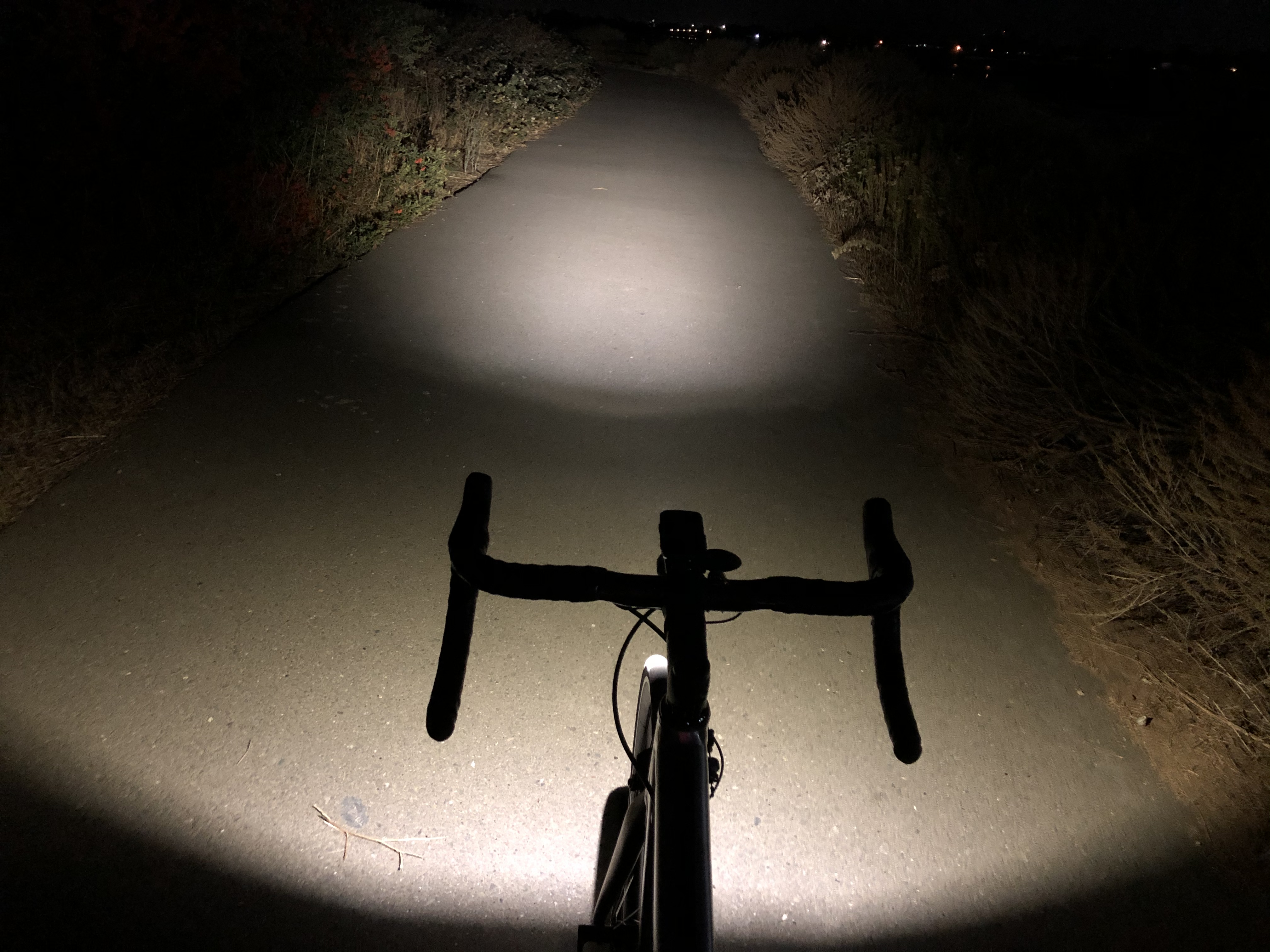

Beam shot if the Lumintop B01 in action on a MUP. One can clearly see the two hot spots. The far hot spot has about the same intensity top to bottom on a flat surface such that when it’s projected it’s brighter closer to the rider. It’s still out a ways so it doesn’t spoil one’s night vision, but isn’t brighter further out and less so closer, which the B&M folks seem to be aiming for. Don’t have one yet to compare, but will at some point.
This light is great for road users that don’t want to blind others. As I passed joggers, it barely illuminated their faces. It also had a sharp cutoff on the edges such that it doesn’t do a great job illuminating 90 degree corners on a MUP taken at speed. Likely nobody would ever see a turn so sharp on a road. Not for trails though.
I want more bike lights to include a beam pattern shot or two as part of their product info

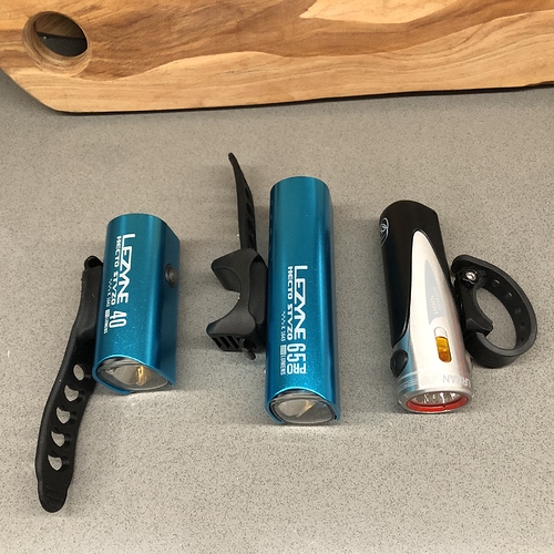

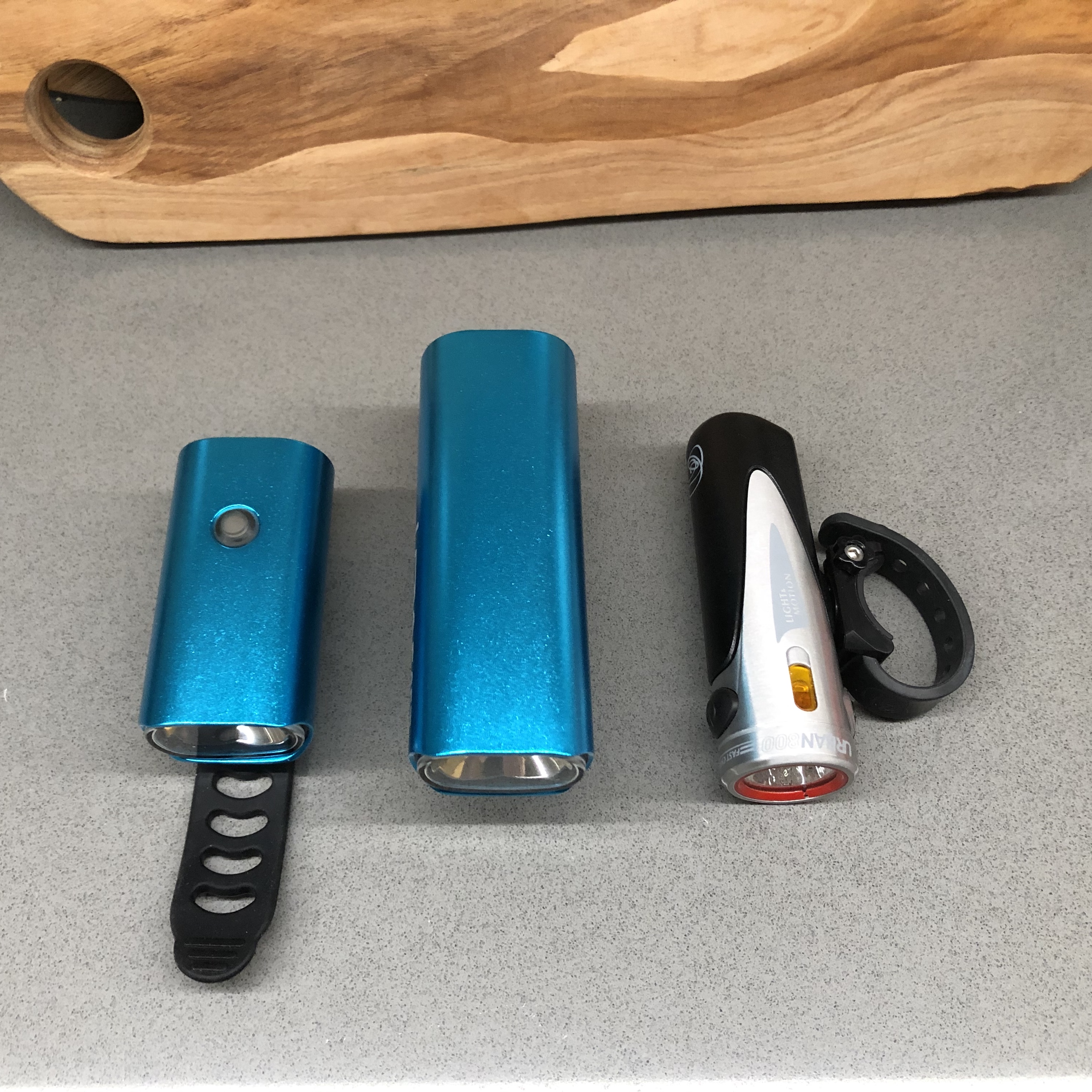

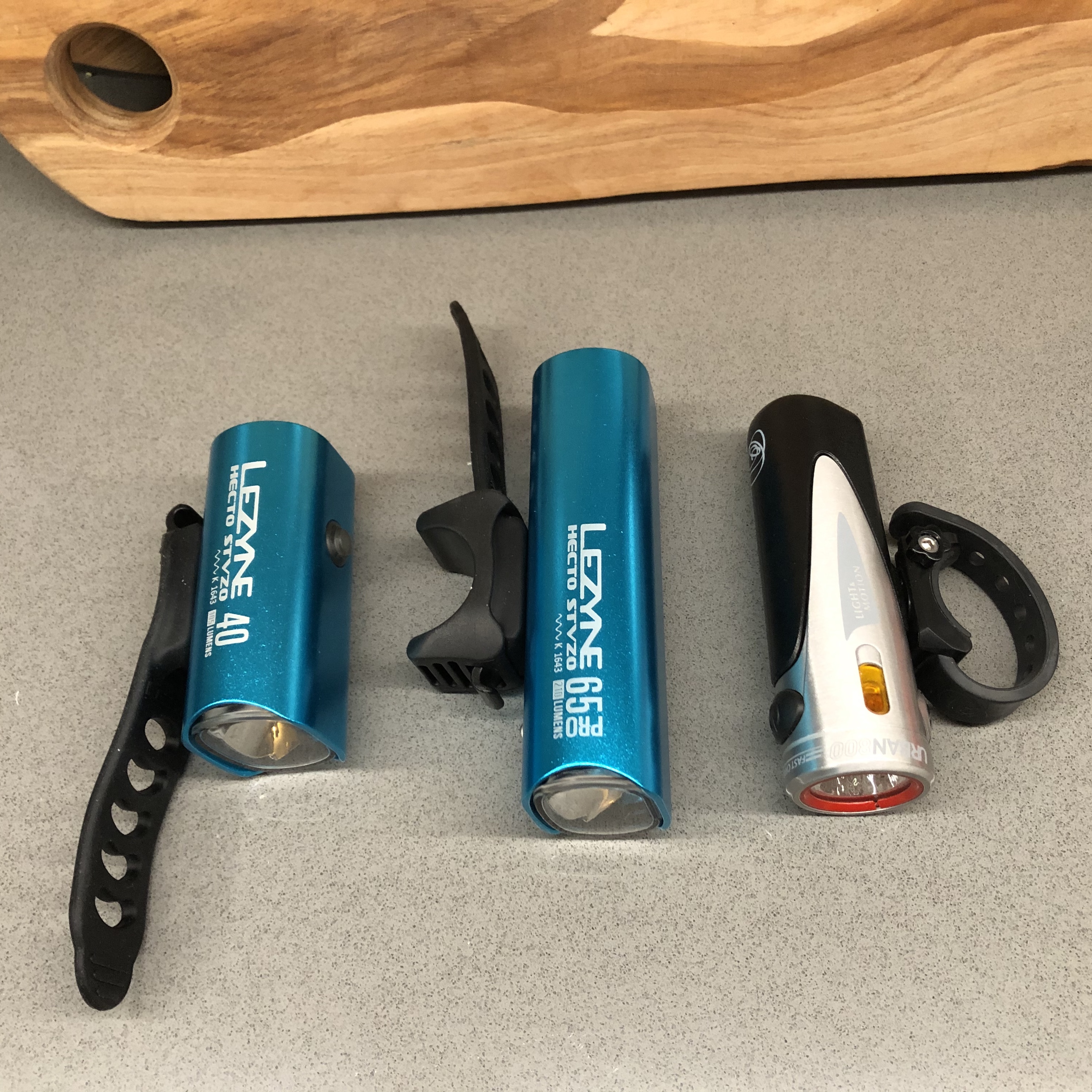

Euro lights showed up today. Beam on the smallboi is kinda narrow far out based on a 20 second test ride, will test more this weekend. L&M Urban 800 for scale.
I got two of the 65/rear light combos, will report with my findings as well.
