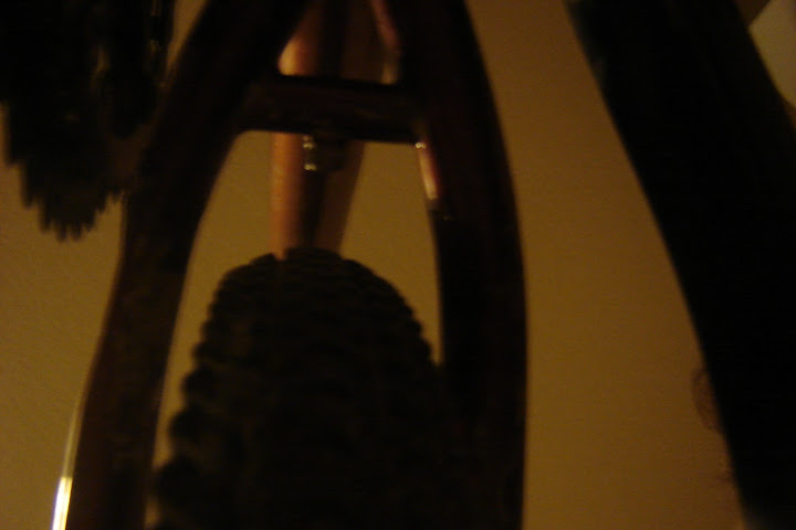

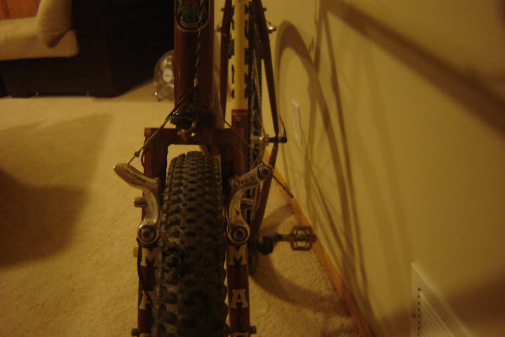

Anyone got a confirmation on max size for Soma Doublecross?
Looks like lots of room to spare with that cross tire already installed.
front is 60mm wide, rear is 46-7mm. measurements might look off in the pics cuz of camera angle.
i’ll get measurements, but that’s with a 40mm knobby tire
40mm knobbies eh? Wow, looks like a 45 should fit comfy in the rear… may be pushing it in the front though.
Thanks by the way.
