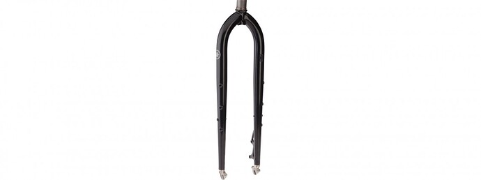

So I think the first thing I need to figure out is front end geometry so I can pick out a fork. I like the Kona P2 forks, the Sutra LTD fork has one set of mid leg zits but I cant find a clear answer on its tire clearance. https://konaparts.com/product/700c-touring-fork-cromoly-100x9/ The Salsa CroMoto is another option, I believe both are in the 45-50mm offset range.

Yea, basket with tool kit, some clothes, a lock, and lunch usually. Sometimes like 30lbs of tools or whatever, but usually not that much. And with risers I’m not too concerned with wheel flop as its not been that big of an issue with previous basket bikes. But, if I can bake in some more front-load-ability I will. We’re thinking a 71-72deg HTA with the highest offset fork I can find, which so far is only 50mm. If I can find something with curved legs I could always ruin it by curving them more.

Black mountain monster cross disc fork?

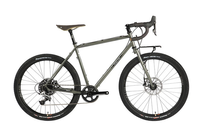

MCD with the segmented crown is out of stock and it doesn’t list clearance. Has 55mm offset though which is nice.
Road+ has one in stock but also doesn’t list clearance. Road+ frame is listed as clearing 650x42 and max 160 rotor do that’s going to be a no from me dawg.

You’d have to check the frame set. Probably won’t clear your desired mtb tire size though. Road+ is for 650b, so no.
The MCD frame is listed as 50mm measured tire width max. Pokes probably clear more, but he’d have to ask to be sure.

Oh well, Q has the Salsa CroMoto in modern-through-axle-way in stock, but tapered. So I’m probably gonna do that and have a pair of zits added.
Probably should also mention that Walt didn’t really hold to his own price list at the end on my fork. He didn’t charge any extra for thru-axle mounts, or for the extra zits (10 total). It should have been another $45 or so. He also didn’t budge when I told him I expected to pay more. YMMV
