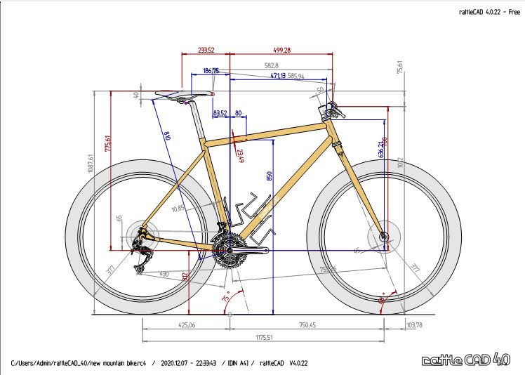

Time to fiddle with rattlecad some more.

I’ll see if I can whip something up in BikeCad next day or so. Fork you’re looking at is the Salsa one?
- 468mm axle-to-crown
- 45mm rake
That’s the one. I’m playing around in rattlecad right now. From what I can gather trail numbers effect big knobby tires differently than smaller slicks but I’m not sure in what way. It seems like I want a 71-73 deg head angle which should get me 80-66mm trail. Also not too worried about higher trail with big bars. 71.5 deg should come out to 76mm, which I can drop into the low 70s with a smaller tire.

OK, so. Starting anew.
This bike doesn’t need to concern itself with front loading. This’ll be for light trail riding, we have a good 2 hour loop of tame trails and fire road climbs that are possible on a cross bike, but more fun with bigger tires. What I need is a karate monkey with nice tubes, plain boost through axle dropouts, and far fewer zits. It’ll take a regular through axle rigid fork too, that salsa thing probably.
Old bike was too Homer car, new bike is just bike for riding on dirt.
Your geometry is large Unit X almost to the mm?
Very very close. That’s a quick sketch with some of the wrong specs as far as tube lengths but HTA STA, and reach are bang on but with a higher stack and lower bb.
