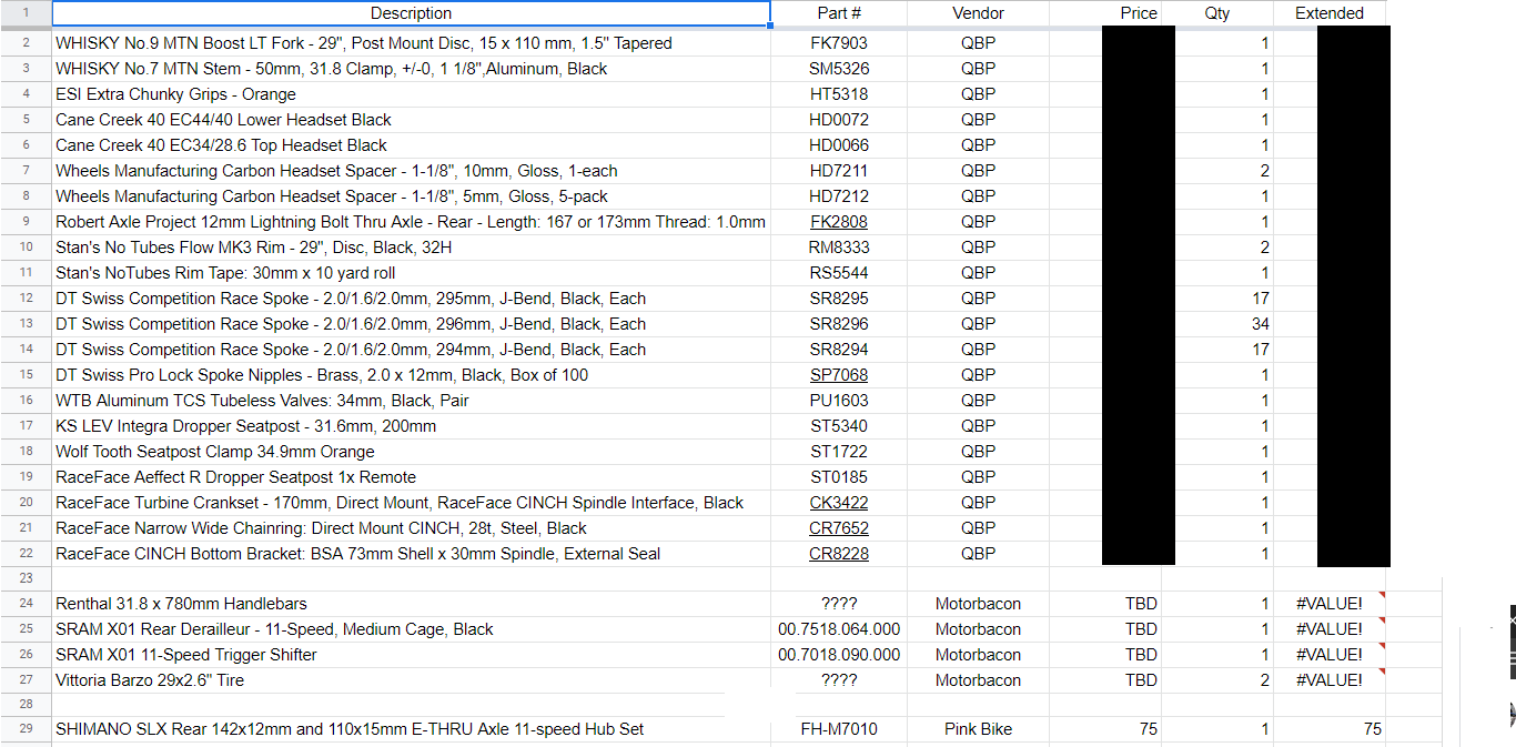

So I’ve pretty much figured out what my ideal spec is for this bike, already ordered a bunch of parts even though the frame is just a pile of tubes. Here’s the start of a spreadsheet keeping track of every part because I have nothing but time on my hands to do mindless work right now. I’ve redacted my pricing for lots of things for obvious reasons. The stem and bars are just a placeholder until I get it rolling for real. All tires eventually wear out so I’m not too concerned with tire choice right now.
I still think I’m going to roll the dice on those Magura MT Trail Sport brakes unless anyone has any first hand poor experience with them. 180mm Magura rotors F/R. If I don’t like them, I can always sell them on pinkbike or ebay or whatever for close to what I paid. For the drivetrain the parts bin sram 11s to keep the initial build cost down and the 12s Shimano kit I want isn’t available yet. Going with an 11-42 XT or SLX cassette when they’re available with matching chain.
SLX 11s hub won’t be able to handle 12s microspline down the line. DT 350 for future proof, or rebuild wheel later.
I really wish there was an 11s microspline cassette.
Oh, for sure. Future plans are for fancy hubs laced to carbon hoops when the Shimano 12s train comes to town. The SLX/Stan’s are just the best bang for the buck I could put together right now.

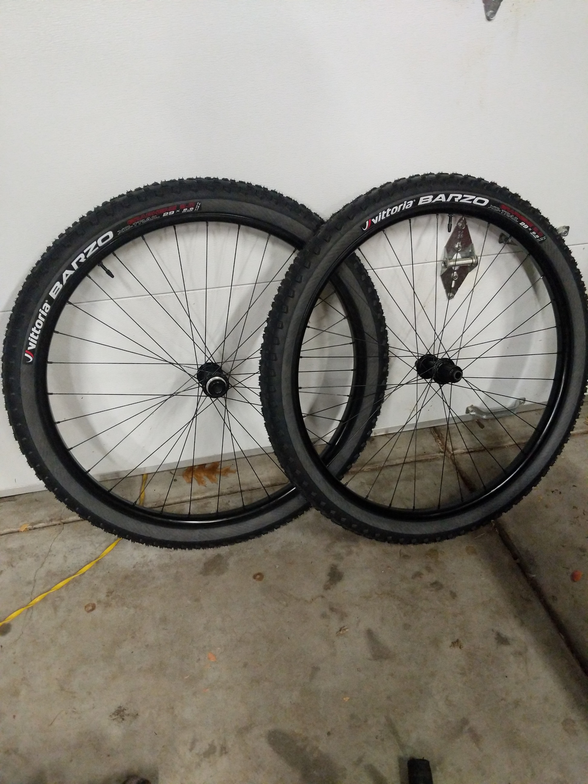

I’m pretty stoked on these wheels. Flow MK3 laced to 7010 SLX Boost hubs with DT Competition Race Spokes and DT Pro Lock nipples.
These spokes are just a tiny bit bendier than standard comps and that’s super helpful getting those last ones around without nicking the rim. The hoops, are not bad but also are just a little disappointing in the sidewall straightness department. They more than make up for it by fitting these tires so perfectly. The tires measure in at 2.4" on i29mm rims but have a nice profile with the corner knobs right at the edge.

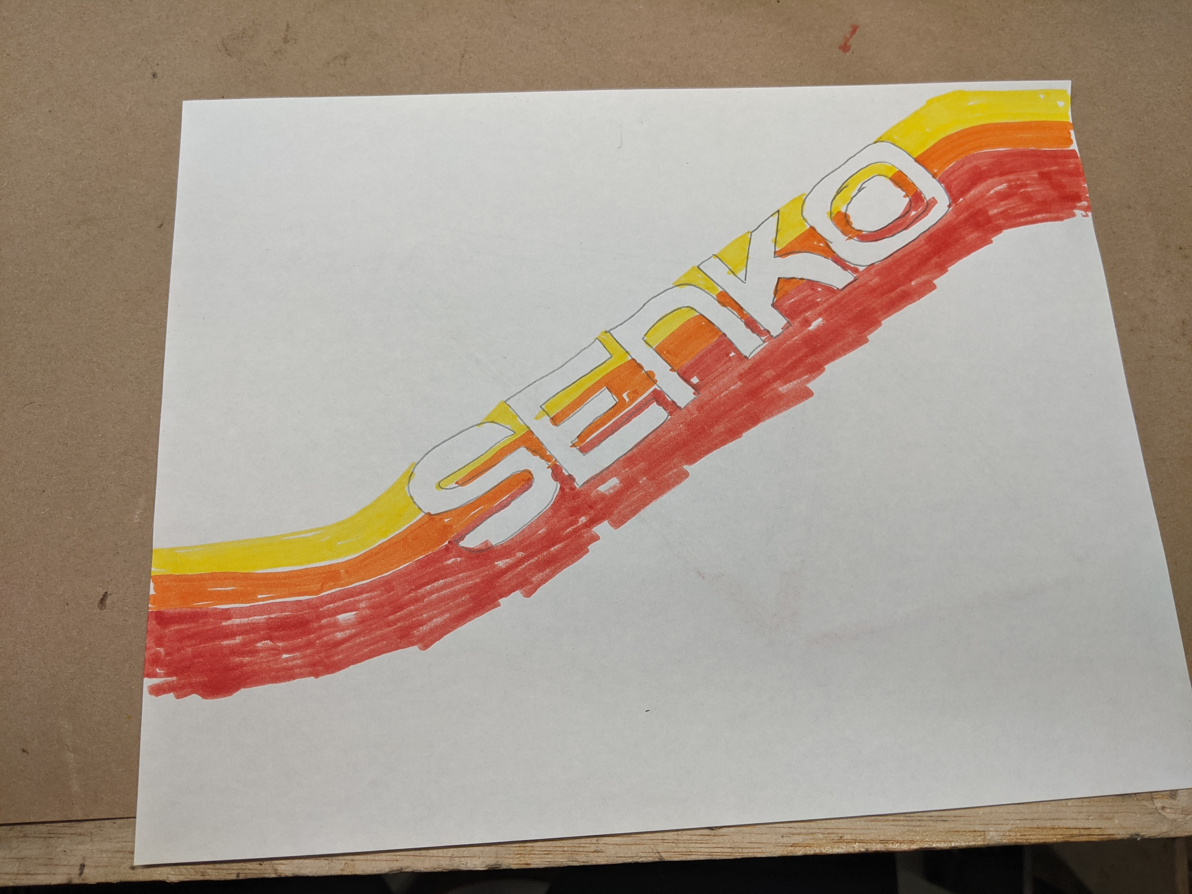

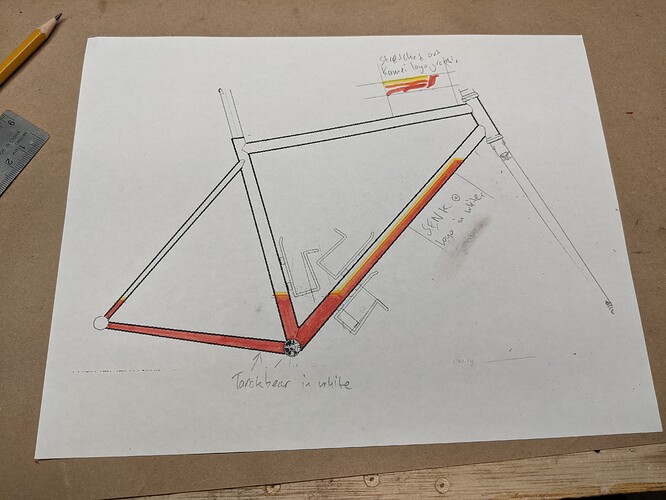

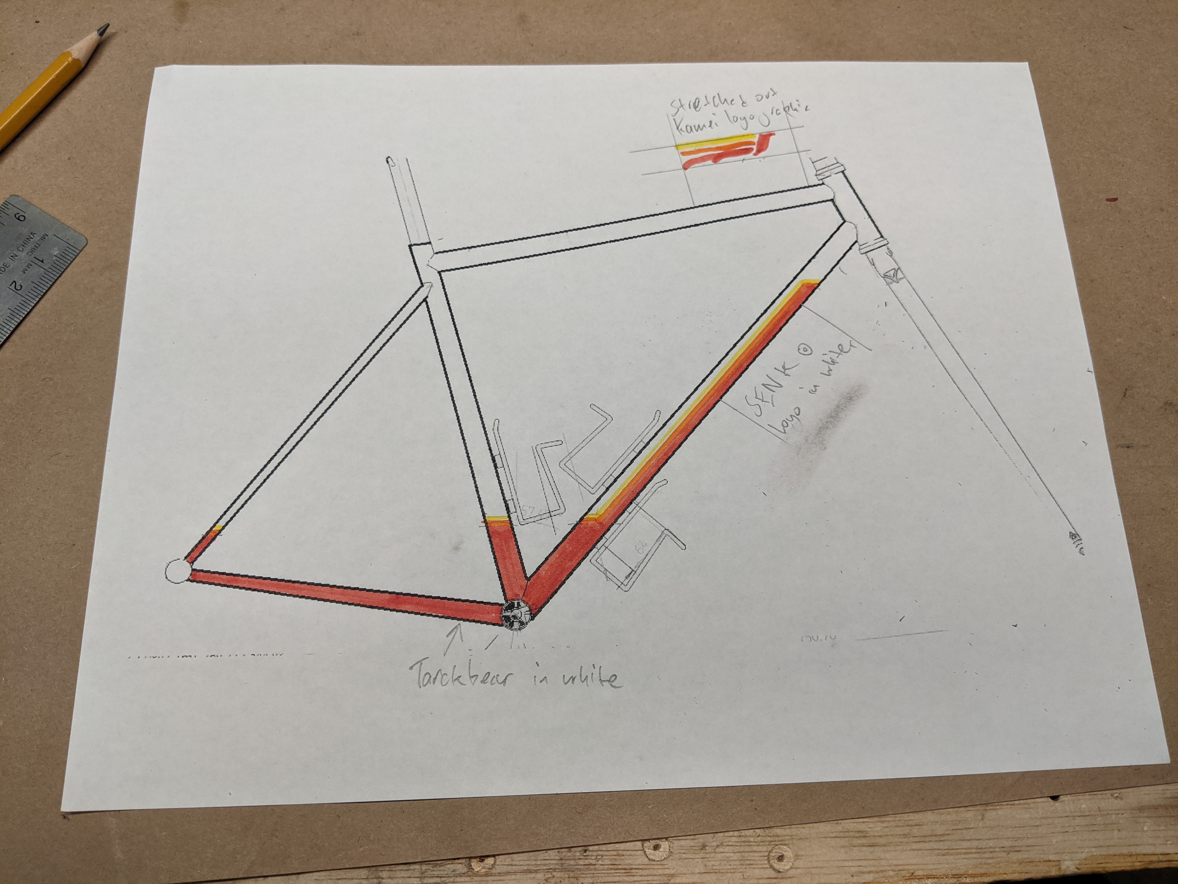

OK, I finally put pen to paper so I could show ya’ll kinda what I’ve been seeing in my head.
0002034_kamei-decals-stickers-set_550
There’s about a 47 degree bend at the top and the bottom of the stripes. I need to figure out that angle exactly because I want the horizontal section of the stripes to be horizontal to the ground. The yellow and orange stripes will be 12mm tall and the curve at the top and the bottom will have a 19mm radius. I want it to say SENKO in negative space so it comes out white, it will be split in thirds by the yellow, orange, and red and 150mm down from the top of the curve. Measuring along the top of the yellow curve I want the graphic to 500mm long measured from the outer ends of both curves.
The top tube graphic will be the stripes from the Kamei logo each 12mm wide and stretched out but with no gaps between the colors like the DT. I want it stretched out to be 190mm long. Also a 20mm tall Tarck Bear cutout to go on the inside of the NDS CS, positioned like the coffee grinder logo, which might already exist in a useable format in the tarck-o-sphere. Who’s holding print quality Tarck Bear graphics?
I really only need masks for the tarckbear, DT, and TT, I can do the ST and SS with tape. I plan on laying down a white base coat and masking off and spraying each of the colors individually from yellow to orange to red. I want each of the colors to run into each other with no gaps, which will be a ton of fun to apply to the frame. I need to figure out some sort of registration marks to make sure everything lines up properly. So basically each color will be it’s own layer and I’ll be weeding the cut in reverse.
