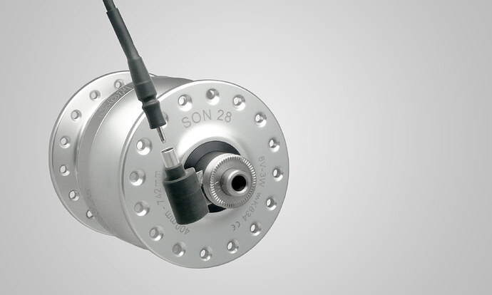

Retrofittable with “coaxial adapter”?
They sell an adapter. Looks like the primary purpose is to allow easy splitting of the current for lights and gadgets.
