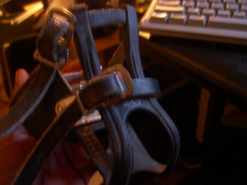

Yes. I wear a 13 as well and the Sunlite plastic clips I used were a large and fit my foot perfect.
See.

Those are the same ones I had when I first got my bike.
I tihnk they work great and have held up well. Those straps are stretched to shit though and need replacing. Won’t be for a while though I put ATAC’s on my bike and whenever I build up a beater, it’s getting the clips/straps.

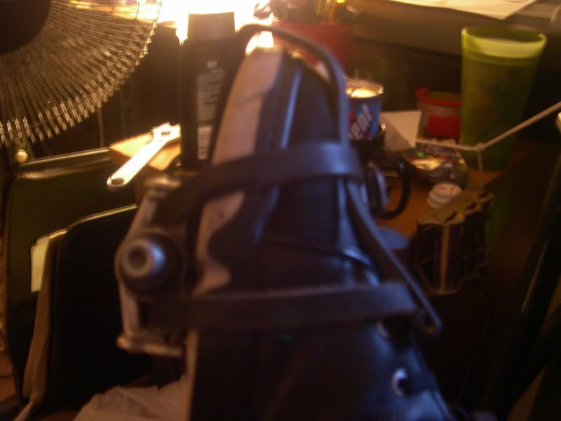

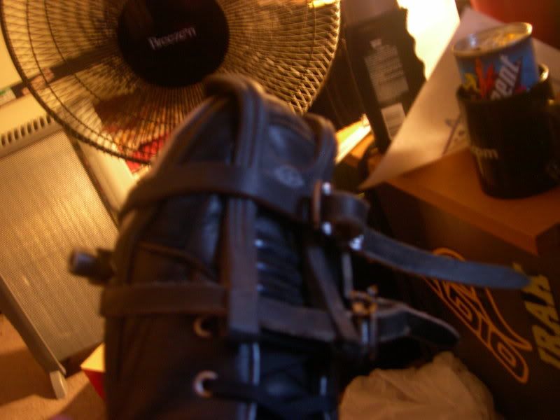

those posted…
the lower strap is so low, looks like it doesnt have much function
hold your toes down?

[quote=“JayNev”]those posted…
hold your toes down?[/quote]
Yup.
When I used singles the annoying thing was my toes would slide left/right with ease and I was always tightening for shit to get loose again rather quickly. The front/lower strap ceases this movement as well as adding some downward pressure. This isn’t the case for just my setup but for any dual strap set up from what I can tell.
The back strap does the work keeping your foot down and in the cage, the front strap does the work of keeping your foot straight. When it comes down to a time where you need to pull up for a skid/skip/bunny hop/etc the front strap takes stress off the rear one.
Going by old cycling pictures, there was a long time before double straps where thought of/used commonly. And even then, I think they’re only most useful for a track bike (MTB maybe?).
