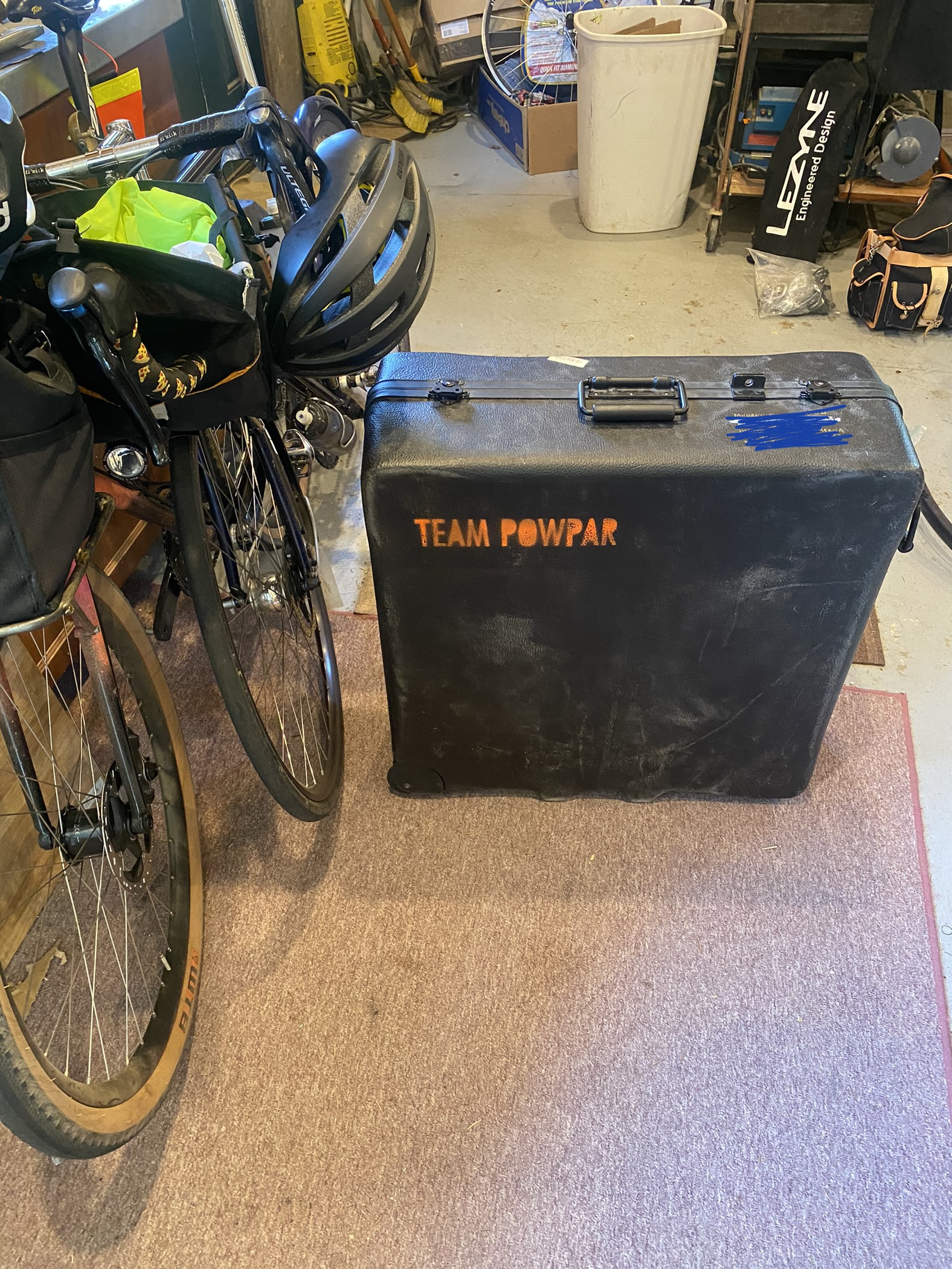

in all fairness, sometimes the thing is printed off center
1mmâer
maybe he knows your right shoulder is slightly wider
Front f/f, rear wheel, handlebars, rear frame, front wheel.

Letâs chat travel bikes
