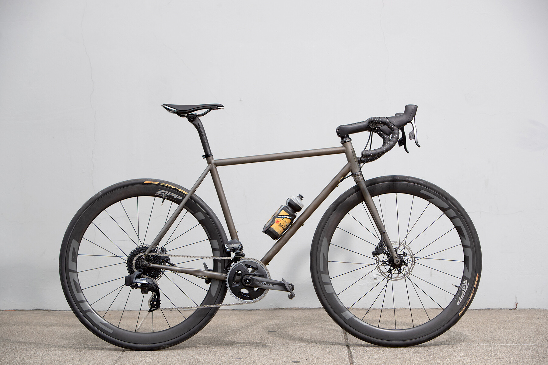

Mash all road fork states 700x35
I think for a traditional road crown like a Pacenti you’re going to be more limited by width between the legs; maybe mash made theirs wider to fit a 38
Looks to me like a Chinese/Taiwan fork
That crown looks like a Henry James knockoff.
