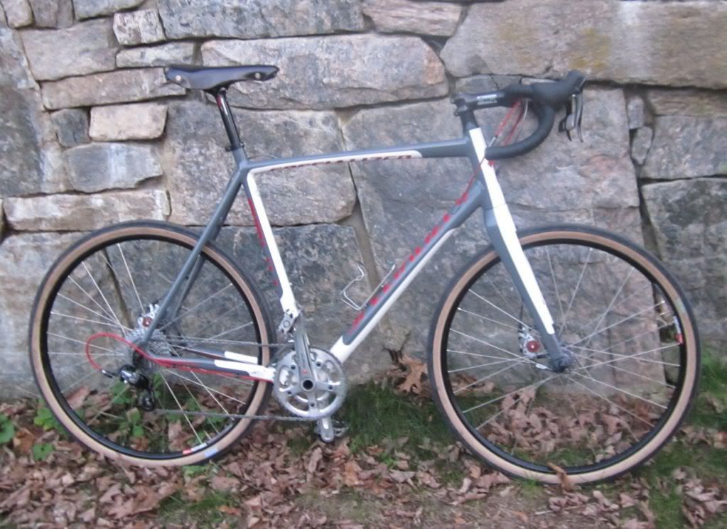

I took a recent picture of the Nishiki:
As you can see it is running bar ends and has an older Sugino XD crank with 46/30t rings combined with a 11-30 9 speed cassette. The bar ends are great, but interfere with the handlebar bag to much. I have routed bar end cable along the bars for a cleaner look on a customer bike and found the extra bends hampered shifting too much for my taste. I was planning on down tubes for simplicity sake. I have a couple vintage bikes (PX10, Volare, and the N-1 Kogswell) with downtube shifters and like them. The Nishiki has Salsa bell laps because of the price I paid for them ($6 when QBP was blowing them out). I will probably do Noodles again as I have three bikes currently running those.
What is wrong with Velocity Synergies? I have Dyads on the PX10 conversion. I can get the LX rear/dyno front to Synergy wheelset for not much more than the cost of a pair of new 650b A23 rims. I could possibly get a better deal than retail on the A23 because I do know a few people that work for Velocity.
With the 46/30 I find I am in the middle of the cassette during a big chunk of my riding. If I went to the 48 or 50 I would probably be move up and cross chaining more than I do know. The Rival crank I have is the 180mm 50/34 as I just swapped the 50 for a 48t. The Rival build is definitely under consideration.
I don’t see how the Resist Nomad tires would be better as I can’t fit them on anything but my LHT. I don’t know of a low trail bike with that kind of tire clearance for 35-45 tires and fenders. They are cheap for sure, but I don’t except an awesome ride from a 30 tpi wire bead tire.
